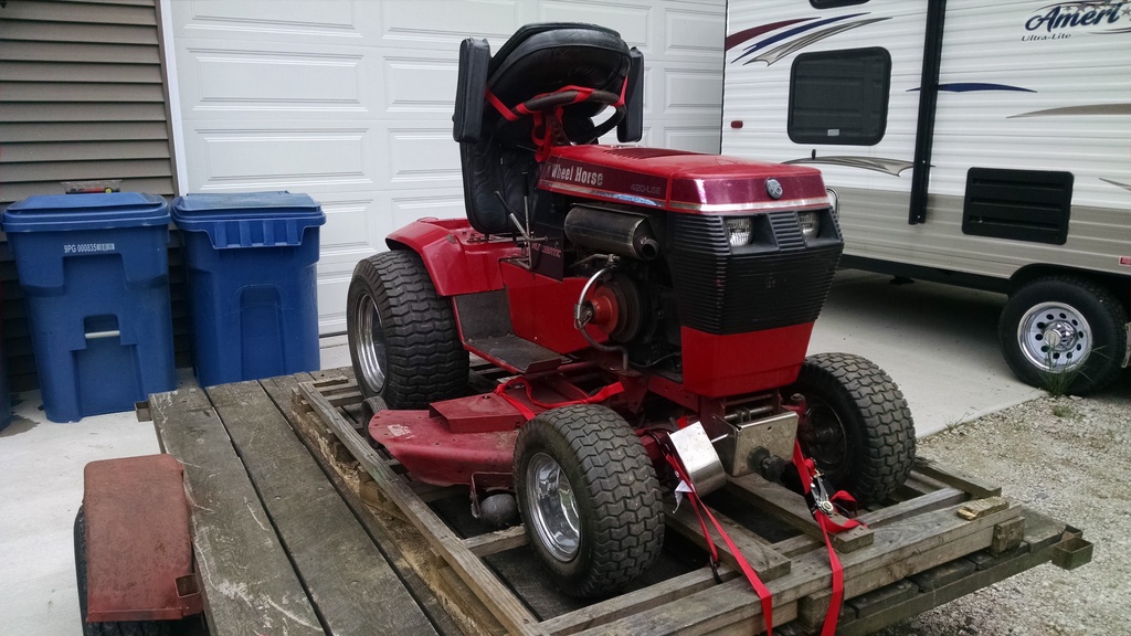

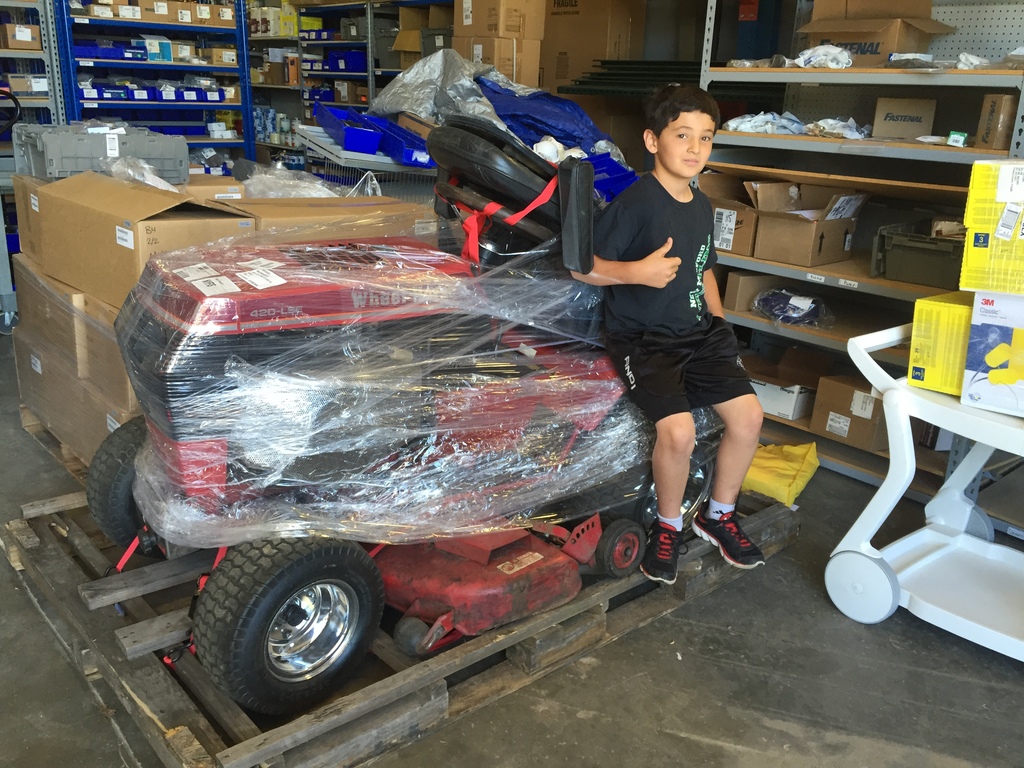

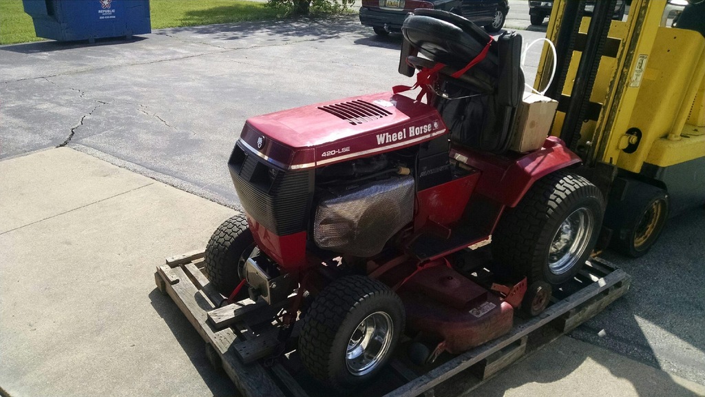

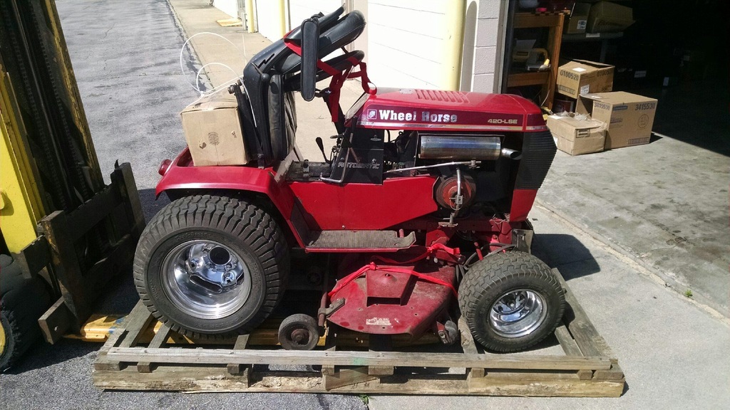

wh500special 2,388 #5 Posted April 30, 2017 I've sent several via fastenal and haven't had any complaints. I use ratchet straps and hook them into the holes on the front of the frame-to-transaxle mounting plate to hold the tractor for side-to-side stability. The other strap goes on the hitch, under the pallet, and up around the front to the front axle. I think if I had one o had to worry about not scratching on the front I'd lasso around the front tires. Then I stretch wrap the whole thing to keep prying eyes and fingers out. Block the tires of course. Steve Share this post Link to post Share on other sites
Zeek 2,299 #6 Posted April 30, 2017 All good suggestions! The tires never occurred to me for some reason . . . Thanks for the pics Steve! Share this post Link to post Share on other sites
