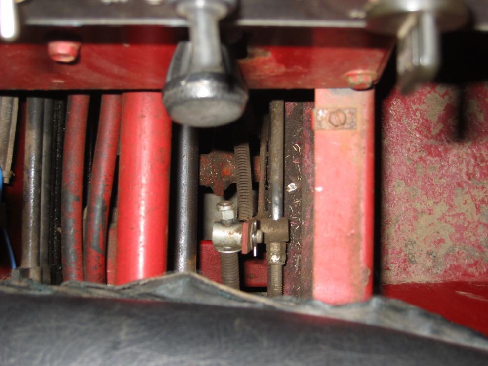

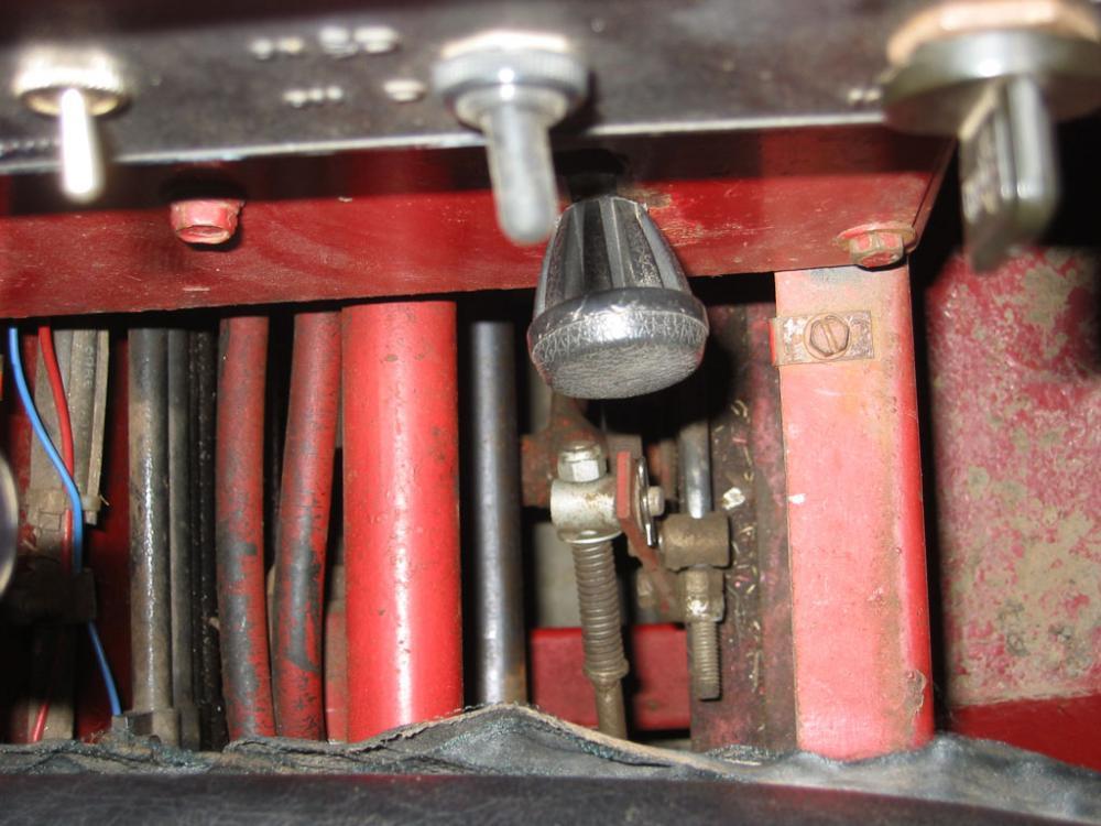

pfrederi 21,140 #2 Posted April 30, 2017 Can you roll the tractor a distance? Did you have the transaxle apart and check it? Could be a broken differential bolt jamming the bull gear. Does the midmount (or 3 pt ) lift work? What screw on the hydro motor are you talking about?? The Tow valve is on the hydro pump. Share this post Link to post Share on other sites

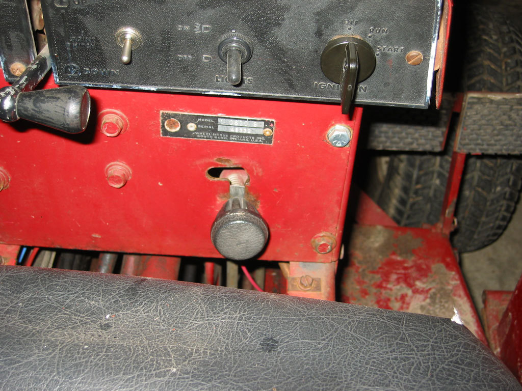

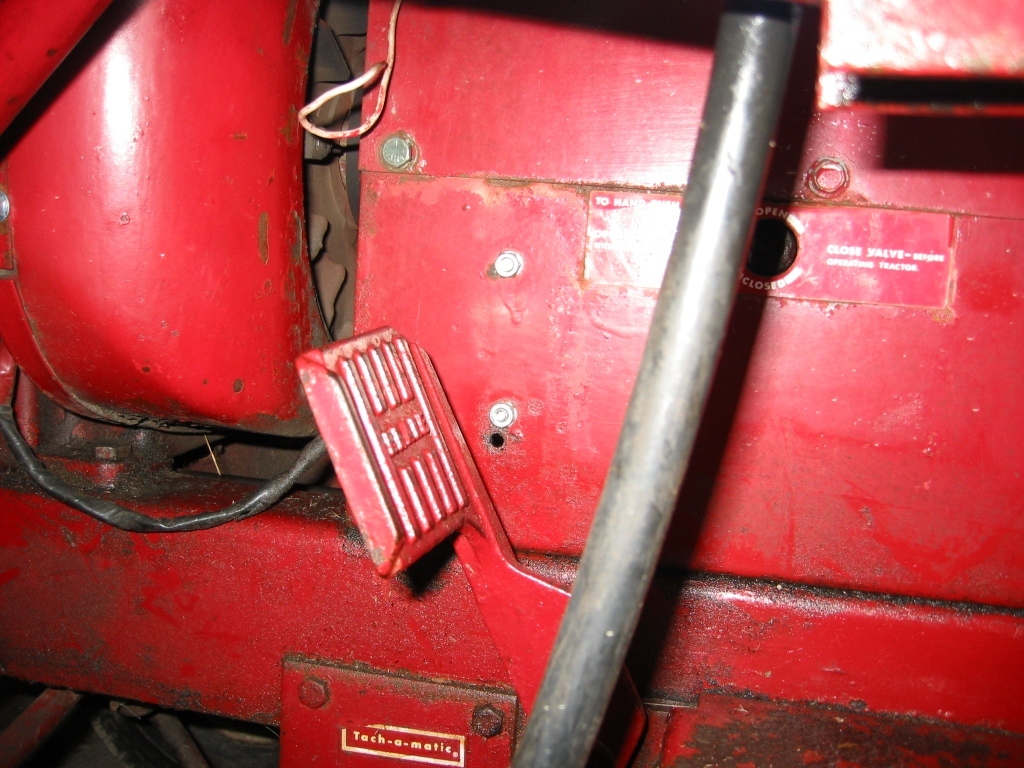

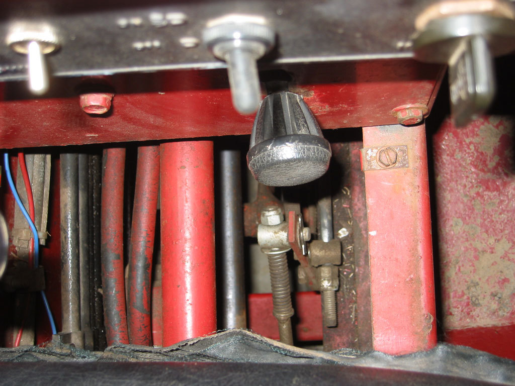

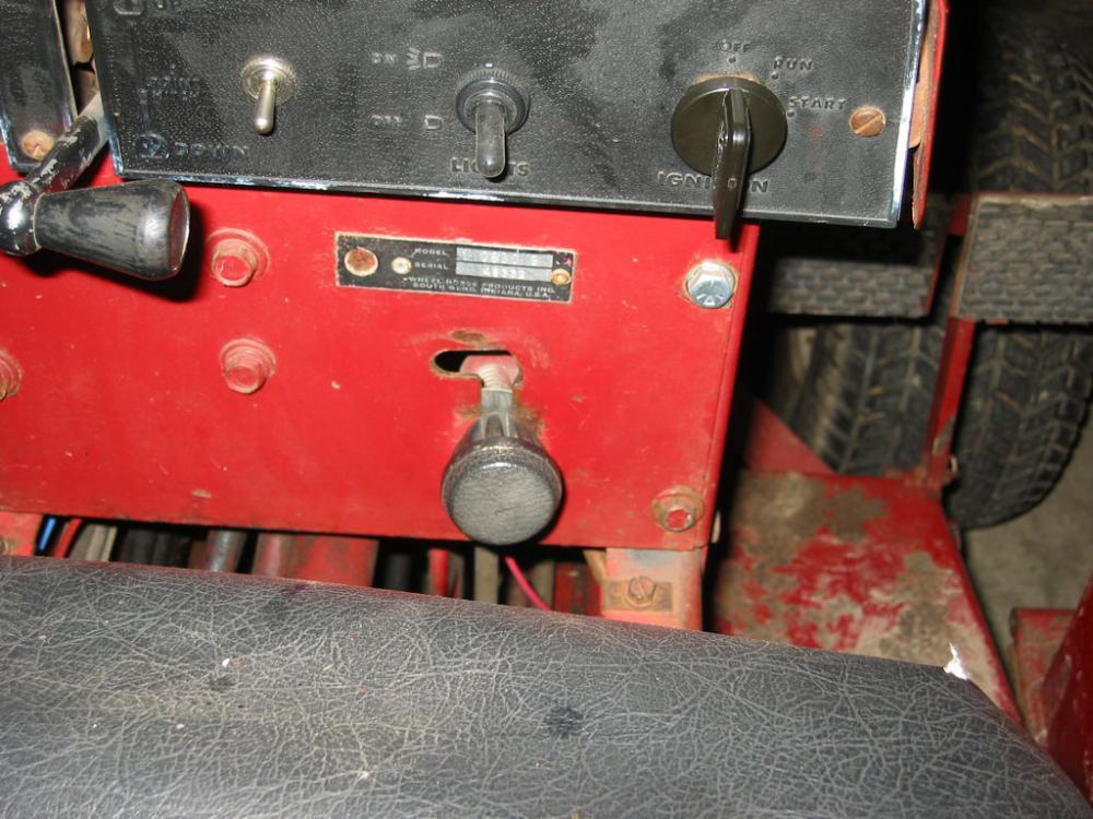

pfrederi 21,140 #4 Posted April 30, 2017 (edited) Did you open the tow valve? Do you have the later model with a band parking brake on the hydro motor or the older model with internal parking pawl? Also Where is your parking brake handle is it like this one (2-4 pic) Edited April 30, 2017 by pfrederi Share this post Link to post Share on other sites
harryt 36 #5 Posted April 30, 2017 Not sure on the parking brake handle as it was not assembled when I got it and I haven't got that far yet, but I am pretty sure it is like that one Share this post Link to post Share on other sites

harryt 36 #8 Posted April 30, 2017 This was it when it was altogether when the previous owner had it but he took it apart. Looks like it has the same parking break you are talking about? What bolt could be broken? Share this post Link to post Share on other sites

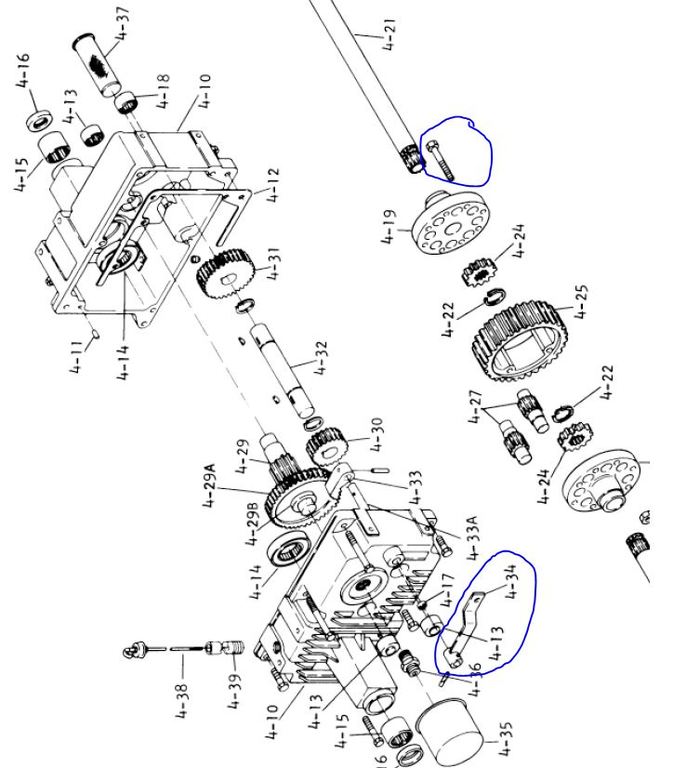

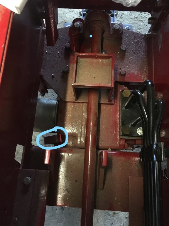

pfrederi 21,140 #10 Posted April 30, 2017 The tow valve is in the black hole about in the middle of the picture. it must be loosened about a turn to allow you to push the tractor. Your parking brake control is like the one in the pictures I posted. The possible broken bolt is in the transaxle differential. With both rear wheels up i the air try turning one of them what happens? does the other wheel turn the opposite direction??? Look at this parts manual Check the lever 4-34 does it move when you move the parking brake handle?? The broken bolt would be one of 4 like I circled. 1 Share this post Link to post Share on other sites
harryt 36 #11 Posted April 30, 2017 When I jack it up, one wheels turns one way and the other wheel in the opposite direction. It is not fully assembled but I would of thought it would still turn? Share this post Link to post Share on other sites

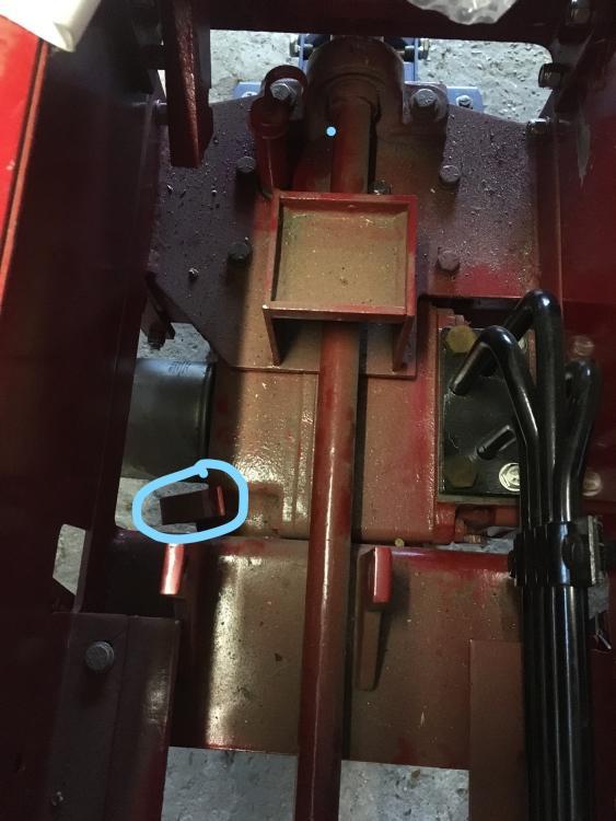

pfrederi 21,140 #12 Posted April 30, 2017 From the pictures I assume you have no fluid in the system. That eliminates the tow valve as an issue. Can you move the parking pawl lever? (Blue Circle) Then try turning the wheels again Share this post Link to post Share on other sites
harryt 36 #13 Posted April 30, 2017 I have put fluid in the transmission but obviously it is not primed. Yes I can move that lever Share this post Link to post Share on other sites
pfrederi 21,140 #14 Posted April 30, 2017 try spinning both wheels same direction with the lever moved all the way forward....then try with it all the way back Share this post Link to post Share on other sites

pfrederi 21,140 #16 Posted April 30, 2017 Can you move both rear wheels backward at the same time?? Do you think the parking pawl is moving with the lever?? If you try spinning the wheels while you move the lever is there and grating/gear clash noise? Share this post Link to post Share on other sites

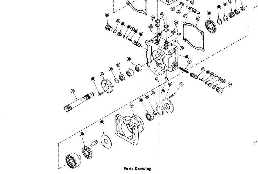

pfrederi 21,140 #18 Posted April 30, 2017 If it isn't the parking brake the it is either a gear issue in the transaxle (jammed by a broken bolt etc.) or something amiss with the hydro motor itself. I hate to say but you may have to pull the hydro motor and see if the wheel spinning issue resolves. You will also be able to see the parking pawl with the hydro motor off. If it still will not roll with the hydro motor off I am afraid you will have to split the transaxle case to locate the problem sorry 2 minutes ago, ericj said: these tractor have an OPEN rear not a posi, so one wheel will turn the opposite direction of the other eric j He can't spin them in the same direction at the same time and it won't roll with both wheels on the ground Share this post Link to post Share on other sites

pfrederi 21,140 #24 Posted April 30, 2017 (edited) To be sure, the hydro pump has the tow valve and it is the part connected to the engine, that valve need to be loosened at least a turn . The hydro motor goes in the side of the transaxle. Did the gear shaft on that turn fairly easily before you put it back in the transaxle? To prevent the rear wheels from turning in the same direction at the same time either the hydro motor is building up pressure (which since the system isn't filled and the manifold lines to the pump are not filled building pressure would seem to be impossible) or something in the hydro motor is broken and or jammed. The other possibility is something in the transaxle itself like a broken bolt or the parking pawl is stuck. Edited April 30, 2017 by pfrederi Share this post Link to post Share on other sites
