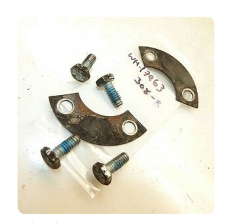

Red Devil 5 #1 Posted April 30, 2017 (edited) Anyone know what the part number or size is for the four screws that attach the PTO ceramic pad plate to the outside of the drive belt pulley that the PTO presses against to engage? Edited April 30, 2017 by Red Devil Share this post Link to post Share on other sites
gwest_ca-(File Mod) 12,149 #2 Posted April 30, 2017 1/4"-20x5/8" hex head cap screw Garry 1 Share this post Link to post Share on other sites
WHX?? 56,049 #3 Posted April 30, 2017 All of mine are the flange type with the serrated locking flange 2 Share this post Link to post Share on other sites
Red Devil 5 #4 Posted April 30, 2017 I'm thinking this is them but I wasn't sure size 1 Share this post Link to post Share on other sites
pfrederi 20,257 #5 Posted April 30, 2017 Yes the blue stuff is Eslock WH used a lot of Eslock fasteners. Similar to Loctite. 2 Share this post Link to post Share on other sites
elcamino/wheelhorse 9,363 #6 Posted April 30, 2017 Some early models ( my 1972 Commando 800 ) 1/4 x 20 x 1/2" bolts . 1 Share this post Link to post Share on other sites
