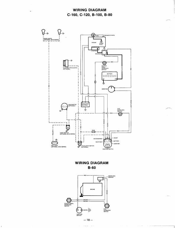

sqrlgtr 3,997 #1 Posted April 29, 2017 Hello all, I purchased a c-160 the other day over all good machine but drove it around the barn this morning and noticed yhe amp meter is showing a discharge.the tractor starts and runs great but this is a new battery.just wondering if someone could point me in the right direction as to where to start on this problem. Thanks Share this post Link to post Share on other sites
pfrederi 21,175 #2 Posted April 29, 2017 Check voltage with engine off. a good battery should be about 12.6v. With engine running voltage should be 13.6 to 14,5 if not Make sure that the regulator terminals are clean and tight. also clean the bolts holding the regulator to the tractor. The case must be well grounded. Still not joy the refer to the electrical section of the manual to test the charging stator and regulator 1 Share this post Link to post Share on other sites
rmaynard 17,585 #3 Posted April 29, 2017 (edited) I am assuming that the ammeter reads zero (in the middle) when the tractor is not running. Do what Paul suggested first. Then, if the ammeter is still reading in the negative zone constantly when running, try removing the wires from the back of the ammeter, clean the connections, and try again. All of the tractor's 12 volts, with the exception of the starter, run through the meter. Without having the headlights turned on, the only thing that draws current is the ignition coil. A new ammeter is inexpensive, and might solve your problem. Edited April 29, 2017 by rmaynard 4 Share this post Link to post Share on other sites
squonk 48,156 #4 Posted April 29, 2017 I have seen those ammeter leads get crappy and melt causing all sorts of issues. Share this post Link to post Share on other sites
sqrlgtr 3,997 #5 Posted April 29, 2017 Appreciate the response's fellers probably be monday before i get back to it.gauge reads 0 when not running then shows negative on gauge when running.turn lights on and it shows even more to the negative side.maybe i can run it down without to much trouble just trying to get everything working before i tare it down for restoration.you know how it is. Share this post Link to post Share on other sites
953 nut 69,551 #6 Posted April 29, 2017 If you have an electric PTO be sure it is turned off, they draw about ten amps. Share this post Link to post Share on other sites
Rob R 989 #7 Posted April 29, 2017 I had a similar issue with a C-81 here's what solved the problem..... when the PO painted the tractor he painted the area behind he regulator.... what I find amazing is that basically this tractor has NOT be charging for at least 5 years simply because the regulator - rectifier was NOT ground properly . To test the unit I didn't even bolt back together just held the unit to the cleaned surface with the tractor running and the AMP gauge jumped immediately. So my new little C-81 is 100% starting, running and charging like a champ...... 1 Share this post Link to post Share on other sites
sqrlgtr 3,997 #8 Posted May 3, 2017 When through all checks in manual and stator is showing good.cleaned and checked all connections even took rectifier off and cleaned behond it to make sure it is grounded good.so ive narrowed it down to rectifier being bad.so one more ??? where could i get rectifier, prefer it would be from site sponsor if at all possible... Share this post Link to post Share on other sites
rmaynard 17,585 #9 Posted May 3, 2017 New, try http://www.milfordpower.com/R10297-Voltage-Regulator-Replaces-Kohler-41-403-06-p/r10297.htm Used try eBay. Share this post Link to post Share on other sites
sqrlgtr 3,997 #10 Posted May 3, 2017 Yhanks RM for the link.checked with toro dealer today and he gave me a part # of 101450 not in stock but could get it now for the best part $155..have you used the part in the link you sent me and if so was it just plug and play(mount in same location and plugged right up)... Thanks Share this post Link to post Share on other sites
sqrlgtr 3,997 #11 Posted June 18, 2017 Sorry guys about late follow up on this post but try not to leave a thread hanging without letting everyone know what happened.got charging problem fixed.turned out to be bad amp meter.i had never had one go bad that would read a charge or discharge in this case that wasnt good.oh well alls well that ends well.thanks for everyones help. 5 Share this post Link to post Share on other sites
