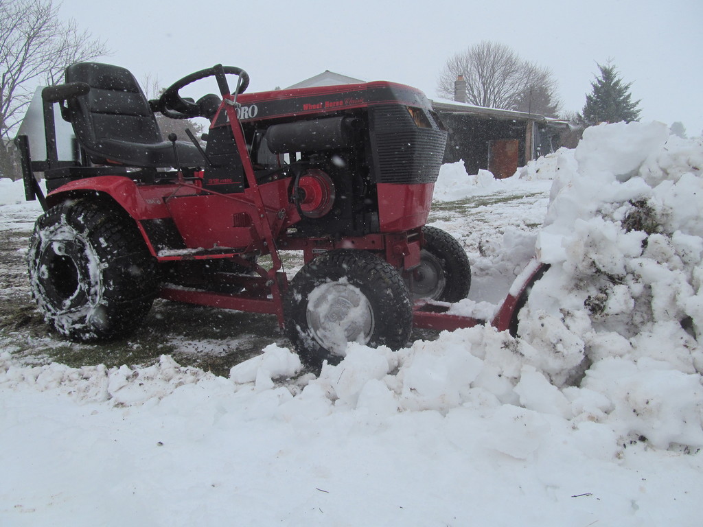

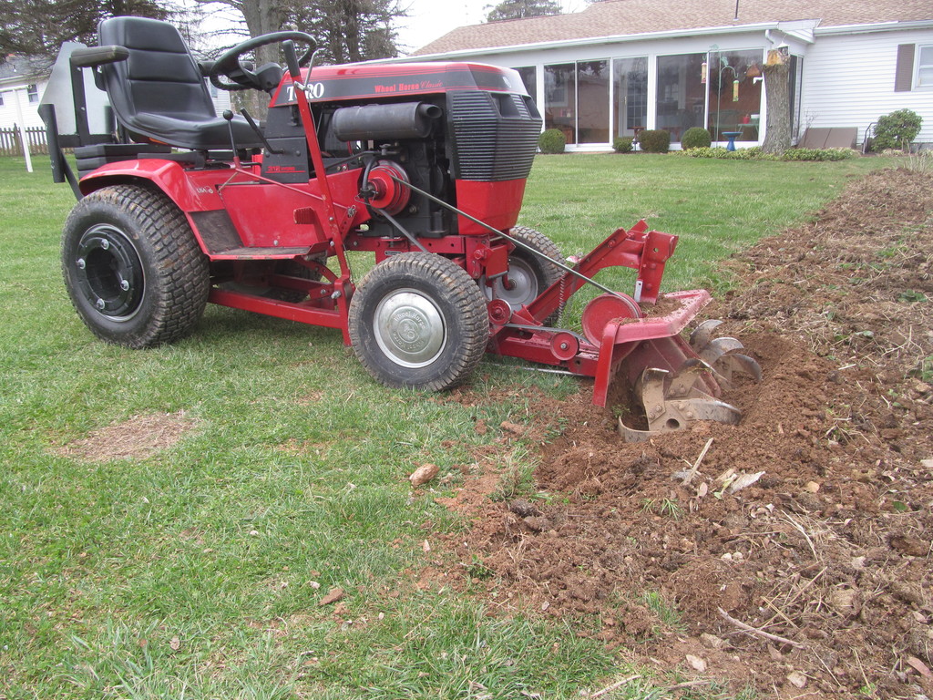

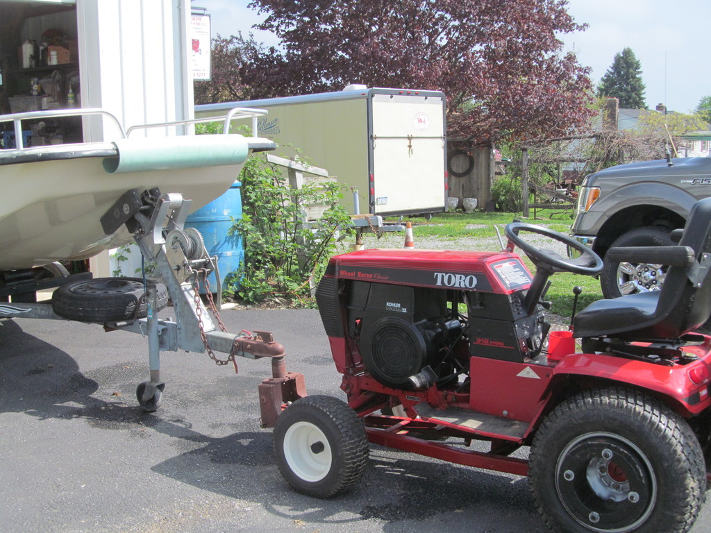

Ed Kennell 47,619 #1 Posted April 28, 2017 I have found 3 uses for the 312H and it's plow frame. WINTER Standard 48" snow blade SPRING Tiller Time SUMMER Trailer mover About 5 minutes to make the blade to ball hitch change. Both use the standard two pins from the blade. The tiller takes about 15 minutes. It uses the front blade pin and two bolts connecting the braces to the frame. Of course the PTO hoop must be opened to install the belt. Due to the arthritis in my neck, I only have about + - 10 degrees movement, so I am not able to look back. This is probably a good thing, and it may be the reason I like all my implements in front. It is much easier to wiggle a trailer into a tight space with the hitch on the front. And there is no danger of doing a back flip that can happen when pulling a heavy trailer with a rear hitch... ..don't ask. 18 Share this post Link to post Share on other sites
Thisguyisnew 114 #2 Posted April 28, 2017 Where does one find a tiller like the one pictured? 2 Share this post Link to post Share on other sites
DennisThornton 4,773 #3 Posted April 28, 2017 4 hours ago, Thisguyisnew said: Where does one find a tiller like the one pictured? You found it. "it". One and only. 3 Share this post Link to post Share on other sites
Amcwheel85 2,060 #4 Posted April 28, 2017 ed still needs to build me one! Lol 1 Share this post Link to post Share on other sites
classicdmax 190 #5 Posted April 29, 2017 (edited) I like the ball hitch! whats the lift capabilities you think? I'm sure theres not all that much tongue weight to a small whaler but like the concept Edited April 29, 2017 by classicdmax Share this post Link to post Share on other sites
Thisguyisnew 114 #6 Posted April 29, 2017 Both are very cool Share this post Link to post Share on other sites
Ed Kennell 47,619 #7 Posted April 29, 2017 1 hour ago, classicdmax said: I like the ball hitch! whats the lift capabilities you think? I'm sure theres not all that much tongue weight to a small whaler but like the concept That's actually a 19' Carolina Skiff with the add on bow and stern decks. When you add the two engines and two full fuel tanks and all the gear and trailer , it is close to 4000lbs. I like to keep 10% of that on the tongue. The hydro grunts, but it picks up the tongue. 3 Share this post Link to post Share on other sites
classicdmax 190 #8 Posted April 29, 2017 Ha, sorry to insult the Skiff Share this post Link to post Share on other sites
