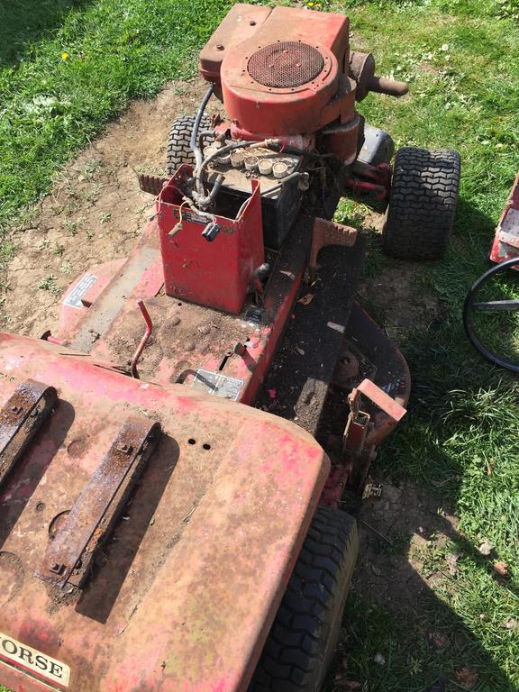

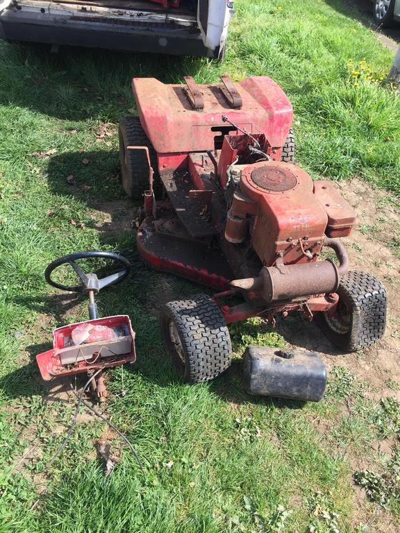

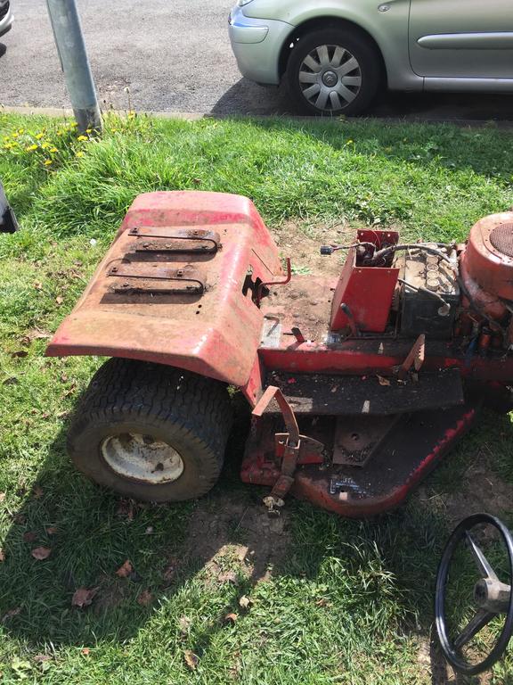

Entps 0 #1 Posted April 27, 2017 Hi I'm new to this forum based in the U.K. And have just acquired a wheel horse as a small restoration project I'm having trouble working out what model it is as the model number brings nothing up with it 92-14bf-91 if anybody can spread some light on it thanks ive added some photos had to remove the steering wheel to fit it into my car . Share this post Link to post Share on other sites
cranman51 39 #2 Posted April 27, 2017 looks to me like a 211-5 Share this post Link to post Share on other sites
gwest_ca-(File Mod) 12,146 #3 Posted April 27, 2017 Welcome to the forum. The 9 is for 1979. The 2 is for lawn tractor as opposed to garden tractor. Will guess the 14 in the model number is a 11 for a 11 hp engine. B=Briggs & Stratton engine F=Foote transmission. The 91 on the end is common on Belgium built models and a parts list identifier. There was also a B-111 4-Speed in 1979 but it used a Peerless transmission identified with a P instead of an F in the model number. Garry 2 Share this post Link to post Share on other sites
