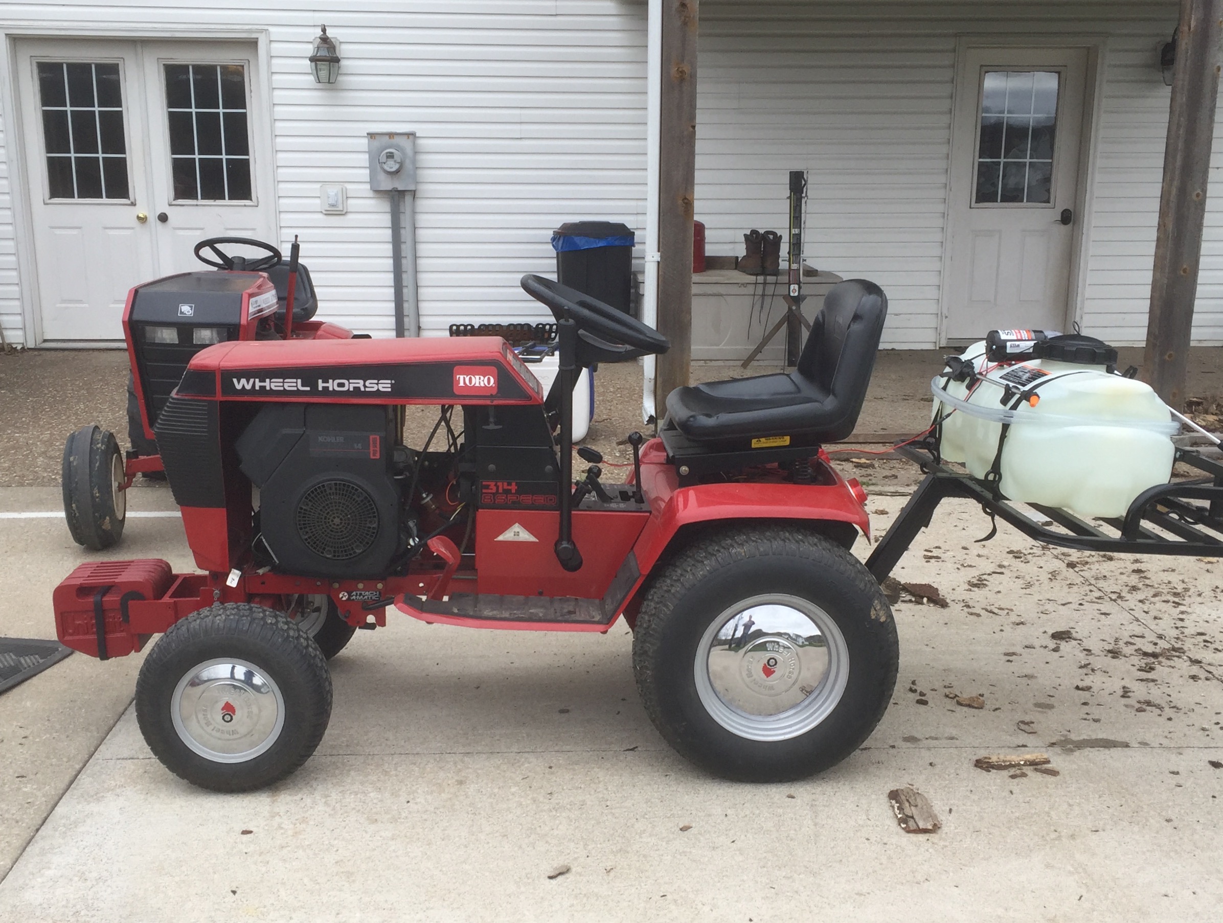

cschannuth 3,821 #3 Posted April 24, 2017 1 hour ago, Marv said: Anybody mounted a sprayer on their tractor? Marv This is what I did. It worked like a champ. I had the cargo carrier and added the 2" receiver. 4 Share this post Link to post Share on other sites

steelman 255 #5 Posted April 24, 2017 That is nice! I have been thinking of a similar setup for a sprayer. Share this post Link to post Share on other sites
Tankman 3,528 #6 Posted April 25, 2017 Very nice setup. Darn, now I have no excuse. I do like your setup better than a trailer spray. Let us spray. Share this post Link to post Share on other sites
shallowwatersailor 3,222 #7 Posted April 25, 2017 (edited) On 4/23/2017 at 10:00 PM, cschannuth said: This is what I did. It worked like a champ. I had the cargo carrier and added the 2" receiver. Is there any blow-back on to the tractor with the sprayer being that close? I have heard on other forums of it attacking the finish. Edited April 25, 2017 by shallowwatersailor Share this post Link to post Share on other sites
cschannuth 3,821 #8 Posted April 25, 2017 2 hours ago, shallowwatersailor said: Is there any blow-back on to the tractor with the sprayer being that close? I have heard on other forums of it attacking the finish. No. The boomless nozzle doesn't have a very fine spray so it doesn't drift much. Plus it's about 3 or 4' from the back of the tractor. One thing you will need is weight for the front of the tractor. It gets pretty light with that 16 gallon sprayer back there. 2 Share this post Link to post Share on other sites
Marv 996 #9 Posted April 25, 2017 Craig, that is kinda what I had in mind to do. I have mine as a pull behind but I was thinking to add a fixed boom and thought it might work better to have sprayer mounted to tractor. Weight is definitely a factor. I thought about maybe swivel wheels on the dolly while having the unit attached to the tractor so it dos not act like a trailer with a tongue. Marv Share this post Link to post Share on other sites
