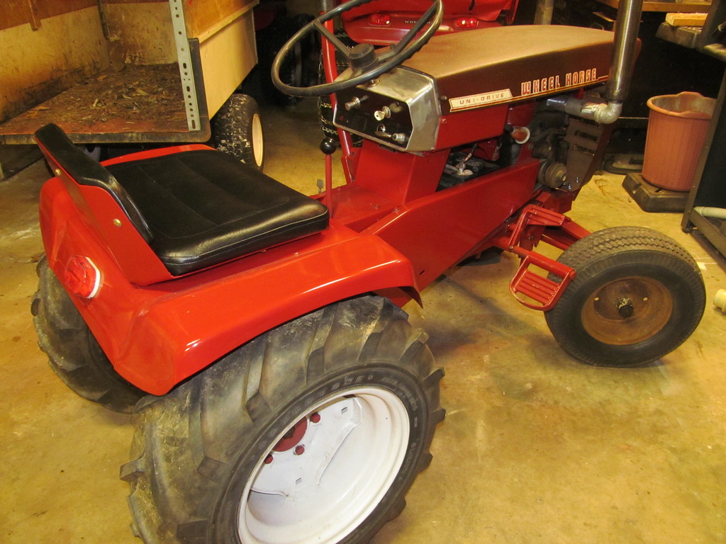

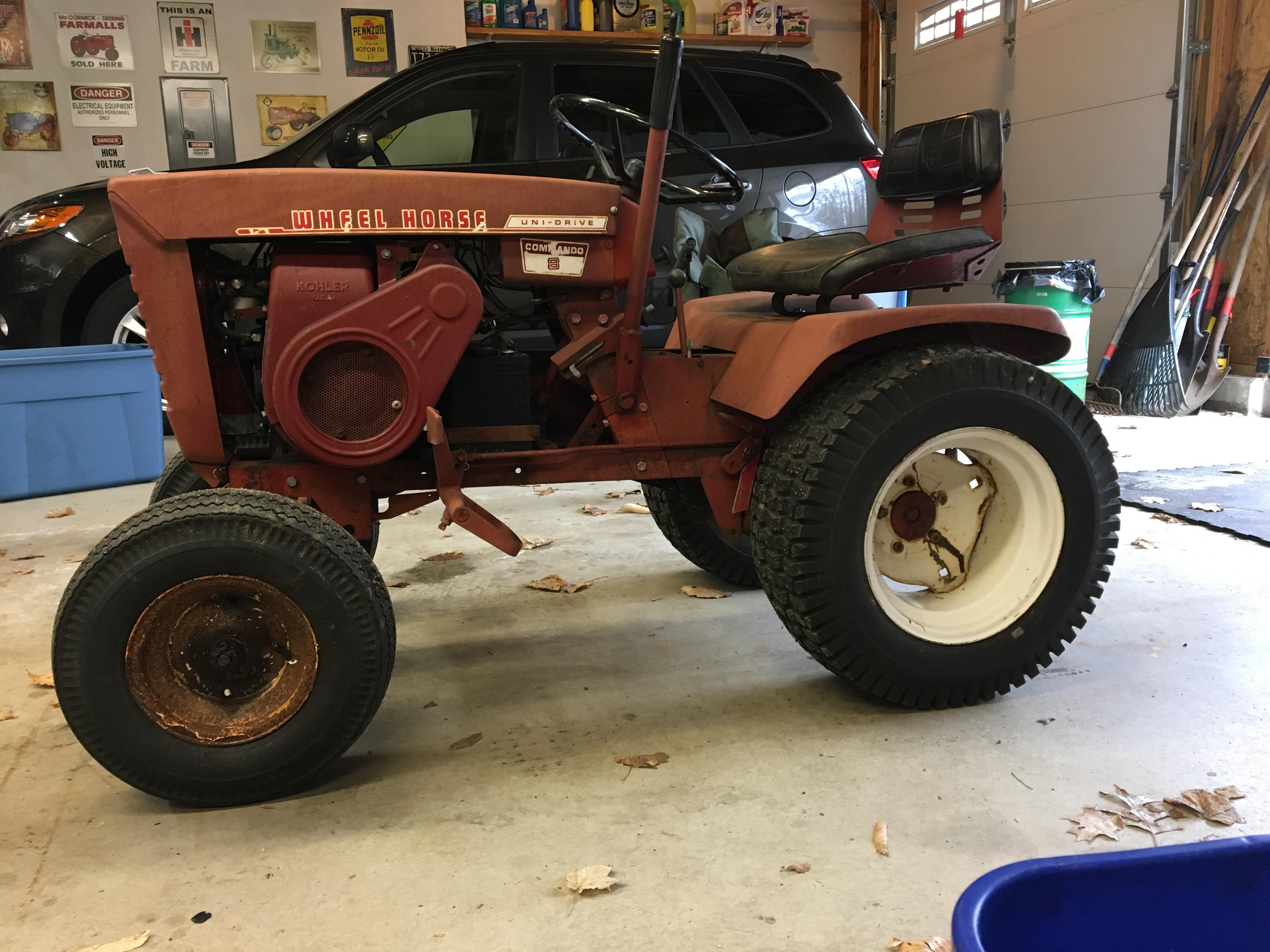

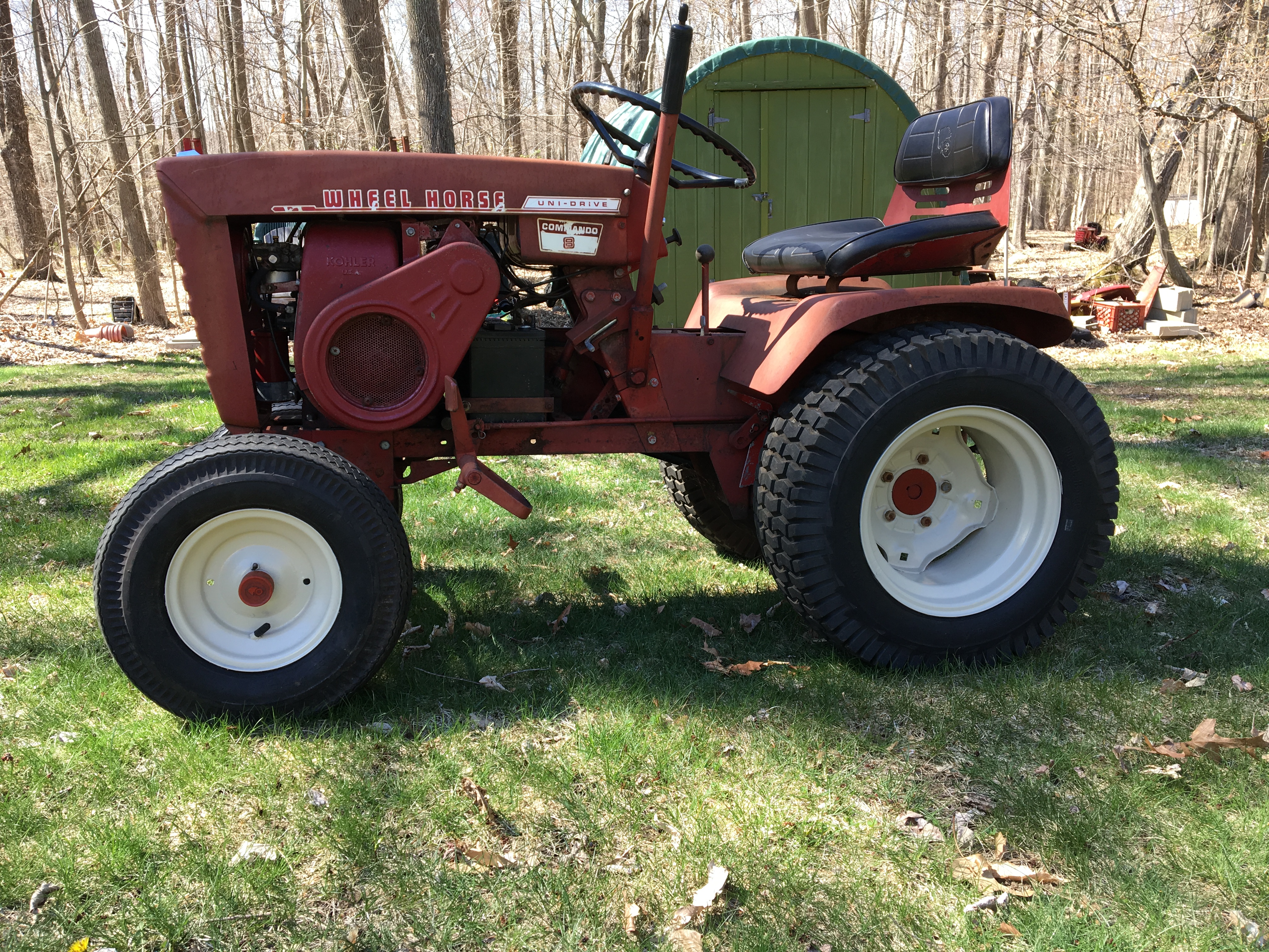

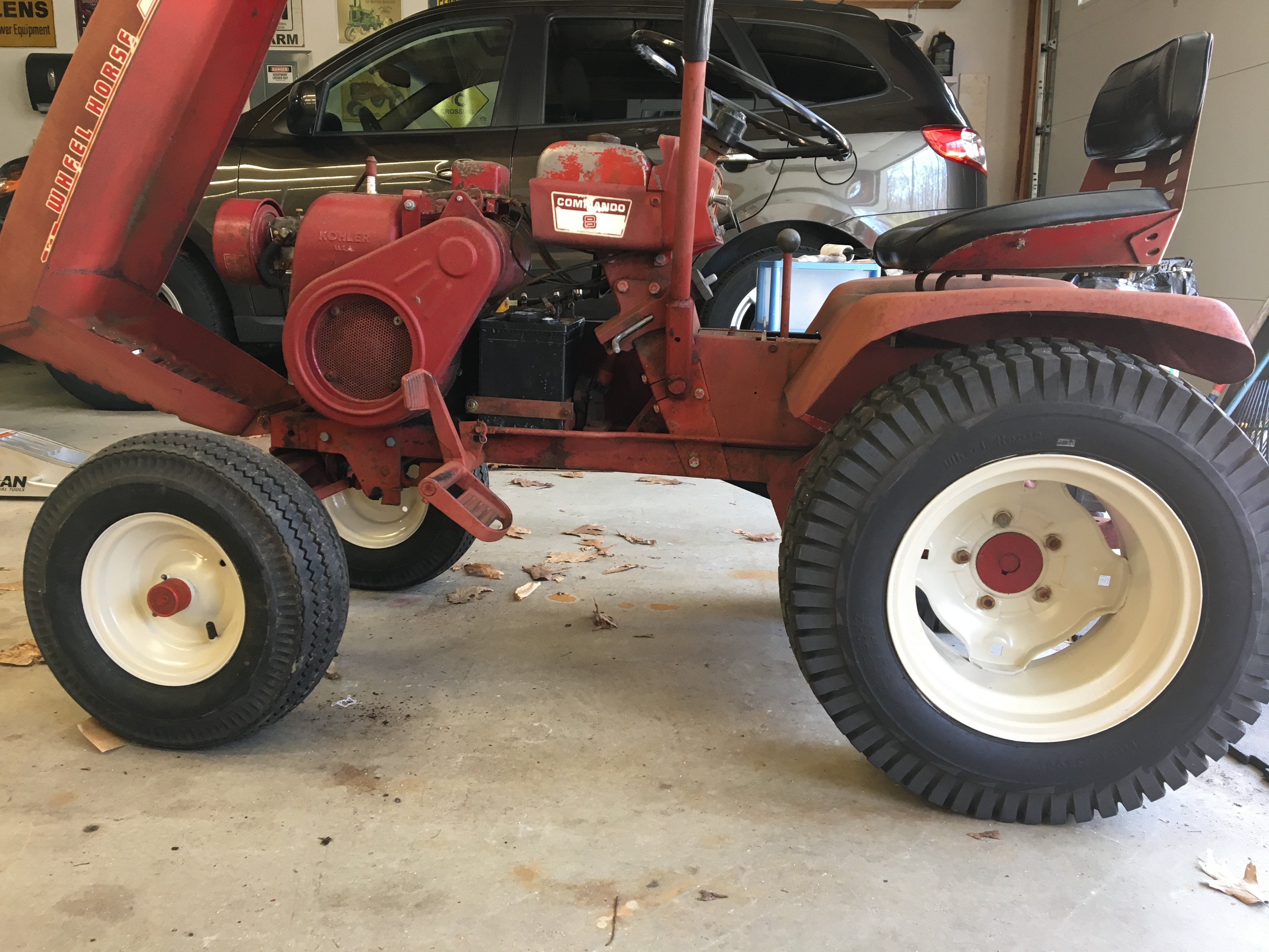

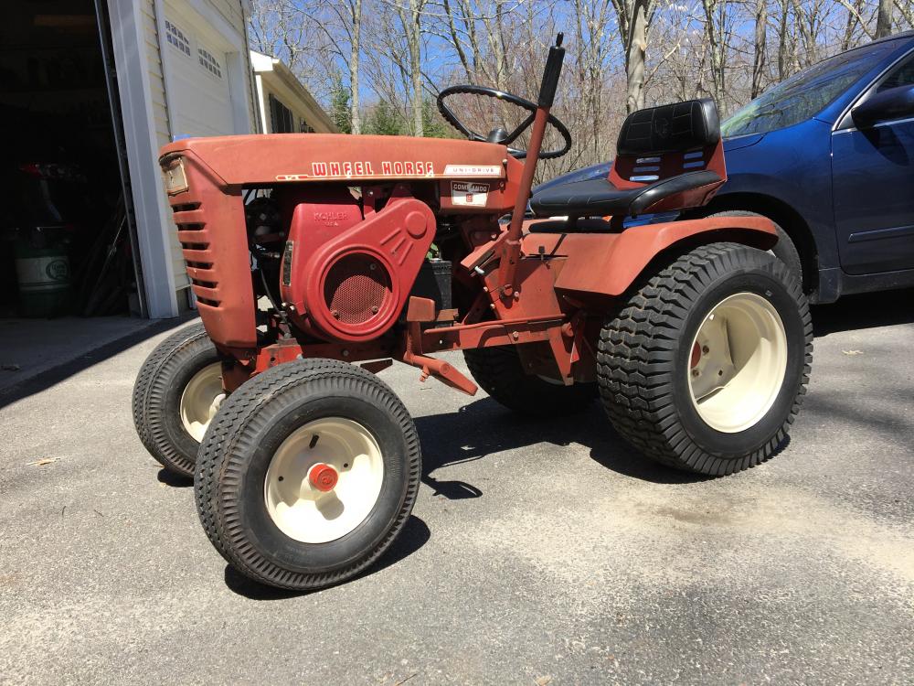

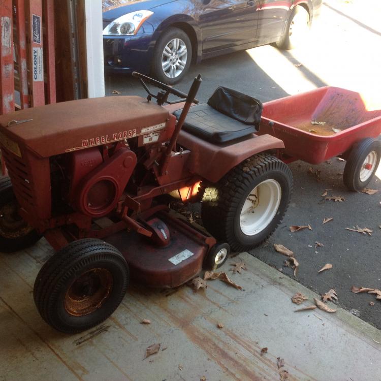

Sparky-(Admin) 23,990 #1 Posted April 23, 2017 This one came to me last year and after a couple carb cleanings, a carb rebuild, all new fuel lines and filters and three different fuel pumps it still ran crummy....so I parked it all winter in disgust. But when I saw Stevasaurus's video @stevasaurus of a couple of his short frames running it motivated me to try again. First thing I did was reset the points after giving them a light sanding.....AND THE DAMN THING RAN GREAT!!! I can't believe I didn't mess with the points last year 🙄 ! This new development re-newed my interest and this weekend I gave the rims some attention. I love the patina so I won't be messing with the sheet metal. Pics of course.....first pic is when it came home. Mike..... 19 Share this post Link to post Share on other sites
Amcwheel85 2,059 #2 Posted April 23, 2017 Awesome! How did you get the wheels looking so good? Share this post Link to post Share on other sites
Sparky-(Admin) 23,990 #3 Posted April 23, 2017 1 minute ago, Amcwheel85 said: Awesome! How did you get the wheels looking so good? Thanks!! It took quite a bit of wire wheeling to get all the flaky paint off.....one good coat of primer and two coats of gloss Almond (all rattle cans of course). Mike..... 4 Share this post Link to post Share on other sites
Amcwheel85 2,059 #4 Posted April 23, 2017 As soon as I get my 1045 home I will send you those wheels... sounds like you know what your doing haha! Your tractor looks great! 3 Share this post Link to post Share on other sites

Terry M-(Moderator) 2,271 #10 Posted April 24, 2017 That's my Favorite look on a Wheel Horse Tractor.....Good red Patina with nicely painted rims.. You'll notice that when looking at my collection... 5 Share this post Link to post Share on other sites
Ed Kennell 43,815 #11 Posted April 24, 2017 When I redid mine, the hood was the last part to paint and it was just too purdy to touch, so I ended up with a two tone. Those creamy wheels really dresses em up. 2 Share this post Link to post Share on other sites

farmer 1,081 #15 Posted April 24, 2017 (edited) Of the tractors I have the commando 8 sounds the best, especially starting it. I stripped mine down for paint, it's now half primed. Seeing yours makes me wonder if I should have left it original. Yours looks the biz. Edited April 24, 2017 by farmer 2 Share this post Link to post Share on other sites
Sparky-(Admin) 23,990 #16 Posted April 24, 2017 22 minutes ago, farmer said: Of the tractors I have the commando 8 sounds the best, especially starting it. I stripped mine down for paint, it's now half primed. Seeing yours makes me wonder if I should have left it original. Yours looks the biz. My bodywork and paint skills are lousy, so it was an easy decision to leave the patina alone. Mike.... Share this post Link to post Share on other sites
