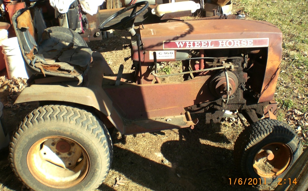

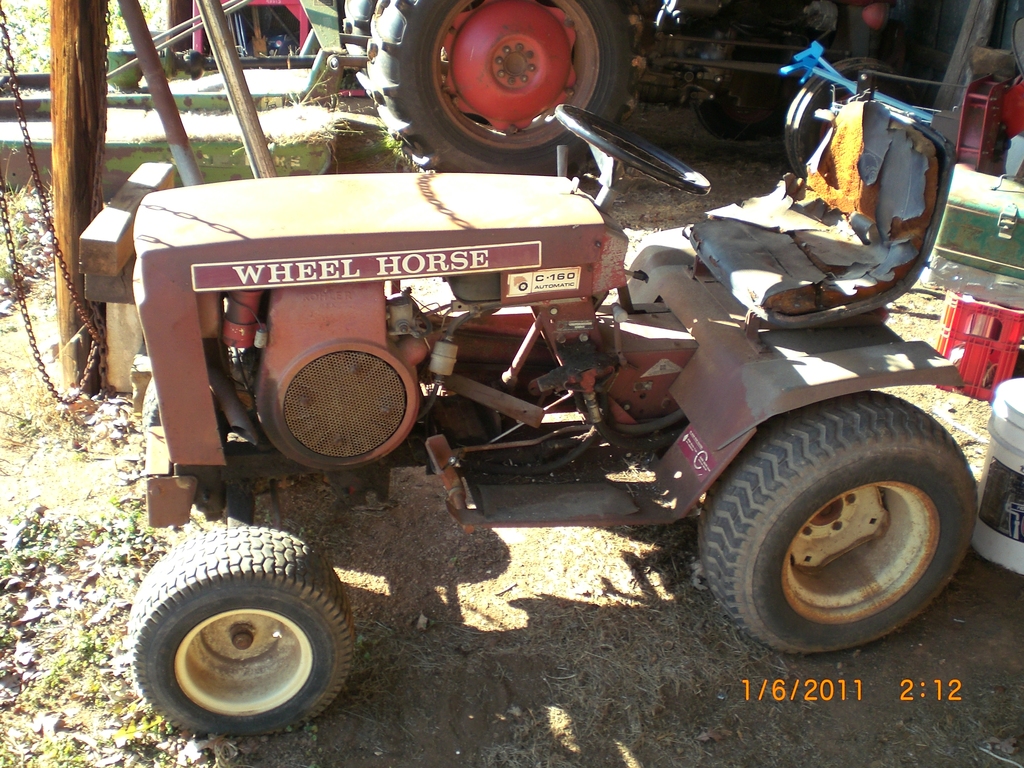

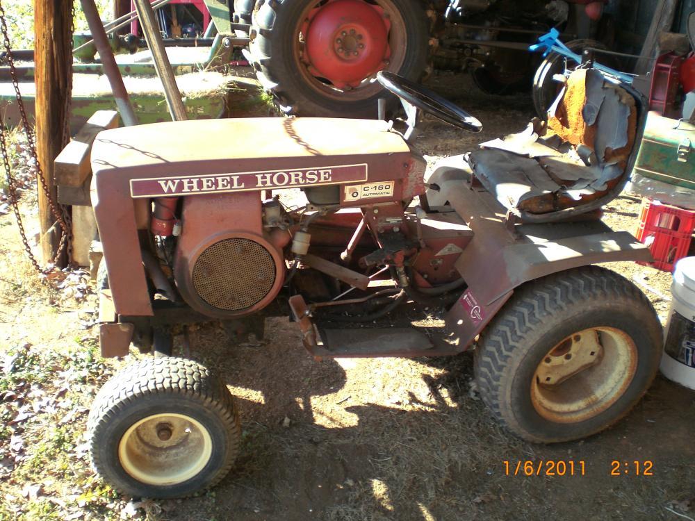

manant 57 #4 Posted April 23, 2017 I am not using the WH hydro filter. I recovered the C160 from my neighbor's shed where it had sat for 5 or 6 years without running. He was going to send it to the dump, but gave it to me to play with, and I restored it somewhat. It had the NAPPA 1410 filter on it then and I have replaced it several times over the six years I have had it. No problems up to now. It does seem to slow down in reverse after mowing for a while, but I see no difference in forward. I did notice that the drive belt had been rubbing against a 12 gauge copper wire caught up under the belt guard. I wonder if the belt got stretched or is not tight enough. Would that affect anything since there is the "idler pulley" that engages when the brake is pushed down. When you mention the cylinder are you talking about the seal in the lift control or seal in the cylinder at foot rest level. How hard is it to rebuild or replace "O" rings in either one. Should the hosed be replaced also? Thanks for you replies. Share this post Link to post Share on other sites
