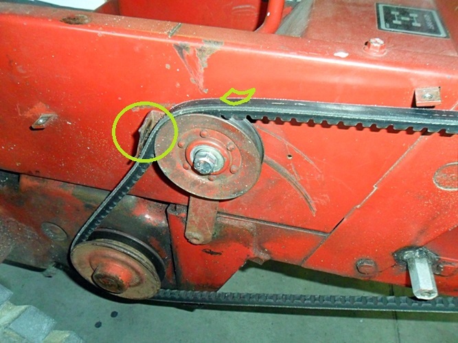

953 nut 68,774 #2 Posted April 19, 2017 Your belt guard plays a major role in declutching a . Presuming you have the belt guard on, the only thing that comes to mind is the tab on the idler on the clutch arm may not be far enough forward to hold the belt from turning while releasing the clutch. Try rotating it upward a bit if it is too far back. 1 Share this post Link to post Share on other sites

WHX?? 57,886 #4 Posted April 19, 2017 On my tractors Richard that tab is fastened to the clutch arm and cab's be moved. Not sure if that's the case with a 314 or not. Sounds like a 82" belt is too short? Hopefully 314 owners will chime in as to what they use and some pics for guidance. BTW @tbear0714 Share this post Link to post Share on other sites
tbear0714 0 #5 Posted April 19, 2017 6 hours ago, 953 nut said: Your belt guard plays a major role in declutching a . Presuming you have the belt guard on, the only thing that comes to mind is the tab on the idler on the clutch arm may not be far enough forward to hold the belt from turning while releasing the clutch. Try rotating it upward a bit if it is too far back. That is what I thought is that it is to short. OEM is 81.99 so you would think 82 would be right. OEM says the belt is 81.99 so I figured a 82 would be just right. But I agree that it seems to short. Share this post Link to post Share on other sites
