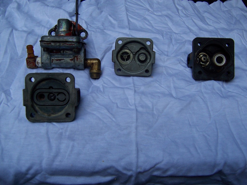

953 nut 64,642 #5 Posted April 19, 2017 (edited) 50 minutes ago, ibskot said: How hard is a fuel pump cleaning? An old tooth brush, a small bowl, some mineral spirits or lacquer thinner and a screwdriver should be all you need. Once it is apart you can remove the valves and clean them with the tooth brush (they will pop right out with little effort) make sure all passages are open. The diaphragm is the only internal gasket and should be able to be reused. yours will probably be like the one in the center. Edited April 19, 2017 by 953 nut 3 Share this post Link to post Share on other sites

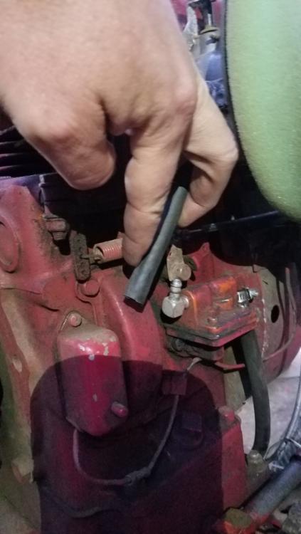

squonk 45,805 #18 Posted April 21, 2017 Electric. The kink explains the install. Share this post Link to post Share on other sites
