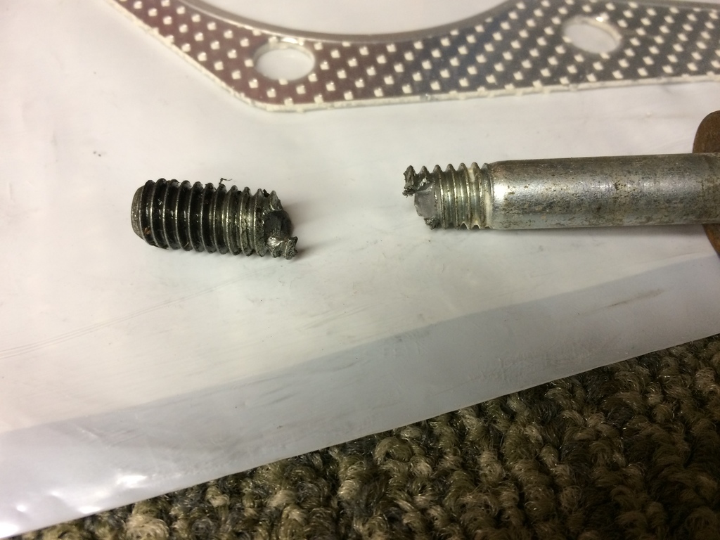

squonk 47,437 #1 Posted April 18, 2017 Tearing down a K 301. Head bolt started to come out then bound up some. Finished spinning it out and only part of it came out. Pulled the head and the remaining piece spun out easily with my fingers. If I put the pieces together it looks like part of the bolt was eaten away! 7 Share this post Link to post Share on other sites
stevasaurus 23,748 #2 Posted April 18, 2017 How close was that bolt to the exhaust port stuff?? Cents, since, sense you did not ask a question. Hi Mike 4 Share this post Link to post Share on other sites
Jerry77 1,218 #3 Posted April 18, 2017 29 minutes ago, squonk said: it looks like part of the bolt was eaten away That is strange - it looks like it sheared as it was being tightened ! ! Defective bolt maybe ?? That's a new one on me.. Share this post Link to post Share on other sites
Racinbob 13,047 #4 Posted April 18, 2017 Definitely your lucky day Mike. Share this post Link to post Share on other sites
WHX?? 57,470 #5 Posted April 18, 2017 Yah that's bizarre. .. I'm with Bob....quick go buy a lottery ticket! Share this post Link to post Share on other sites
6bg6ga 272 #6 Posted April 18, 2017 If it were me I would go grab a tap and run it down the hole carefully. It probably doesn't need it but it only takes a second and if by chance a burr was kicked up the tap will clean the threads good. Check the head for flatness. I would also replace ALL the bolts for that head making sure you have the correct grade and I would lightly coat the threads with anti-seeze. 2 Share this post Link to post Share on other sites
squonk 47,437 #7 Posted April 19, 2017 (edited) The bolt was in the rear of the head. All of the bolt holes have been tapped. Just recieved new grade 8 flange head bolts from Fastenal today. sent from a pile of leaves in Dino's back yard using Crapatalk Edited April 19, 2017 by squonk 4 Share this post Link to post Share on other sites

lynnmor 8,920 #17 Posted April 19, 2017 18 hours ago, Jerry77 said: That is strange - it looks like it sheared as it was being tightened ! ! Defective bolt maybe ? I agree, perhaps over-tightened going in. Without seeing the rest of the bolt, it appears to be of lower quality 1 Share this post Link to post Share on other sites

squonk 47,437 #20 Posted April 19, 2017 (edited) 4 hours ago, lynnmor said: I agree, perhaps over-tightened going in. Without seeing the rest of the bolt, it appears to be of lower quality A lot of the bolts were very tight when I took them out. Also I noticed how shiny they were and thought they were run of the mill hardware store bolts but they were grade 8's sent from under Aldon's umbrella using crapatalk Edited April 19, 2017 by squonk Share this post Link to post Share on other sites
