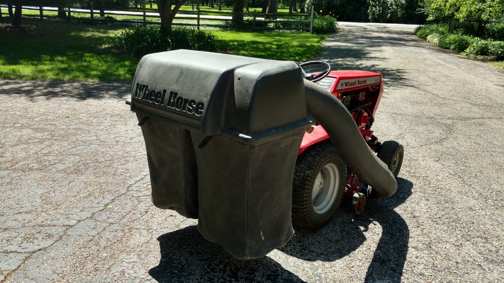

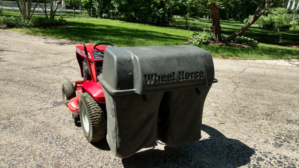

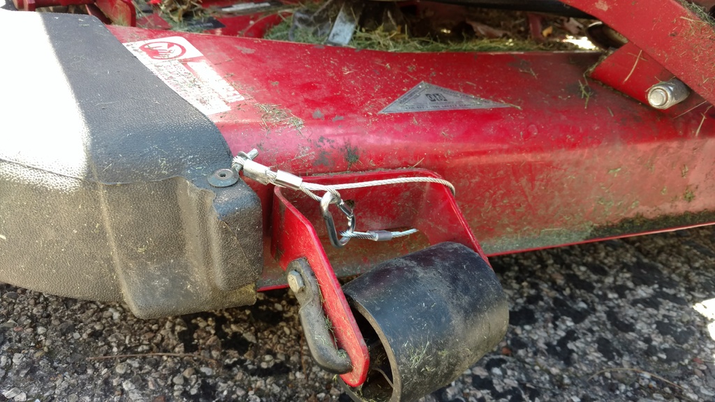

CurtS 35 #53 Posted June 8, 2017 Here she is waiting for the new tires. I got the bagger working last week and rigged up a new cable to hold the chute to the mower deck. I could use another one of these plastic hub caps. Dealer said it's part number 109154 and is discontinued. Anyone know where I can buy one? 3 Share this post Link to post Share on other sites
stratostar250 934 #54 Posted June 8, 2017 Send a message to Glenn, he makes them, He'll be able to give you a hand! 2 Share this post Link to post Share on other sites

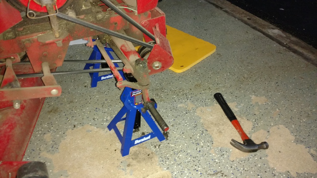

CurtS 35 #63 Posted April 21, 2018 Hello again everyone! I took my 1985 308-8 out of the garage today and discovered that my right rear axle had been leaking fluid over the winter. I checked the dip stick and it was between F and L. I called the dealer who serviced it last year. I explained that the fluid I saw on the ground didn't look like regular oil. I was a light brown with a yellow/green tint. They checked the records and said when they serviced it they used Lucas 80W-90. The mechanic at the dealer said it was better to use the heavier Lucas 80W-90 instead of SAE 20 or 10w-30 or 10w-40 as described in the manual. I'm assuming I have the 312A trans (SAE 20) with my model and not the 417A or 420-LSE, but I'm not sure. I do have a set of low/high gears 1-3 and reverse. I think this is considered 8 speeds. Today's plan was to fill it up and run it for a while to see if the seals in the axle would seal back up in case they dried out over winter. So I topped it off with the Lucas 80W-90 and ran it for about 15 minutes. It's still leaking, but the leak is a slow leak. I was thinking about draining out all the transaxle oil tomorrow and replacing it with the Lucas 80W-90 and testing again. The thing is that I'm not really sure what was put in last year. The Lucas oil I put in didn't seem to mix completely with what was already there. At least it appears that way on the dipstick. I'm a little skeptical about using 80W-90 when the manual specifies something much lighter, but I'm trying it per the dealer's mechanic service record and recommendation. Another dealer I talked to said the only way to fix the seals is to take apart the entire axle and basically rebuild for about $600. I don't want to go this route unless I have to, but I don't want to damage any gears in the process of testing it and trying to get it to seal either. I'm looking for help and advice on how to proceed with this. Also, wondering if anyone can recommend a good Wheel Horse mechanic in the Chicago area. Share this post Link to post Share on other sites
608KEB 843 #64 Posted April 21, 2018 51 minutes ago, CurtS said: Hello again everyone! I took my 1985 308-8 out of the garage today and discovered that my right rear axle had been leaking fluid over the winter. I checked the dip stick and it was between F and L. I called the dealer who serviced it last year. I explained that the fluid I saw on the ground didn't look like regular oil. I was a light brown with a yellow/green tint. They checked the records and said when they serviced it they used Lucas 80W-90. The mechanic at the dealer said it was better to use the heavier Lucas 80W-90 instead of SAE 20 or 10w-30 or 10w-40 as described in the manual. I'm assuming I have the 312A trans (SAE 20) with my model and not the 417A or 420-LSE, but I'm not sure. I do have a set of low/high gears 1-3 and reverse. I think this is considered 8 speeds. Today's plan was to fill it up and run it for a while to see if the seals in the axle would seal back up in case they dried out over winter. So I topped it off with the Lucas 80W-90 and ran it for about 15 minutes. It's still leaking, but the leak is a slow leak. I was thinking about draining out all the transaxle oil tomorrow and replacing it with the Lucas 80W-90 and testing again. The thing is that I'm not really sure what was put in last year. The Lucas oil I put in didn't seem to mix completely with what was already there. At least it appears that way on the dipstick. I'm a little skeptical about using 80W-90 when the manual specifies something much lighter, but I'm trying it per the dealer's mechanic service record and recommendation. Another dealer I talked to said the only way to fix the seals is to take apart the entire axle and basically rebuild for about $600. I don't want to go this route unless I have to, but I don't want to damage any gears in the process of testing it and trying to get it to seal either. I'm looking for help and advice on how to proceed with this. Also, wondering if anyone can recommend a good Wheel Horse mechanic in the Chicago area. It's a axle seal. You can get a set for $10.00. Take the wheel off. Remove the hub. You can take the seal out with a small pic. Share this post Link to post Share on other sites
CurtS 35 #65 Posted April 21, 2018 Wow, that sounds easy enough. Thank you. Is this the seal that's between the differential and the axle? The leak is about a foot in from the wheel and about 8" out from the differential. Where can I buy these seals? What do you think about using the Lucas 80W-90? Share this post Link to post Share on other sites
953 nut 68,627 #66 Posted April 21, 2018 Your 308-8 is a manual shift and uses gear oil, the 312-A is a hydro. and uses 10 W 30. You may only need an axle seal, or it could be more involved. Jack up the rear end and see if the axle not the hub) has any play (movement) from front to rear or up and down. If there is any play you have a bearing that is in need of replacement. If no movement is found it is only a seal and can be replaced without going inside the transaxle. 1 Share this post Link to post Share on other sites
CurtS 35 #67 Posted April 21, 2018 Thank you! Yes, manual shift with independent rear suspension. Do you know what model transaxle I have? I don't see any play and I'd like to try changing the seals. How do I do this? Are there instructions anywhere on how to change these seals? Not sure where to buy the parts either. None of the dealers I talked to offered this solution. I don't think they're entirely familiar with Wheel Horse tractors? Anyone know a good Wheel Horse mechanic near Chicago? I'm in the west burbs. I'm not a great mechanic and I'd like to find someone local who I can work with to keep my Wheel Horse running well. I also found a viscosity chart the explains that gear oil and crankcase oil have different numbers. I feel better about using the Lucas gear oil based on this. It seems the numbers are closer to what's recommended in the manual. I don't think the Lucas will hurt anything. Share this post Link to post Share on other sites
