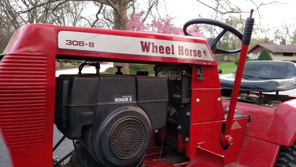

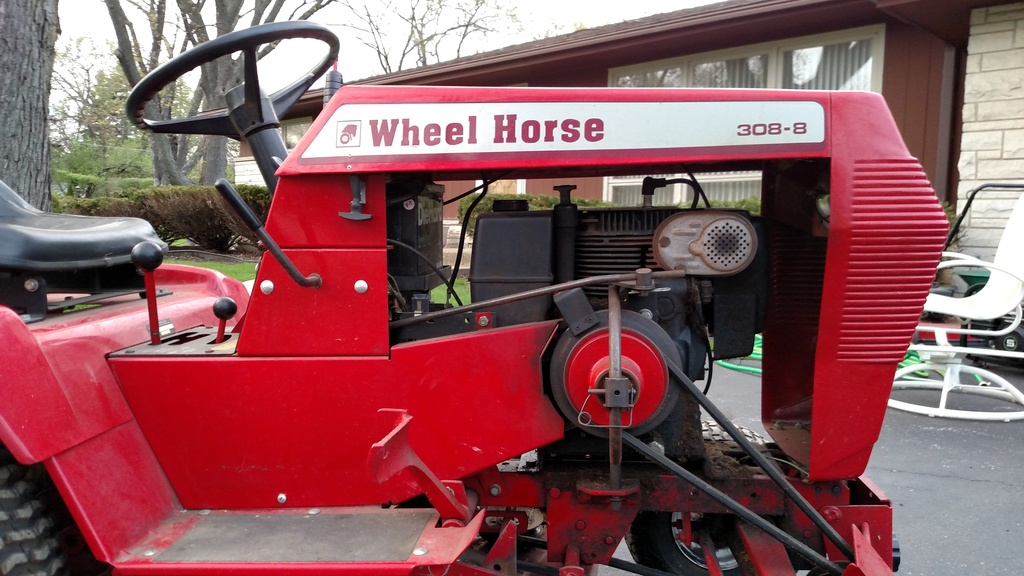

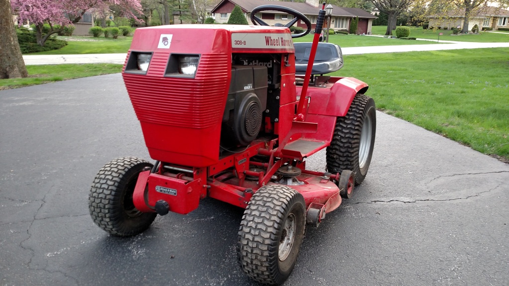

CurtS 35 #11 Posted April 20, 2017 Thanks everyone for the welcome! I'm looking forward to learning how to get this old red machine running again. The model number on the side of the tractor hood is 308-8. I inflated the tires yesterday and rolled the tractor out of the garage to take some pictures. The tires actually seem like they could be used for a while. They are holding air (12 lbs rear, 14 lbs front) and don't seem to have excessive dry rot. I figure my next steps are to replace the battery, clean the carburetor, change the oil, and change the spark plug. Am I on the right track? I don't know, do I need to do anything with the gas tank? Drain out the old gas and clean? Anything else? My Dad says the cylinders are rusted and it will never run again. Not sure what products to use or what oil it takes. Our previous tractor was an even older model Wheel Horse. If I remember it took straight SAE 30 oil, but not sure if this one uses the same oil. More pictures to follow in additional posts... 13 Share this post Link to post Share on other sites
gwest_ca-(File Mod) 12,533 #12 Posted April 20, 2017 Can see the ID decal behind the shifter in the last photo. Numbers still readable? Garry Share this post Link to post Share on other sites
Ed Kennell 47,820 #13 Posted April 20, 2017 3 hours ago, CurtS said: I figure my next steps are to replace the battery, clean the carburetor, change the oil, and change the spark plug. Am I on the right track? I don't know, do I need to do anything with the gas tank? Drain out the old gas and clean? Anything else? My Dad says the cylinders are rusted and it will never run again. Not sure what products to use or what oil it takes. Our previous tractor was an even older model Wheel Horse. If I remember it took straight SAE 30 oil, but not sure if this one uses the same oil. That is a great looking 308 and it appears to have been stored inside. You are definitely on the right track. 30W engine oil is fine. I don't understand why Dad feels the cylinder is rusted. This usually only happens when a tractor is stored outside with out a spark plug and water enters the engine. If you see no water when you change the oil, it should be fine. Yes, drain out the old fuel , flush out the tank and lines with new fuel, and clean the carb. You may have to clean the fuel pump also, but that is later. Not being run in 20 years may be a good thing...there is probably no ethanol in the system. Check the gear oil in the transmission. Grease all the zerk fittings...wheels, spindles, axle pivot, steering gear, clutch pedal, and deck spindles if they have them. 5 Share this post Link to post Share on other sites

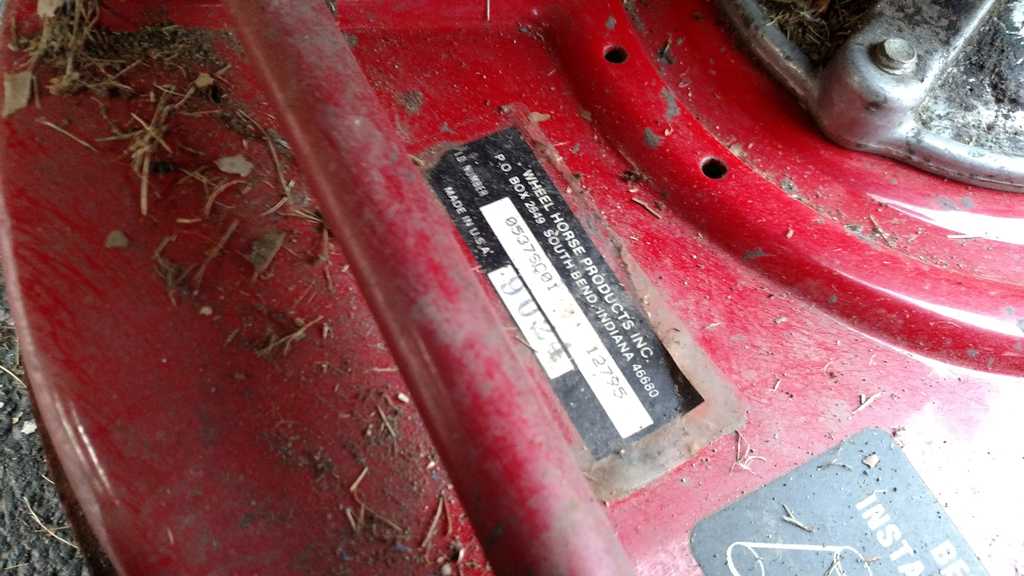

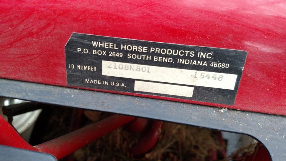

CurtS 35 #18 Posted April 21, 2017 Great advice everyone. Thank you! Here are pictures of the id plates on the seat and deck. This tractor could have been purchased around 1985. I couldn't remember that exact year that my Dad bought it. I don't have any manuals for it. The right front tire has a leak and was flat when I looked at it today. The other three tires looked fine. I will try to turn the engine by hand. Thanks again. 1 Share this post Link to post Share on other sites
farmer 1,081 #19 Posted April 21, 2017 I agree with the others, the tractor looks in too good a nick to have the engine seized, but worth checking. Also looks like the engine to deck drive belt is twisted. Share this post Link to post Share on other sites
gwest_ca-(File Mod) 12,533 #20 Posted April 21, 2017 Tractor manuals Your mower is a 1989 model determined by the 9024 build date Garry 3 Share this post Link to post Share on other sites
