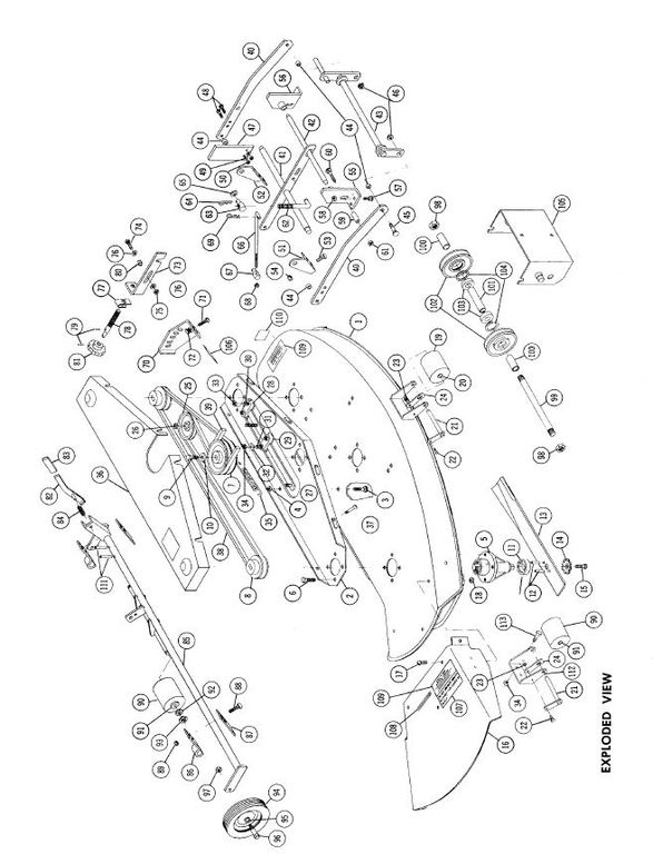

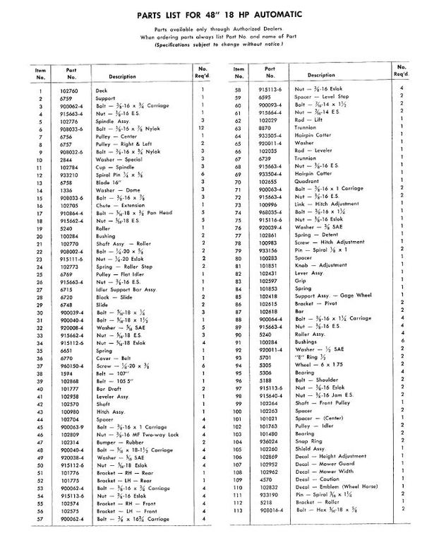

erickson13455 1 #1 Posted April 18, 2017 I need a little help finding anti scalp deck rollers for this deck. They wore out cant find any locally. Anyone got a part number so I can order online. Also the pin that holds the roller is wore down to half size, actually the bottom was wore flat. So a part number and place to buy those from would help also. Also where to get new blades from, and a part number. The deck book I have doesn't give any part numbers it must just be a brochure. Share this post Link to post Share on other sites
pfrederi 21,055 #2 Posted April 18, 2017 Prior year but yours should be the same Share this post Link to post Share on other sites
