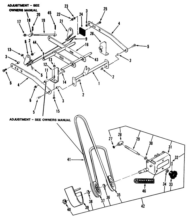

Cadmandu 67 #1 Posted April 18, 2017 Good Spring to all, Well i just completed my first Spring mowing with my new 42" deck. I sold my 37" and bagger system a few months ago. The 42" deck does a much better job and is a better fit with my bigger front, tires and spindles. I had 1/4" clearance with the 37" deck. My question is why do I still need the flat pulley on the mule drive? I still have a twist in the belt between the deck pulley and the mule drive. I thought that I could use two V's on the mule. I checked my trans axle fluid and it looked tan colored did water get in? What do you guys use for replacement? This is a 89 312-8? I am looking for front wheel weight or the kind that you hang on the front. Did wheel horse sell an attachment for the front to hang weights on? Thanks Happy Mowing Share this post Link to post Share on other sites

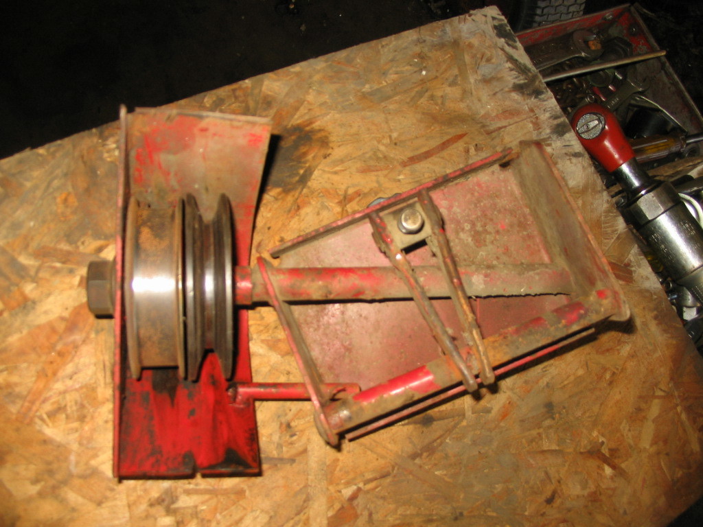

daveoman1966 3,884 #2 Posted April 18, 2017 (edited) You need the FLAT pulley on the mule drive. Here is a pic of why. Here also is a pic of the SPINDLE BELT on the 42" deck Here is the MULE DRIVE schematic...it is just a simple 4-sided V belt: #37 is the FLAT pulley. #35 is a V pulley. #41 is the V belt. Edited April 18, 2017 by daveoman1966 1 Share this post Link to post Share on other sites
Ed Kennell 46,606 #3 Posted April 18, 2017 I assume you are using a 4 sided and not a 6 sided belt. If you tried to use a vee pulley on the belt coming from the bottom of the PTO pulley, you would have to put a 180 degree between those pulleys. That would not work. You should have about an 80 degree twist between the mule to deck pulley Share this post Link to post Share on other sites
