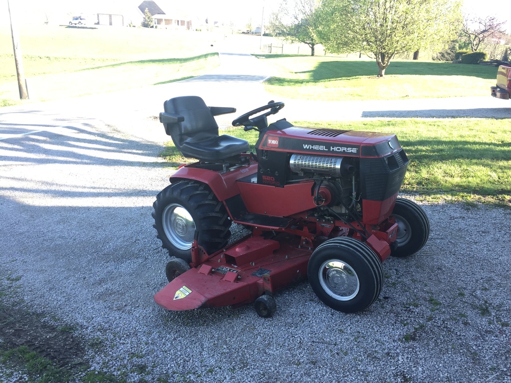

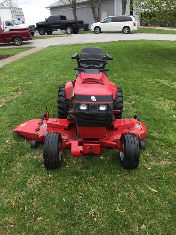

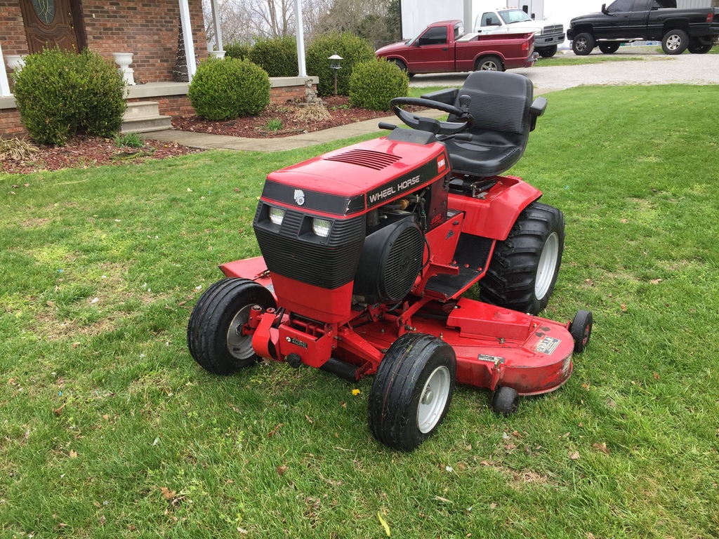

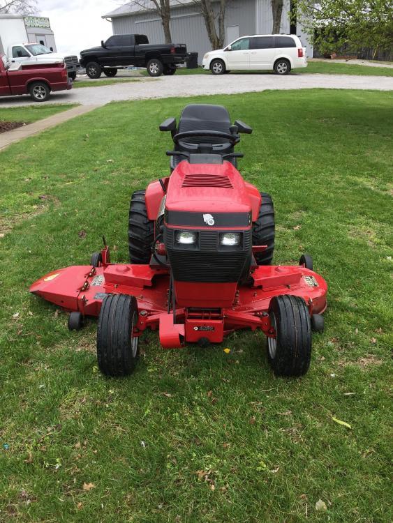

Adams94 1,069 #1 Posted April 18, 2017 Dad recently bought a 520h from a friend of his that was the first owner, it has the 60" deck on it. Great tractor but when mowing around trees and things he noticed the front end would slide some, is this common? 1 Share this post Link to post Share on other sites
