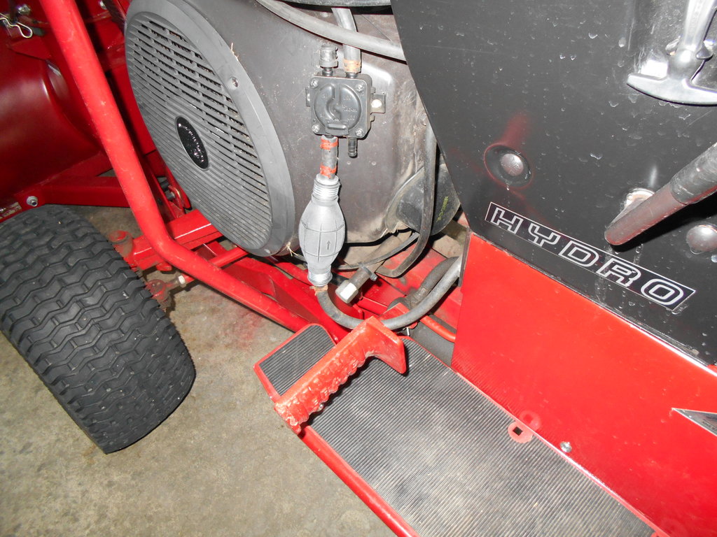

scotty 252 #5 Posted April 16, 2017 (edited) I put on one of those in line hand primer pumps they work pretty good. Like this. Just make sure you get the right size for your fuel line. http://www.ebay.com/itm/like/182005970824?lpid=82&chn=ps&ul_noapp=true Edited April 16, 2017 by scotty 8 Share this post Link to post Share on other sites

cleat 9,324 #7 Posted April 16, 2017 17 minutes ago, scotty said: I put on one of those in line hand primer pumps they work pretty good. Like this. Just make sure you get the right size for your fuel line. http://www.ebay.com/itm/like/182005970824?lpid=82&chn=ps&ul_noapp=true I put hand primers on all 4 of my 520's and after a few quick squeezes they start right up. Even worked great after sitting all winter. 3 Share this post Link to post Share on other sites
clueless 3,437 #8 Posted April 16, 2017 5 hours ago, cleat said: I put hand primers on all 4 of my 520's and after a few quick squeezes they start right up. Even worked great after sitting all winter. Where in the fuel line did you put your primers? Also is the one on ebay listed here the one you used? Share this post Link to post Share on other sites

cleat 9,324 #10 Posted April 16, 2017 5 hours ago, clueless said: Where in the fuel line did you put your primers? Also is the one on ebay listed here the one you used? I put them just before the fuel pump. Yes, I bought cheap ones off of ebay straight from China. If these fail but I like them (I think I will) then I will buy better ones. Share this post Link to post Share on other sites
