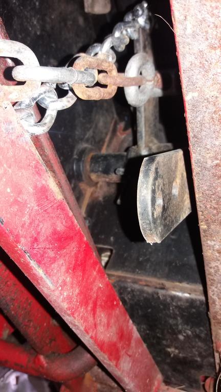

Little 308-8 2 #1 Posted April 14, 2017 Happy Easter. I bought a clevis hitch to attach a blade on the back of the tractor. Question is, what picks it up? I see a little tube and I found a tube and cable set on ebay, but if I have the tube can I use a cable from tractor supply? I also didn't see where it would attach to under the tractor. 2 side questions, anyone put a smaller drive pully on the trans for a little more speed? Adjustable, electric lift? Gettin picky on this one. Lol Thanks for the help. Scott Share this post Link to post Share on other sites

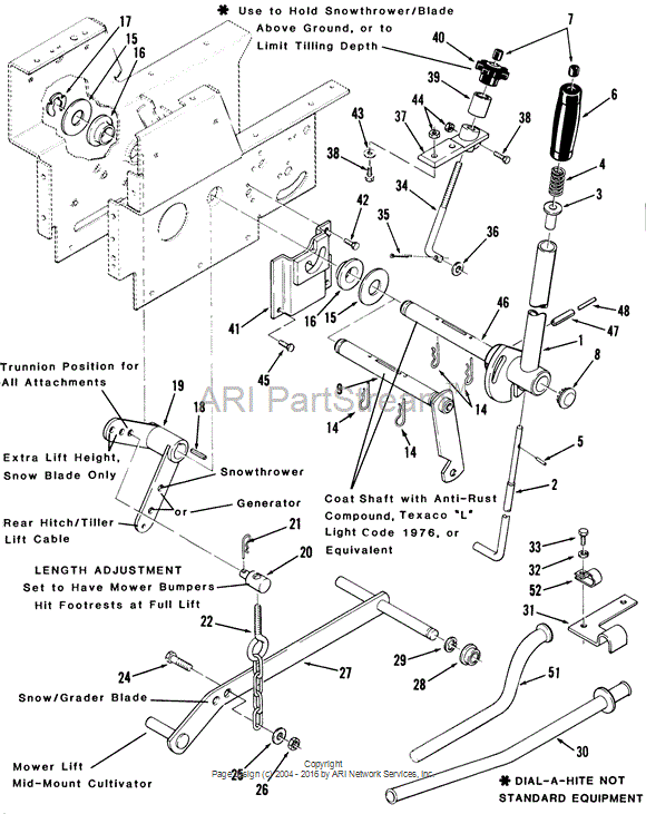

WVHillbilly520H 10,378 #2 Posted April 14, 2017 The tube is a conduit for a cable that is threaded on one end and a ball on the other, the ball fits in a clevis that attaches to the rock shaft that goes through the frame in front of the trans that lifts the deck the threaded end also has a trunion which pins to the clevis/sleeve arm this is what lifts the attachments (rear blade plow ect) , you could probably make one work from TSC but some things aren't worth the aggravation IMHO, Jeff. Share this post Link to post Share on other sites
shallowwatersailor 3,221 #3 Posted April 14, 2017 (edited) Hello to "Coast Guard City" and welcome to Red Square! You also need the rock shaft that the cable end goes to. A chain then goes from the rock shaft to the hitch. Edited April 14, 2017 by shallowwatersailor Share this post Link to post Share on other sites

Little 308-8 2 #8 Posted April 14, 2017 I'm guessing this is what the cable attaches too. Seems to line up with the tube. Share this post Link to post Share on other sites
wheelhorseman 3,256 #9 Posted April 14, 2017 Here is a link - check out the pictures in the ad..... https://www.wheelhorseman1000.com/product-p/rock-shaft-kit-short-clevis.htm 1 Share this post Link to post Share on other sites
Little 308-8 2 #10 Posted April 15, 2017 Thank you for that attachment Wheelhorseman. That helps tremendously! 1 Share this post Link to post Share on other sites
