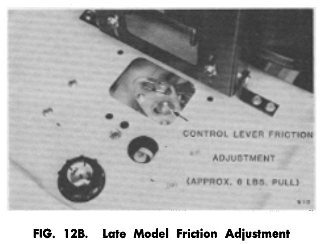

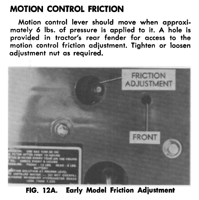

69 fury 11 #5 Posted April 11, 2017 thanks guys. real good info. i mowed today using the belt that was on mower.did a nice job. i will give TORO a call and see if they have belt in stock. one other question, do i have to hold forward &reverse lever as i am driving this WH? if i let go of lever it slows down and stops. got one hand on wheel and one on stick. Share this post Link to post Share on other sites
gwest_ca-(File Mod) 12,460 #6 Posted April 11, 2017 This starts on page 12 of this manual Garry Share this post Link to post Share on other sites
