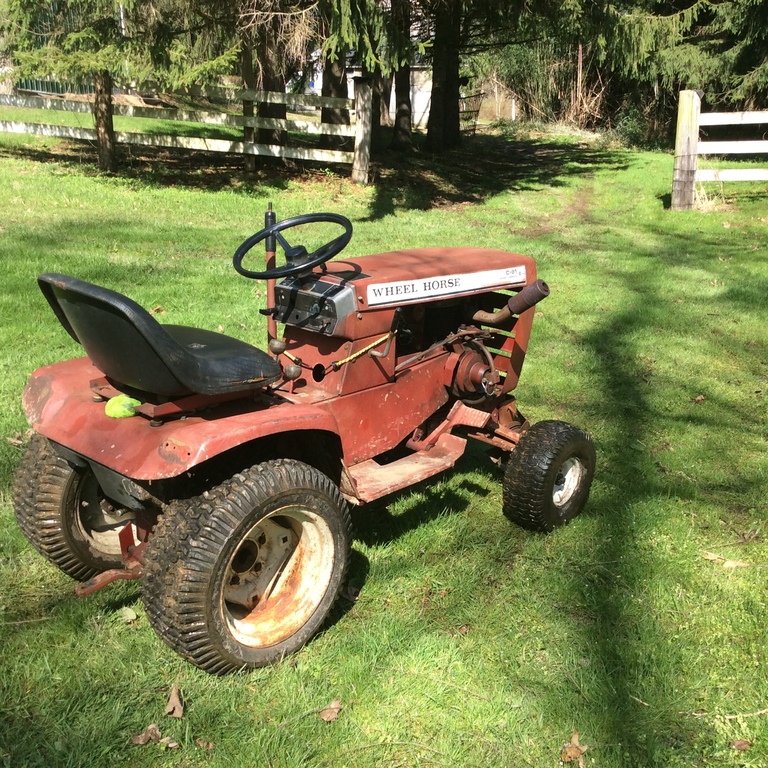

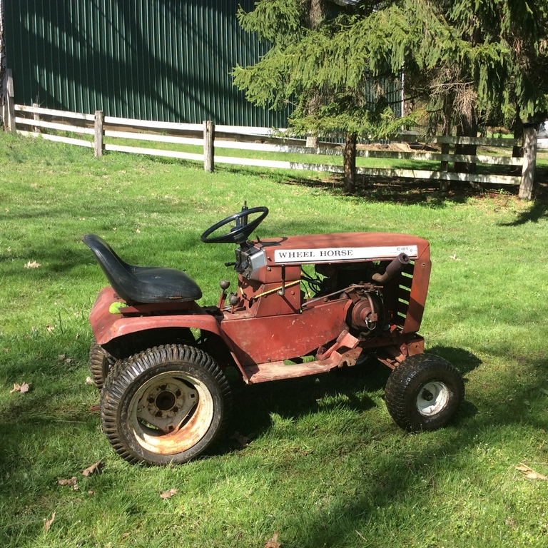

12 hp Kohler 1,020 #1 Posted April 10, 2017 I have a wheel horse c-81 with an 8hp engine and a 8 speed transmission. I am wondering how many pounds you giys think it can carry, so far the heaviest I think it has caried is about a 250 pounds not in a trailer. Let me know what you giys think because I would be very interested in knowing 1 Share this post Link to post Share on other sites

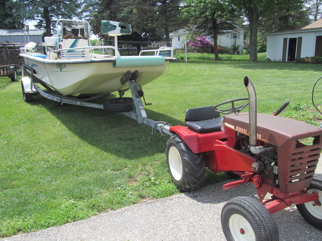

Blasterdad 3,168 #4 Posted April 10, 2017 I have used the same tractor to move a 23' Starcraft I/O...(not this one but one just like it). Guessing 2000 lbs. at the least. 2 Share this post Link to post Share on other sites

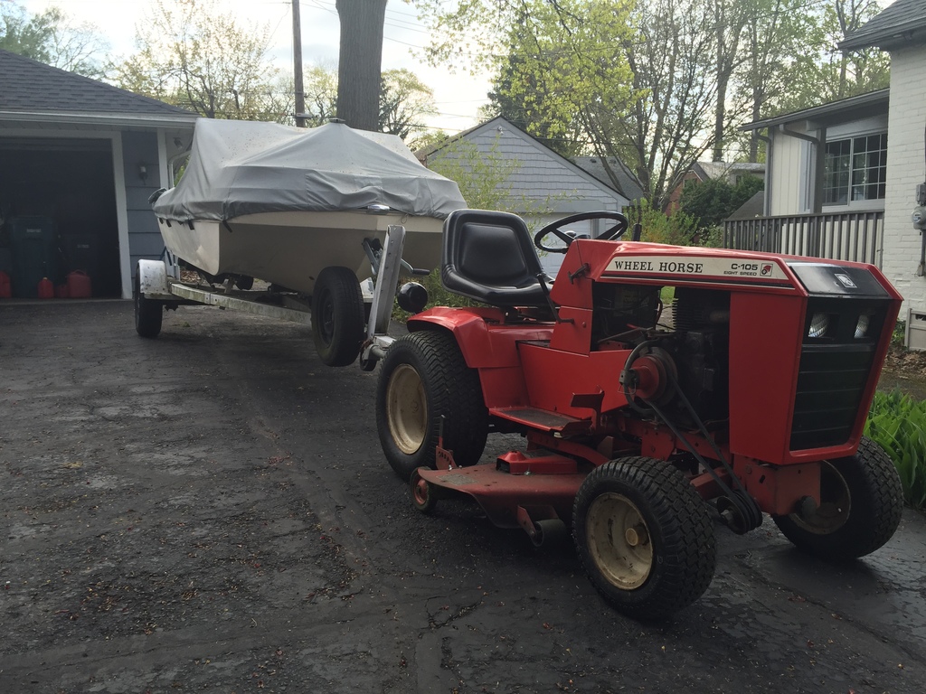

SylvanLakeWH 32,823 #7 Posted April 10, 2017 My C-105 routinely pulls this around... 1 Share this post Link to post Share on other sites

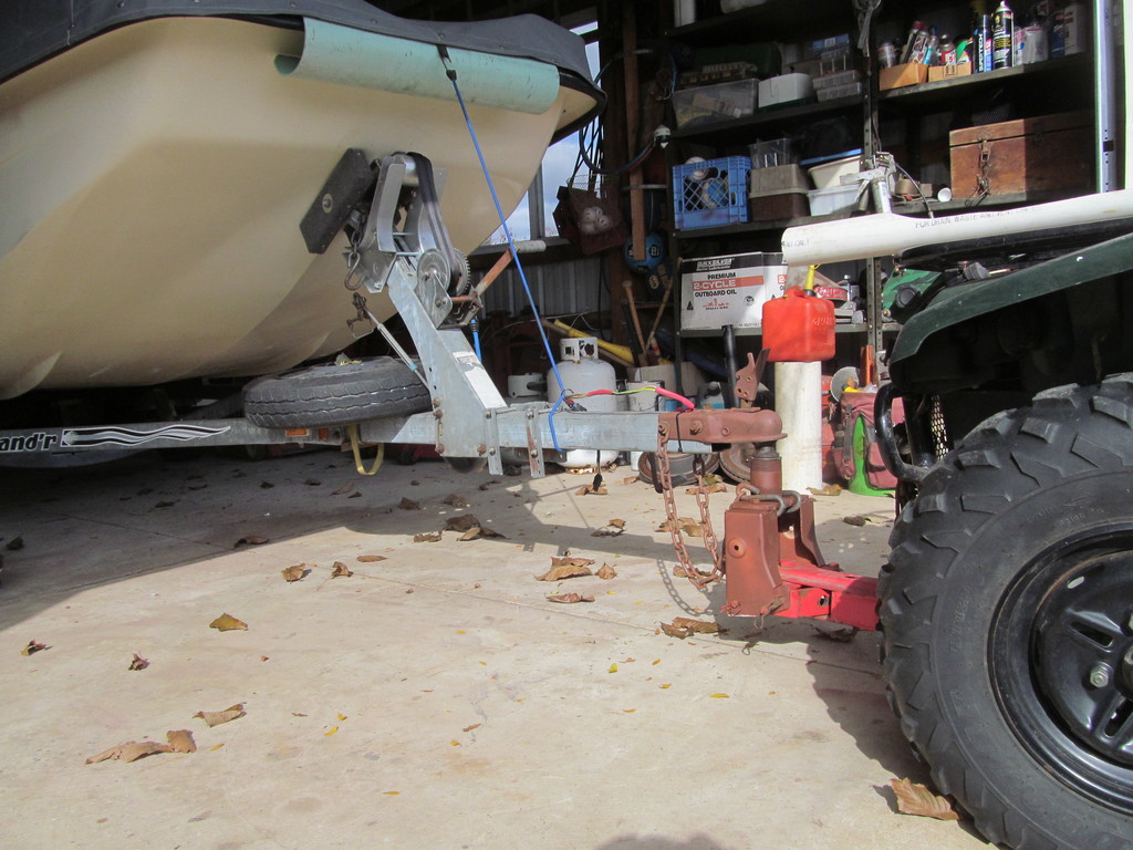

Ed Kennell 47,818 #11 Posted April 11, 2017 We all probably move heavier loads than these little tractors are designed for on level ground. Just be aware they are very quick to do a back flip if the trailer encounters any obstruction. Never try to move a trailer that is heavier than the tractor down or up a hill. If you do don't forget to tell the cameraman. Hold my beer and watch this. I actually like to move trailers with the hitch on the front. It's much easier to push them into a tight space and there are no back flips. 4 Share this post Link to post Share on other sites

Ed Kennell 47,818 #14 Posted April 11, 2017 Yep, I didn't have a cameraman to hold my beer, but while slowly pulling a 2000# boat out of the level concrete garage with the 8HP in 1st gear, the trailer wheel hit a piece of 2X4 that I didn't see and before I could push the clutch, the Commando 8 was vertical and I was horizontal under the boat. 4 Share this post Link to post Share on other sites
