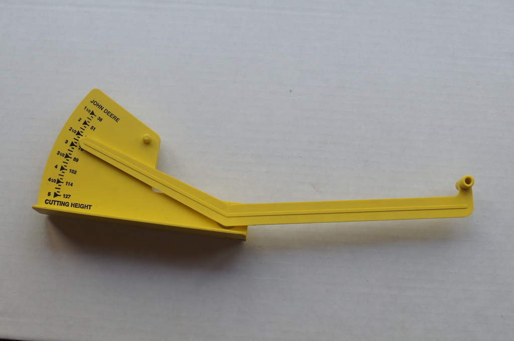

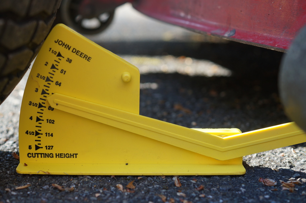

shallowwatersailor 3,221 #17 Posted April 18, 2017 I have mentioned this before on other mower deck issues. The best tool that I have found - and easiest to use - is this sold by Sten, JD, etc. It beats trying to measure blocks, etc when setting/checking blade height. You can easily tell if a wrong spindle has been installed. I only wish that the Cutting Height was on both sides. But I guess, now that I mention it, I could do that myself. 3 Share this post Link to post Share on other sites

scoob8000 29 #22 Posted April 19, 2017 Shallowwater, That's a handy tool. I just ordered one. Way easier than my block of wood or TP tubes. Smoreau, This 42" deck is very solid, and damned near mint condition. I've replaced all the bearings in the spindles and didn't notice any cracks. My 48" on the other hand from the parts mower was a mess. I spent hours welding on it to get it right. It's solid now, but trying to keep some use off of it since I know those repairs I made won't last forever. I start one of these threads every year in the hopes of finding something new that I missed. I hate to throw more money on it, but I think my next step is going to be new rollers on the front and replace some of the adjusting linkage parts. Share this post Link to post Share on other sites

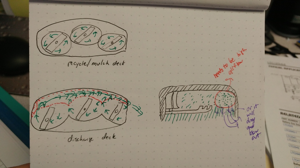

bmsgaffer 2,071 #24 Posted April 19, 2017 I will put money on the gator blades being the problem. I have had a big run around with them and here is the scoop. People will argue with me on this, and you will have varying levels of success on different decks, but here is what I have learned. The gator blades work amazingly well on any machine that is intended to mulch (our standard SD decks are not). If you put them on a discharge deck, they will severely disappoint. The reason is that those "tails" that are cut into it lower the volume of air that is moved by the blade and also makes it more turbulent. This is good for mulching decks because it lets the grass drop back down into the blade and be cut again before dumping. Side discharge decks don't have tight baffles to make sure this happens correctly. Your deck doesn't have enough airflow to keep the grass suspended in the 'jet stream' that is exiting out the chute so it drops and blows out from under the front (the path of least resistance since you are cutting high) Same thing with worn blades. Many people dont realize that your blades wing-tips wear down too over time and will perform worse and worse as the airflow drops. See my terrible diagrams below. Green on the left side is air/grass flow and compares mulching deck to our decks. RIght side shows a side view of our decks with the green grass clippings and purple is what happens when there is low airflow. Also not shown well in that picture is that the purple direction will only happen with the front edge of the deck is higher off the grass, if you used the mulching blades and kept your cut down low, the grass itself would act as a baffle and the blow-out would occur much less. I learned all this the hard way on both a WH deck and a professional walk behind unit that I have. 3 Share this post Link to post Share on other sites
Ed Kennell 47,015 #25 Posted April 19, 2017 Good explanation Brandon. I have never used mulching blades, but it surely seems logical. 1 Share this post Link to post Share on other sites
