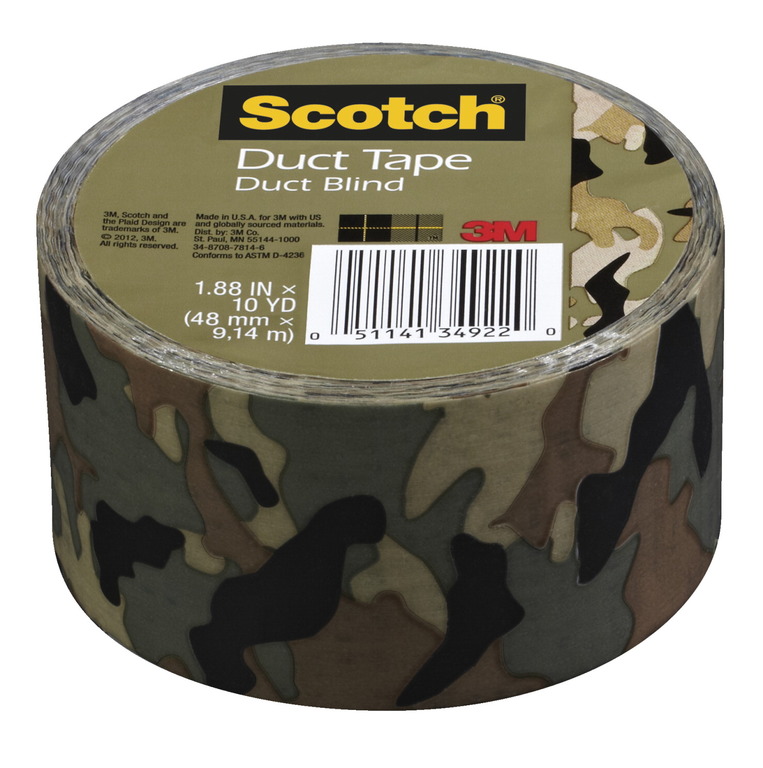

Ed Kennell 47,754 #6 Posted April 10, 2017 You could always do the "redneck" fix. 3 Share this post Link to post Share on other sites
WHX?? 58,330 #7 Posted April 10, 2017 Make mine camo 2 Share this post Link to post Share on other sites
