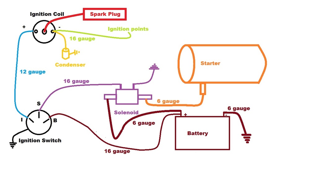

953 nut 69,558 #2 Posted April 9, 2017 As your topic title reads 181S I presume you have an electric starter and therefore have a battery. With that in mind it would be less expensive and more dependable if you were to go to an automotive coil with an external ignition resister or a coil with an internal resister and ditch the Mag. The ignition switch would need to be changed out too. Take a look at these drawings. 1 Share this post Link to post Share on other sites
briankd 833 #3 Posted April 9, 2017 yea i thought about that also by the time i buy a automotive coil, ign. switch and rewire it bout the same boat im in now. this thing lasted 40 years like to keep it original. have an old WH dealer with a shed full of parts try to see if i can make it there this week to see what he has. always fun to visit him he has a 60 by 80 2 story building cramp packed with WH and every engine parts imaginable. almost get lost in there looking at stuff. thought someone know what these coils run so i know what to ask him Share this post Link to post Share on other sites
