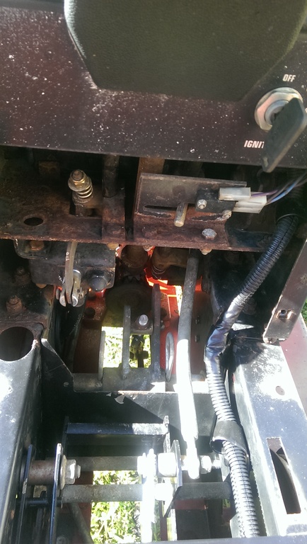

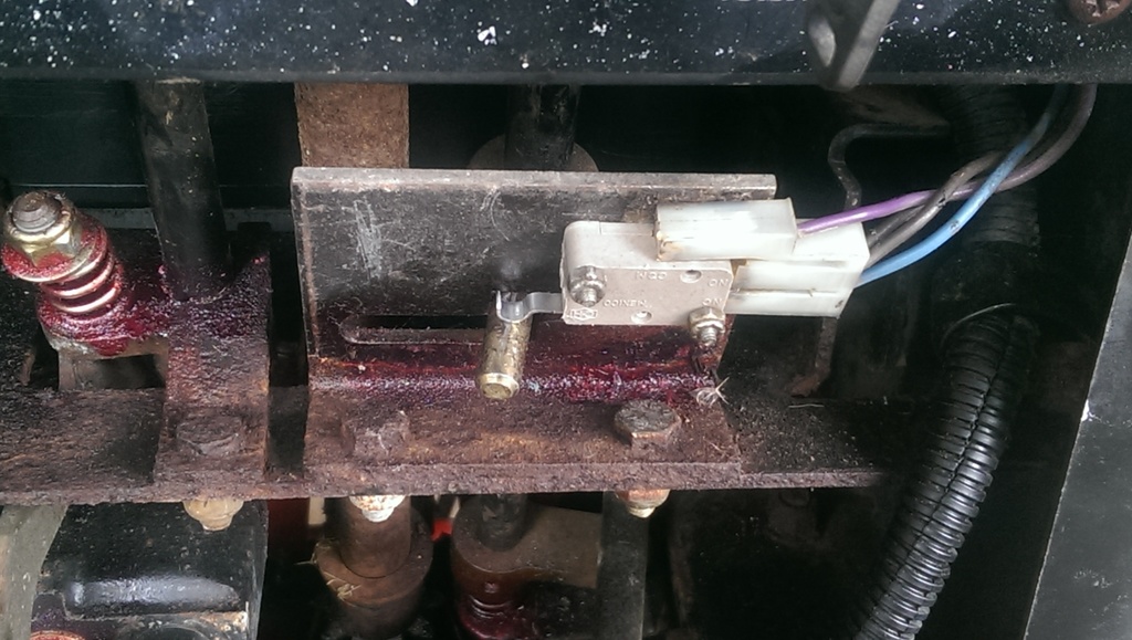

WVHillbilly520H 10,378 #19 Posted April 11, 2017 Check a couple of the safety switches IE the neutral under the steering wheel PTO and seat, the "Good Friday" 520 I picked up last year would start without a jumper either till I finally tracked it down to the neutral switch which BTW was technically working just missing the actuator arm, Jeff. 1st pic missing arm 2cd new switch. 2 Share this post Link to post Share on other sites

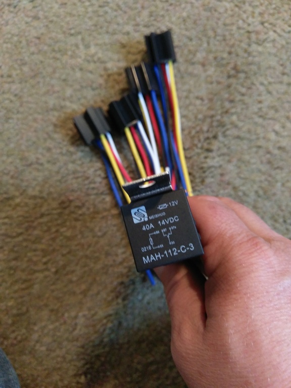

Duramax7man7 506 #21 Posted April 11, 2017 Looks like AR272 is the replacement number for these relays for anyone looking to replace them. They can be purchased at most auto parts stores and I believe they called them "multi-function relays"... $12 Share this post Link to post Share on other sites
WVHillbilly520H 10,378 #22 Posted April 11, 2017 Those relays are pretty much generic, take an old with you to a parts store (NAPA) and they should hook you up cheaper than Toro, that's what I do, Jeff. 3 Share this post Link to post Share on other sites
Duramax7man7 506 #23 Posted April 11, 2017 1 hour ago, WVHillbilly520H said: Those relays are pretty much generic, take an old with you to a parts store (NAPA) and they should hook you up cheaper than Toro, that's what I do, Jeff. Roger that! DONE!!! 3 for $12 and they come with a metal mounting bracket and a plug shroud! They are used on one of the most successful mowers that I've heard of. Dixie Choppers! All day long! 2 Share this post Link to post Share on other sites
