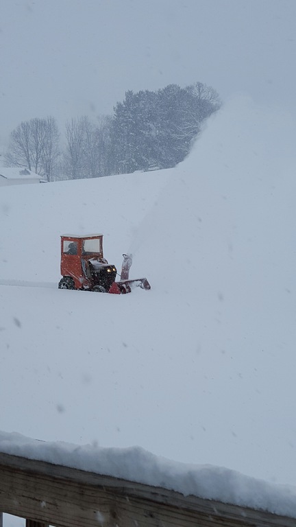

TDF5G 2,074 #11 Posted April 7, 2017 Turfs, chains, and weights for me also. It's seems the more weight, the more you can push. Chains will tear up asphalt if you spin much, have to keep it to a minimum. I think it may depend on the quality of the asphalt also. Share this post Link to post Share on other sites
