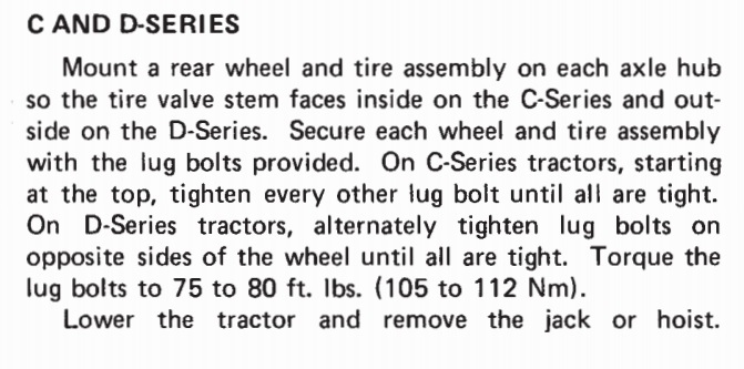

23 Reo 235 #1 Posted April 4, 2017 What is the proper torque for the rear wheels? Share this post Link to post Share on other sites
gwest_ca-(File Mod) 12,283 #2 Posted April 5, 2017 Found this in the 1978-79 B, C and D-Series service manual. The C-Series use 7/16 fine thread studs. I don't know if the D-Series are the same size. Garry 4 Share this post Link to post Share on other sites
