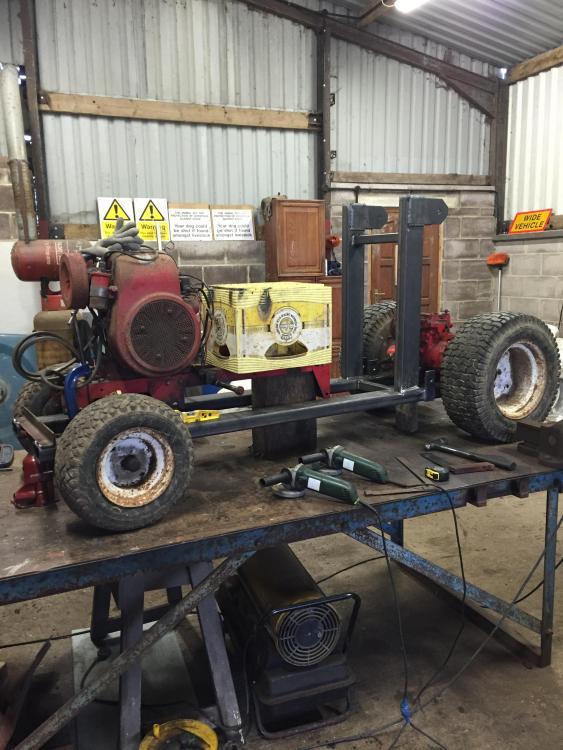

farmer 1,081 #53 Posted April 10, 2017 As Dennis seems very concerned as to where his backside goes I'd like to clarify,.. it's not behind the steering axle, and at the same time point out that, other than a small amount of cosmetic detailing, the LS carries no ballast or counter weights. Looking at the 'honey bee' I can't spot a steering wheel either, maybe it was autonomous. 5 Share this post Link to post Share on other sites

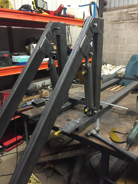

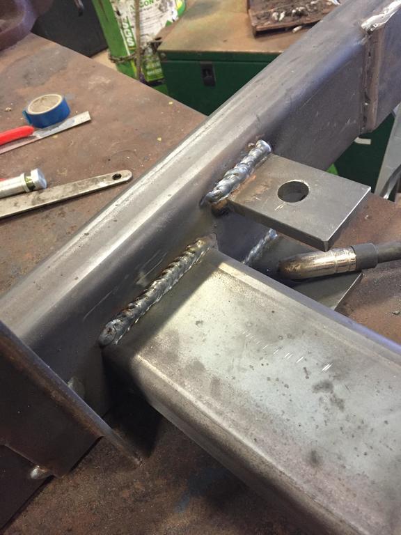

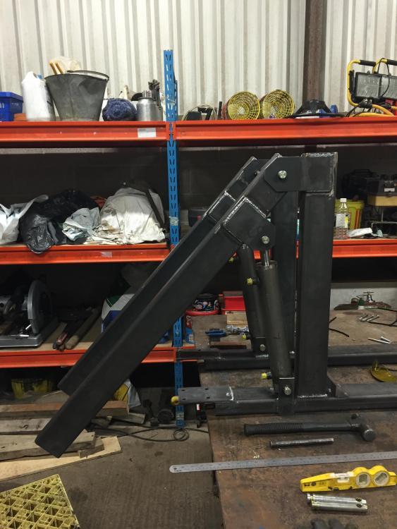

farmer 1,081 #55 Posted April 10, 2017 (edited) I have followed quite a few of the projects in this section of Redsquare and notice that many contributors name their creations, having given it some thought I've settled on 12 Automatic ILS (Industrial loading shovel) as I think this may have been how wheel horse would possibly have badged it. That is of course, if they had ever produced such a thing! Also one other thing that I failed to explain as a reason for building a ILS and not a FEL. Many members on RS have FEL's on their tractors and rarely if ever take them off, and with four other tractors myself I'd do the same. So sacrificing a tractor to be a purpose build loading machine made sense to me. Anywho in tonight's brief episode....welding the subframe towers and boom. Boom pivot plates at the top of the towers. bottom of of the towers and the bottom lift ram mount. This picture shows the driving axle lower clamp plates. (the angle was spot welded on the subframe to maintain square, later removed) And another view of the same. Back to the tractor tomorrow, Thanks for following along. Edited April 10, 2017 by farmer 12 Share this post Link to post Share on other sites

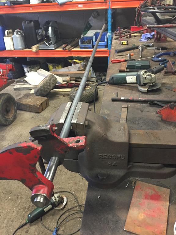

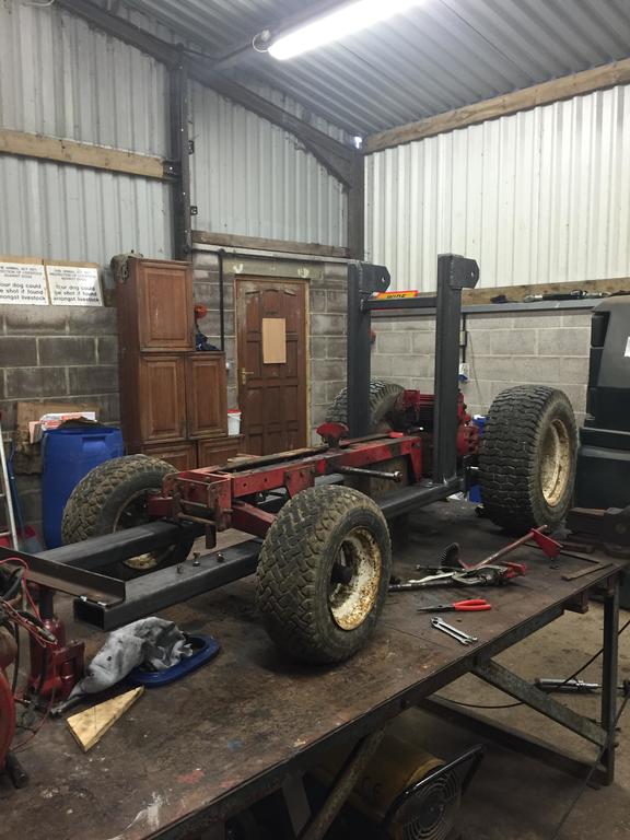

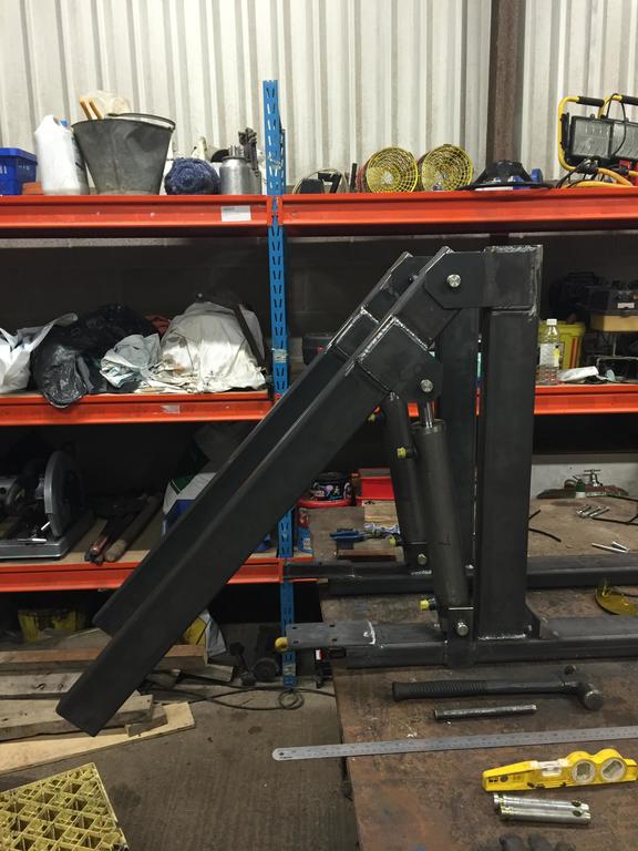

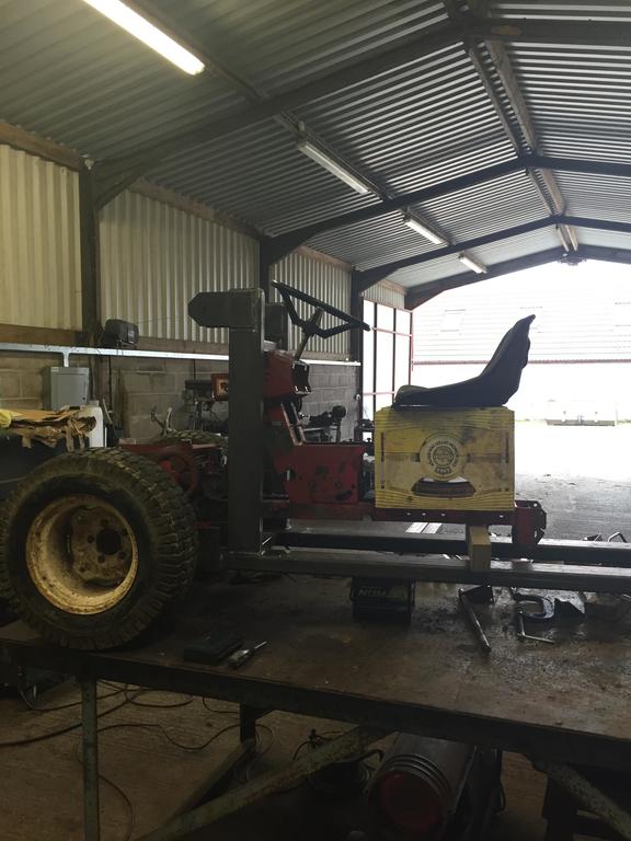

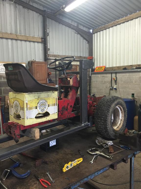

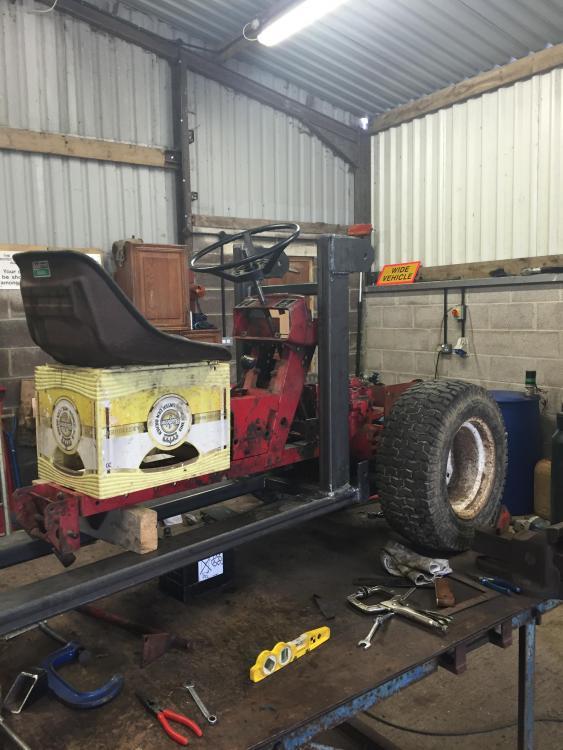

farmer 1,081 #58 Posted April 11, 2017 (edited) As Dennis's rear end needs questions answered , it will be part of tonight's 'instalment', first however,.... Hello Mark, how's it going up in the frozen north?, way to make me not feel guilty,...thanks. Maybe I'll change my username to Dark horse. And ohiofarmer, your experiences are all to common, doesn't matter where you live, I think they call it 'progress'. Right now though iiittttsssss loader time, with the help of the cat, (I love my cat) I swopped the subframe for the tractor on the bench and then promptly stripped it down to axles, frame and engine, having already done a bit of measuring. I split the frame from the transmission, blocked it up then wrestled the subframe back into place, first seat mock up But with nothing to go from, steering wheel wise. And the engine was a pita so I got rid of that. l placed the whole steering unit in place. And of course because it's a it slotted right in. So, bearing in mind I wanted to keep the wheel base as short as possible the first thing to work out was the position of the fan gear for the steering. This means lengthening the steering wheel shaft so I wasn't banging my hands against the loader towers. Adding a seat on the beer crate made it more... comfortable. A picture from the other side, and I felt I was on the right track. The bit of measuring I did earlier, (before tearing the tractor to pieces) involved the placement of the transmission belt idler. I would have to replicate this...so I did. It is removable, you just have to separate the tractor frame from the subframe to get clearance. Tomorrow we'll touch on steering and tractor frame. Edited April 11, 2017 by farmer 7 Share this post Link to post Share on other sites

roadapples 6,986 #63 Posted April 12, 2017 You`re gonna` sit on the fuel tank ?... Share this post Link to post Share on other sites
farmer 1,081 #64 Posted April 12, 2017 Give that man a ceeeeegar ! 1 Share this post Link to post Share on other sites

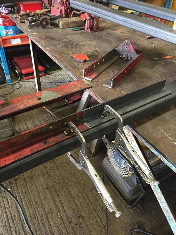

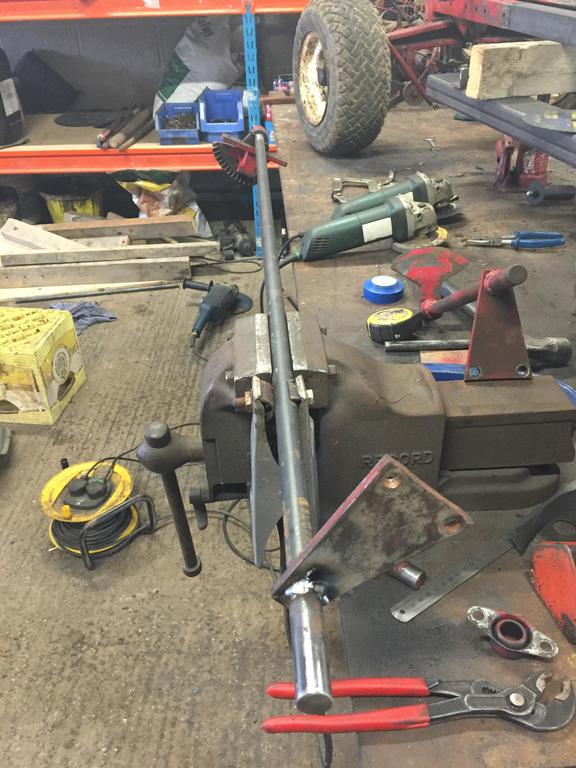

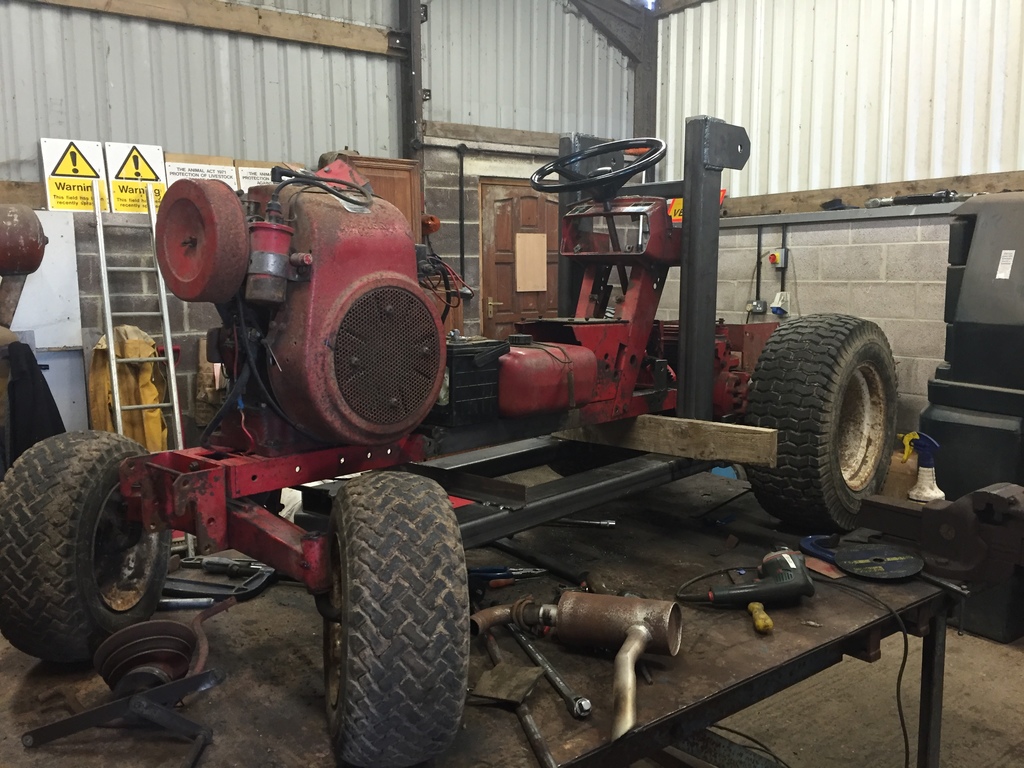

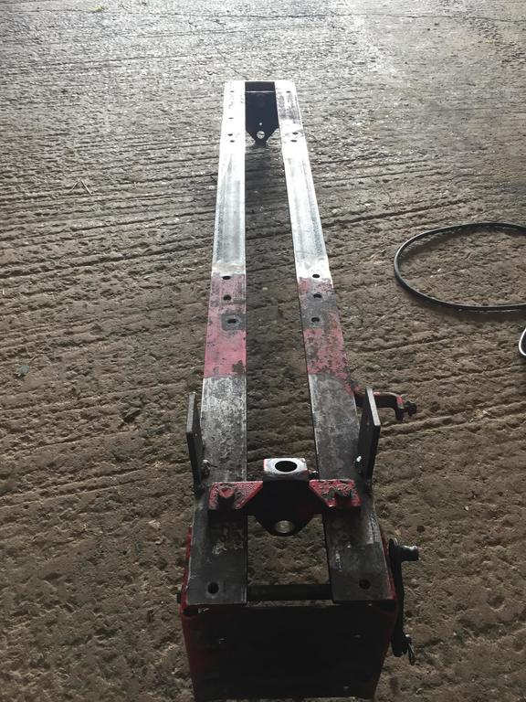

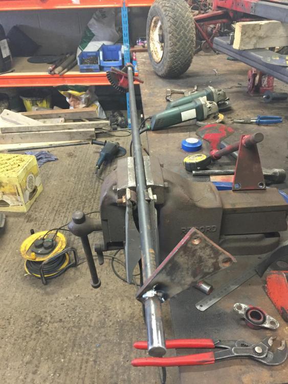

farmer 1,081 #65 Posted April 12, 2017 Time to get serious with the frame and steering, having made the belt idler carrier I thought l could squeeze the steering fan gear between it and the transmission. This is tight because I have to make something for motion control to slot in there as well, as I said though if I want to keep the wheelbase down it's the only way. Decision made, I could work backwards down the frame with the final position of the steering console and seat, I had to have a home for the fuel tank and battery, so figured under the seat made most sense. Leaving a bit of wriggle room we arrive at the engine. Measurements done I worked out I would need to add 440mm to the length of the frame. With the new frame parts cut to length, it all got clamped down to a steel and welded up. (I know I took this picture as l did this but when I look at it now it doesn't make sense) ?? Anywho, moving on.... The frames length to the steering axle showing fan gear mount. Speaking of the fan gear I suspect you've worked out how this now operates..... with the fan gear cut off from its original shaft and mounted on a new 'slightly' longer one, the drive now goes ' out the back' effectively reversing the steering. With the new longer frame, it's a case of measuring and cutting the new longer steering rod to fit, and at the same time welding the tie rod linking piece in its correct position. ( having already cut it from the original rod) The steering link leaning against the vice is from my commando 8 (which is still awaiting restoration) it illustrates the difference in length. Enough from me... I'll be back tomorrow. 6 Share this post Link to post Share on other sites
farmer 1,081 #66 Posted April 13, 2017 In the clear light of morning, after spending far to long staring at this pigging picture, l've worked it out..... It's an optical illusion,..duh, I could only see the frame clamped horizontally, whereas in reality it's clamped vertically. (couldn't workout how the lengths were different and how the angle iron had turned!!) Getting older is a b#tch sometimes. I find myself mumbling away to no one in particular about nothing in particu........... ........ ... Tonight I think it's gonna be about fuel tanks, batteries and Dennis's butt again. 2 Share this post Link to post Share on other sites

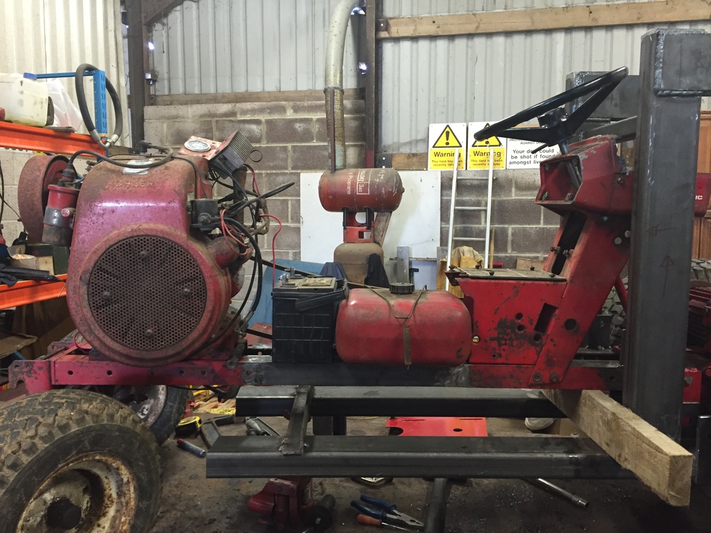

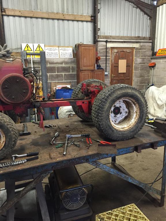

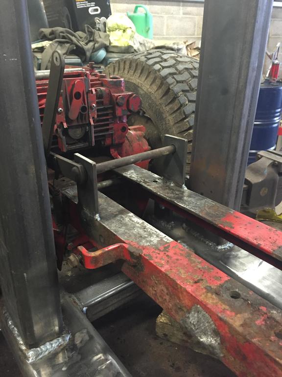

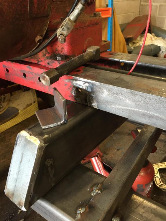

farmer 1,081 #71 Posted April 13, 2017 'The operators seat' won't be in tonight's instalment, (getting a little ahead of myself) instead we look at fuel tank, battery and linking the subframe to the tractor frame. with the the new extended tractor frame bolted up to drive axle, steering laid in and working, engine back on, its fuel tank time. The tractor had a good one so I wanted to use it, couple of issues here however. 1/ It could not be mounted square on the frame because the fuel line would be directly inline with the steering rod underneath. 2/ It had to be offset on the frame to allow clearance for the transmission belt to pass. Luckily, by moving it a few cm's to the right both problems were solved, the fuel line now passes between steering rod and right hand frame rail, and belt clearance is good. Standard size battery sits 'east west' on the frame where the cables can be hooked up as before. This picture shows the appropriate layout. I also planned to use the fuel tanks wire and spring to secure it. Also you can see the need to lengthen the steering wheel shaft. While on the bench and in this position it's time to take measurements to attach the subframe to the tractors frame. As the distance between the two frames was just short of 200mm my choice of steels was the same 200x50x5mm box as before. Two pieces cut with a nice angle to hopefully make it look less 'boxy'. I then welded caps on them ready to.... ....show them up between the two frames. So remember the measurement was less than 200mm? I cut two slots into these two cross members to allow the subframe to come up. The slots effectively allowing the tractor frame to fit down in the cross members. Four small pieces of angle were clamped to the tractor frame drilled and bolted through. Then the subframe lifted up trapping the cross members into the frame above, where I could weld the angle pieces to the cross members. The excess length of the subframe was cut off, and the ends capped. Leaving me with this as the 'finished product'. Remove four bolts and the two frame can be parted. The picture probably explains what I mean clearer!! Anywho it's time for me hot chocolate. 3 Share this post Link to post Share on other sites
DennisThornton 4,772 #72 Posted April 14, 2017 (edited) Pretty darned neat even without the seat! But I spy something in the background that is distracting me. Propane tank, another tank and a vent to outdoors. ? Edited April 14, 2017 by DennisThornton 1 Share this post Link to post Share on other sites

farmer 1,081 #74 Posted April 14, 2017 (edited) Morning Dennis, well at least we've moved on from your rear, In the background you see a crude workshop woodburner (the horizontal tank is a heat exchanger). Whx11, so your theory is because I struggled to get a steering wheel off, I went on to build this thing, having had a weird dream......yeah......right....ok, you sound as unhinged as me, you'll fit right in, welcome aboard! Definitely doing the seat tonight. Edited April 14, 2017 by farmer 6 Share this post Link to post Share on other sites

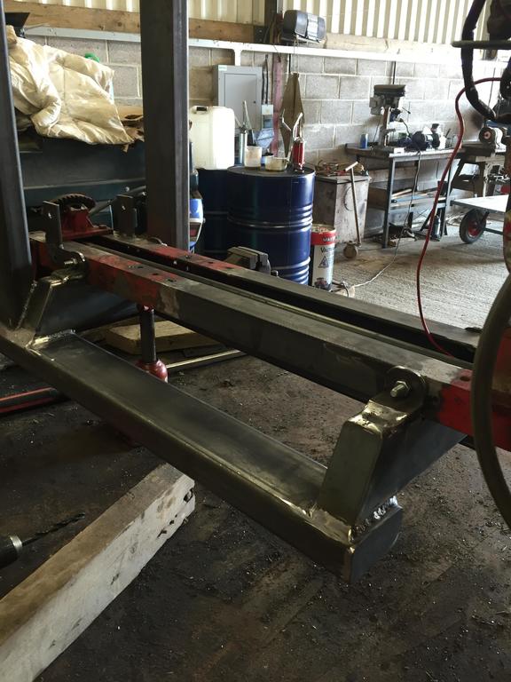

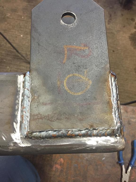

Lee1977 7,519 #75 Posted April 14, 2017 I see you have four bolts holding the subframe to the tractor frame. I also saw where you had the four bolt holes to attach to the transmission housing in each subframe plate. I would add a heavy plate gusset and cap on the subframe under that attachment plate. 1 Share this post Link to post Share on other sites
