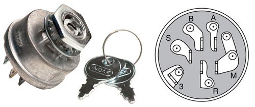

handyrandy 7 #1 Posted April 4, 2017 I bought another 312-8 last week to mow my family's grass at the home place, and I am working the bugs out of it. One bug is that it wont shut off when I turn the key to off. I first thought it was the ignition switch but it checks out with the meter. However the black wire that attaches to the ground lug on the ignition switch is not grounded to the frame for some reason. Could this be the problem? Thanks! Randy BriansWiringDiagram.jpg-original 103991backterms.gif-original 2 Share this post Link to post Share on other sites

handyrandy 7 #5 Posted April 4, 2017 Oddly enough, although the lug is right against the switch case there is no continuity. How two pieces of metal could be touching and not connected is strange. Another oddity I found is all the new replacement switches I have found have the ground lug marked as a 3 instead of a G in the product photo. Thanks for the replys. Share this post Link to post Share on other sites
