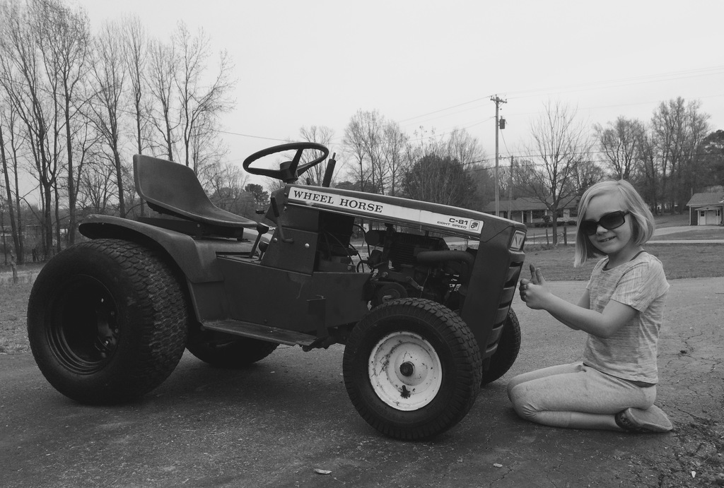

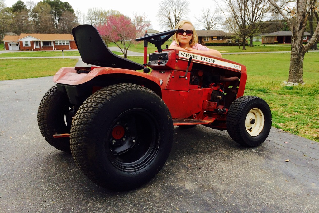

Amcwheel85 2,060 #1 Posted April 2, 2017 (edited) Well guys I've had a look in my head for awhile how I wanted my daughters C81(Rosie) to look like and after I got the wife rear wheels off the 520 I decided to try and flop Axle upside down to lower the front... now idk if I'm gonna keep it like this but if it holds up I will.. this tractor is just meant too look cool and cruise. I do know some of the pros and cons of having this setup. For now it's just an experiment. My daughter loves it! P.S the front tires are not bowed in, the tractor always has been toed out so it just makes it look like that in a few pics Edited April 2, 2017 by Amcwheel85 11 Share this post Link to post Share on other sites
elcamino/wheelhorse 9,363 #2 Posted April 2, 2017 I think you have a Puller in her future. Nice set up. great pictures. 1 Share this post Link to post Share on other sites
953 nut 70,338 #3 Posted April 3, 2017 Calendar shot for sure! Your daughter and her tractor are both displaying a lot of attitude here. 2 Share this post Link to post Share on other sites

rmaynard 17,644 #5 Posted April 3, 2017 Only thing I'd be concerned about is with the angle of the frame allowing the engine to pitch forward, you may have a lubrication problem. 2 Share this post Link to post Share on other sites
Amcwheel85 2,060 #6 Posted April 3, 2017 I thought of that, but I like this look so much I may take it to a fabricator shop and have another axle custom built or maybe put smaller back tires on it.. just in stage 1 and I'm not a custom builder so doing my best. I will figure it out tho.. 1 Share this post Link to post Share on other sites
rmaynard 17,644 #7 Posted April 3, 2017 You might want to consider a custom engine mounting plate to level it up. 3 Share this post Link to post Share on other sites
Amcwheel85 2,060 #8 Posted April 3, 2017 Could I have some custom engine mounts to level engine alil? And do they make a sweet street drag car tire in a 20-12-12?? Lol that would lower rear 2-3 inches 1 Share this post Link to post Share on other sites

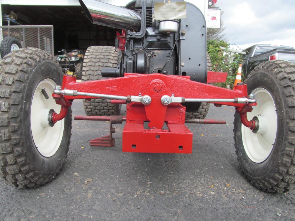

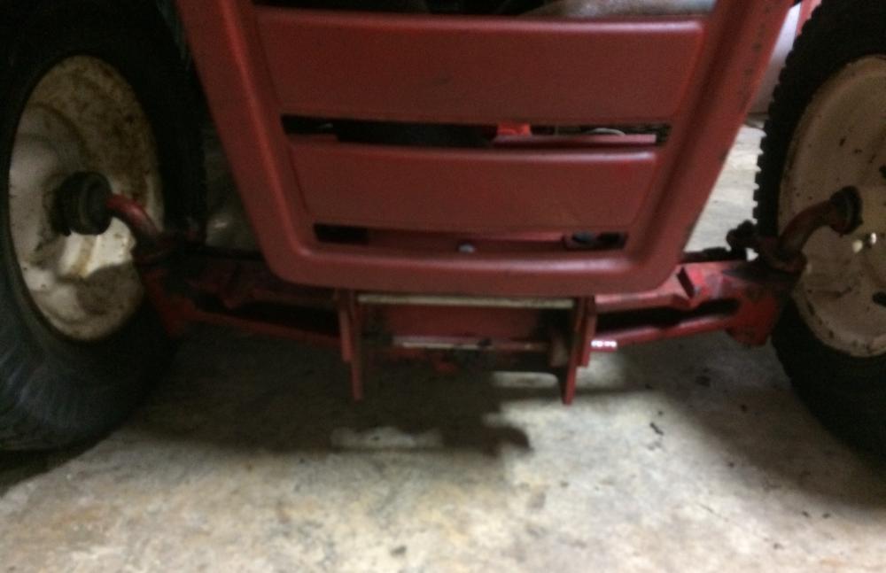

Ed Kennell 47,818 #22 Posted April 3, 2017 Looks Kool. Do you have any detail pics of the spindle and tie rods? I had to make some changes to get the low rider frame down where I wanted it. 5 Share this post Link to post Share on other sites
Amcwheel85 2,060 #23 Posted April 3, 2017 Best I could do in the garage. Hope this works ed. Share this post Link to post Share on other sites
Ed Kennell 47,818 #24 Posted April 3, 2017 Thanks, that's what I was thinking you did. Do you think the spindle C clips will hold up OK under the load? 2 Share this post Link to post Share on other sites
Amcwheel85 2,060 #25 Posted April 3, 2017 (edited) Thought about that too! May look into thicker clips if I feel I'm gonna have a problem. Also starter needs replaced so it will be awhile before she actually get ran around so I have time to figure this out and modify it... Also being small engine plus not having pto pulley on engine it is kinda light in the front so that helps alil! Edited April 3, 2017 by Amcwheel85 3 Share this post Link to post Share on other sites
