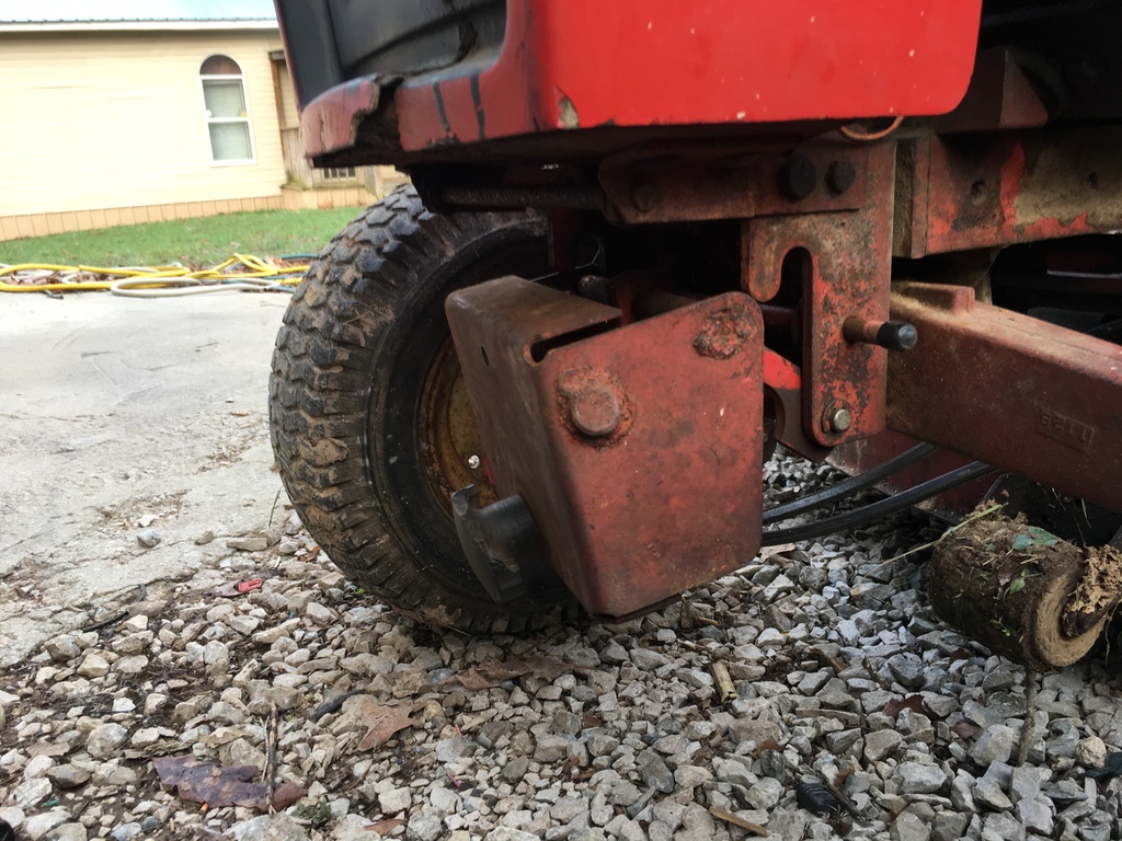

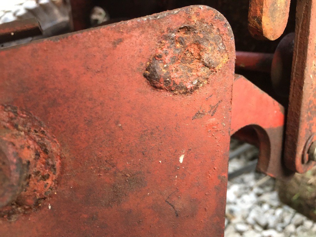

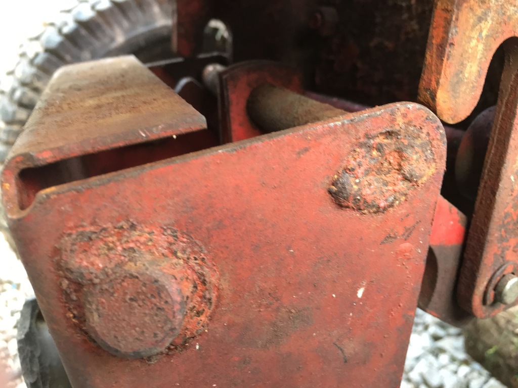

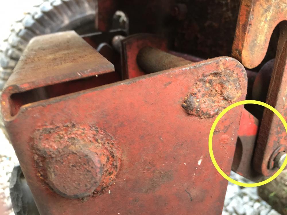

T-Mo-(Moderator) 4,890 #1 Posted April 2, 2017 I messed around with the '79 C-161 Twin Friday, mowing the back lot, when the blades stopped turning. I drove it back into the garage and yesterday I had time to take a look at it. Hmm, something appears just quite not right here. Can you see, other than the fact the mule drive is just hanging on one side? It shouldn't surprise me none, since other "improvements" that the previous owner made has to be corrected. Share this post Link to post Share on other sites
rmaynard 17,432 #2 Posted April 2, 2017 Latch is assembled backward. 4 Share this post Link to post Share on other sites
gwest_ca-(File Mod) 12,362 #3 Posted April 2, 2017 It's on the wrong side of the fence. Garry 2 Share this post Link to post Share on other sites
T-Mo-(Moderator) 4,890 #4 Posted April 2, 2017 Yep, absolutely. Both Bob and Garry nailed it. Unfortunately the PO didn't "nailed it" when he reinstalled it. Definitely won't stay latched in that position. No wonder the blades stopped turning when the mule drive won't stay in place. It's amazing how some owners put things back together after taking things apart. 1 Share this post Link to post Share on other sites

T-Mo-(Moderator) 4,890 #8 Posted April 3, 2017 Fixed it yesterday. It's now installed properly. Now to reroute the fuel line and relocate the fuel shut off the PO installed. Share this post Link to post Share on other sites
