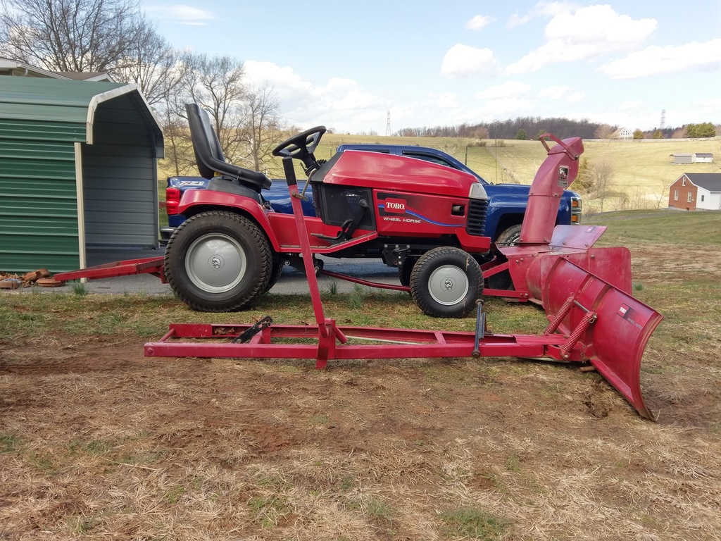

1987_WHEEHORSE312 95 #10 Posted February 2 Can you raise and lower the hitch separate from any other implements? For example if I have a scraper blade on the rear and a blower on the front, I want to be able to back up to areas and use the back blade to pull the snow away from stuff like my garage and then spin around and hit it with the blower. Share this post Link to post Share on other sites
Ed Kennell 47,587 #11 Posted February 2 6 minutes ago, 1987_WHEEHORSE312 said: Can you raise and lower the hitch separate from any other implements? Nope. You can add another lift system for the back blade...like a small 12v. winch. Share this post Link to post Share on other sites
1987_WHEEHORSE312 95 #12 Posted February 2 Ahh got ya thanks! Share this post Link to post Share on other sites
