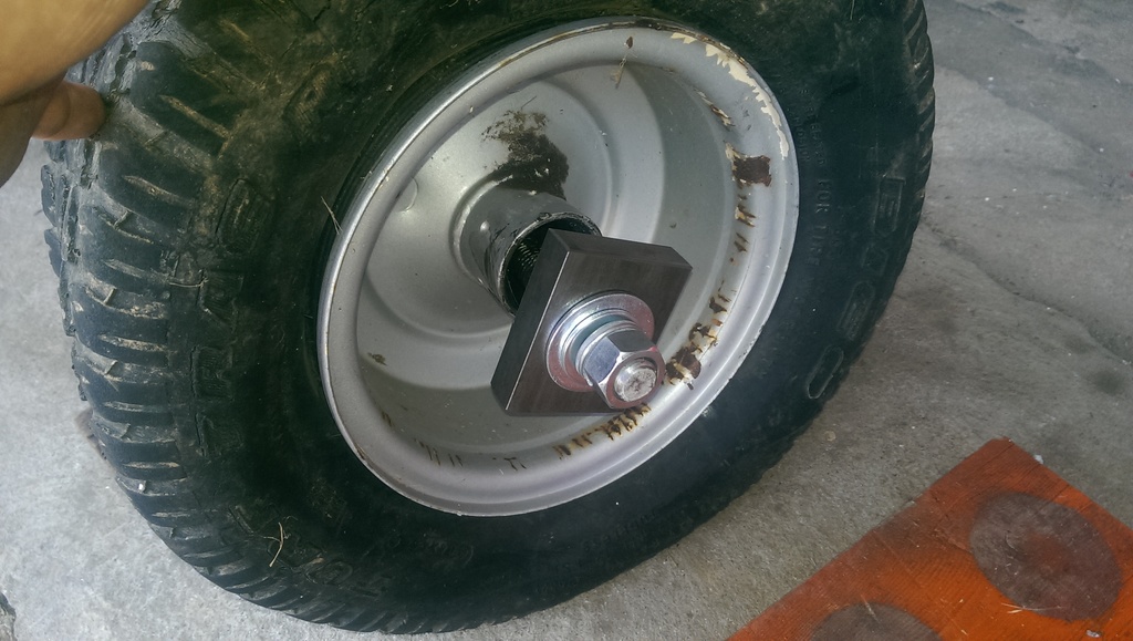

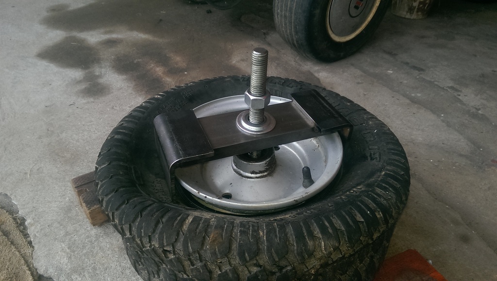

WVHillbilly520H 10,378 #4 Posted March 30, 2017 I made this it works perfectly for my 8" wheels, even though I should have made it adjustable, Jeff. 6 Share this post Link to post Share on other sites
