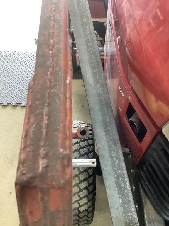

Pullstart 71,567 #204 Posted April 8, 2021 @Tractorhead it might need just a little trim job! 1 Share this post Link to post Share on other sites

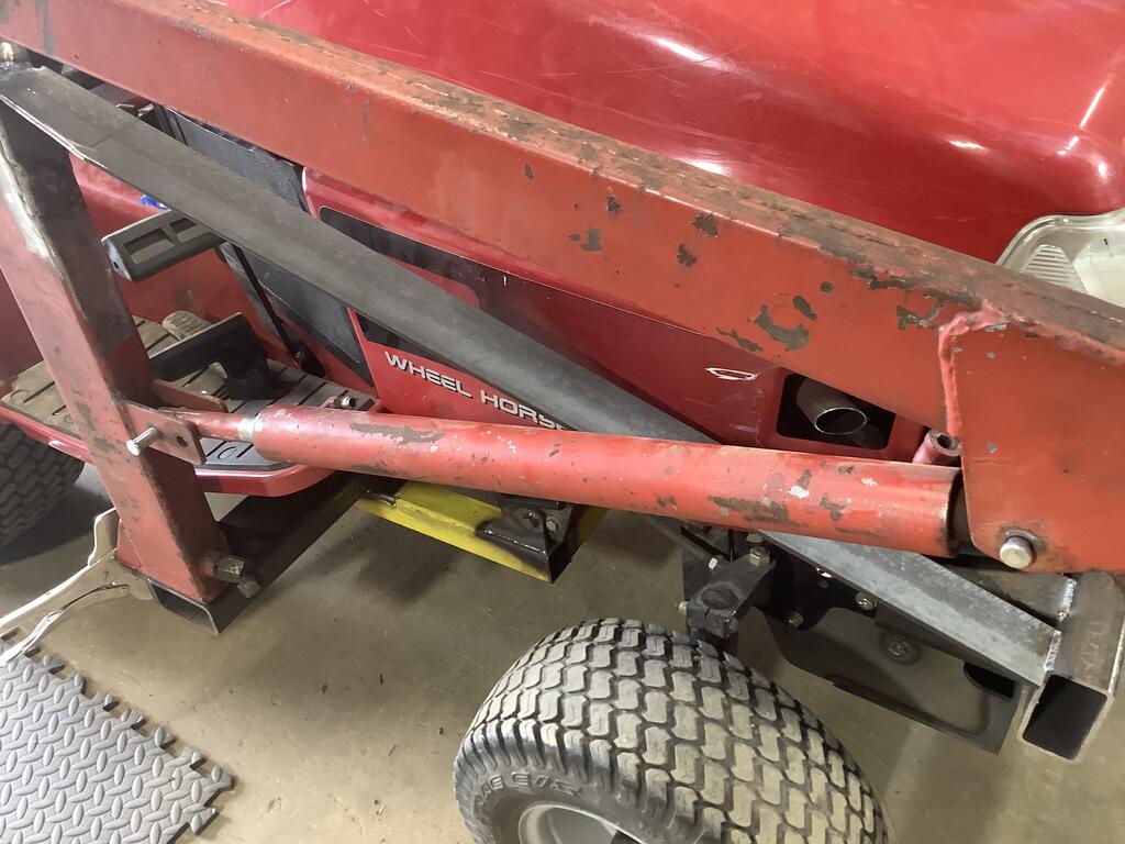

Tractorhead 9,218 #205 Posted April 8, 2021 Ok, so it seems maybe an optical illusion on the Picts, it appears on the picts to me to be much closer. I would Test it also with manually lifted FEL maybe with forklift up to max. Liftheight and check the gap to the cylindre. I see on my FEL with heavier load in the Bucket that sometimes a little bigger dynamic from side to side movement is happen. I agree to that, because Things they can move a little they don‘t crack that fast. i just like you be prepared ahead, than after all the work you made and things must be cutout after. It’s just a suggestion of my own learning curve. Btw. Great Job on that rework - no doubt. 1 Share this post Link to post Share on other sites
KrazeyOlDave 860 #206 Posted April 8, 2021 Cross bar would be a personal preference imo, never been a fan of them due to my eye sight sucks as is 😂 What’s the wall thickness on your main arms? Because I’m seeing a pretty large bucket on the front...you’ll have to be very careful with that amount of weight when up high...she’ll fold over like an accordion. 😬 1 Share this post Link to post Share on other sites

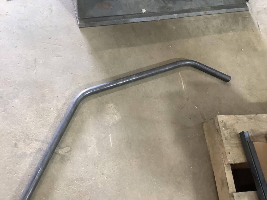

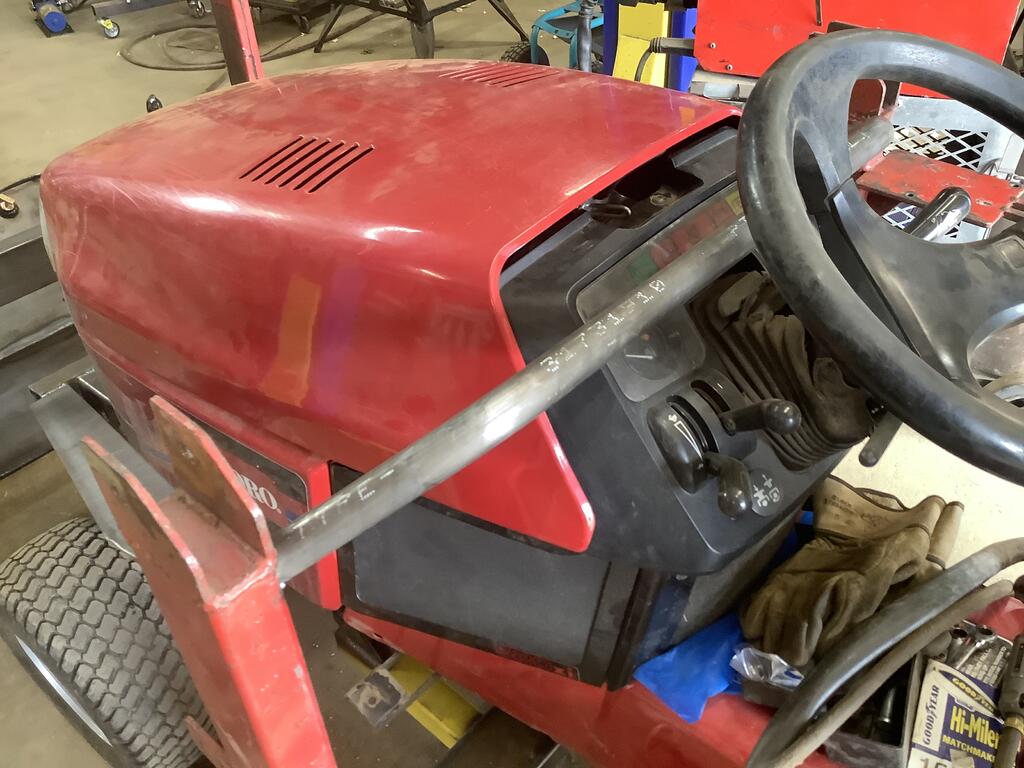

Pullstart 71,567 #207 Posted April 8, 2021 I bent this little guy up. It’ll be helpful, but it no way cumbersome or in the way. @Tractorhead I though about lifting the bucket for some dry cycles too. Great idea! @KrazeyOlDave this bucket is 7” narrower than my “stock” ARK 500 bucket. I *think* the loader arms will be ok. If not, I’ll rebuild them with heavier wall tubing. 2 Share this post Link to post Share on other sites

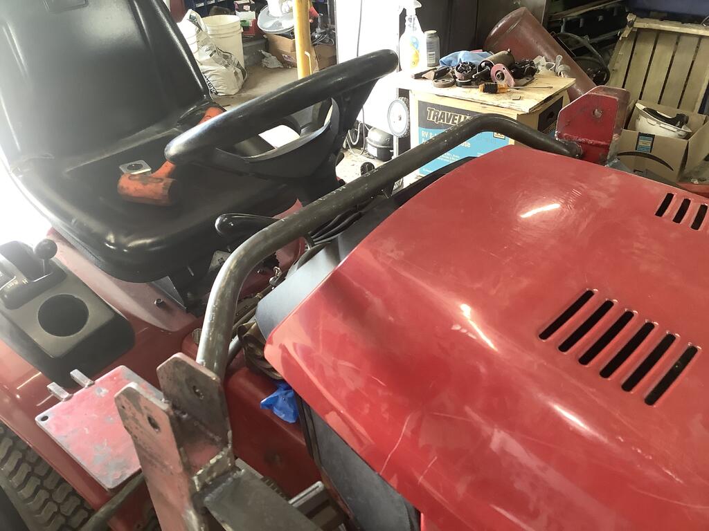

Pullstart 71,567 #208 Posted April 8, 2021 Low profile, out of the way, plus I can still see all my gauges. If I choose to mount a light bar, it might interfere with the hood but we’ll cross that bridge when we get there. 3 4 Share this post Link to post Share on other sites

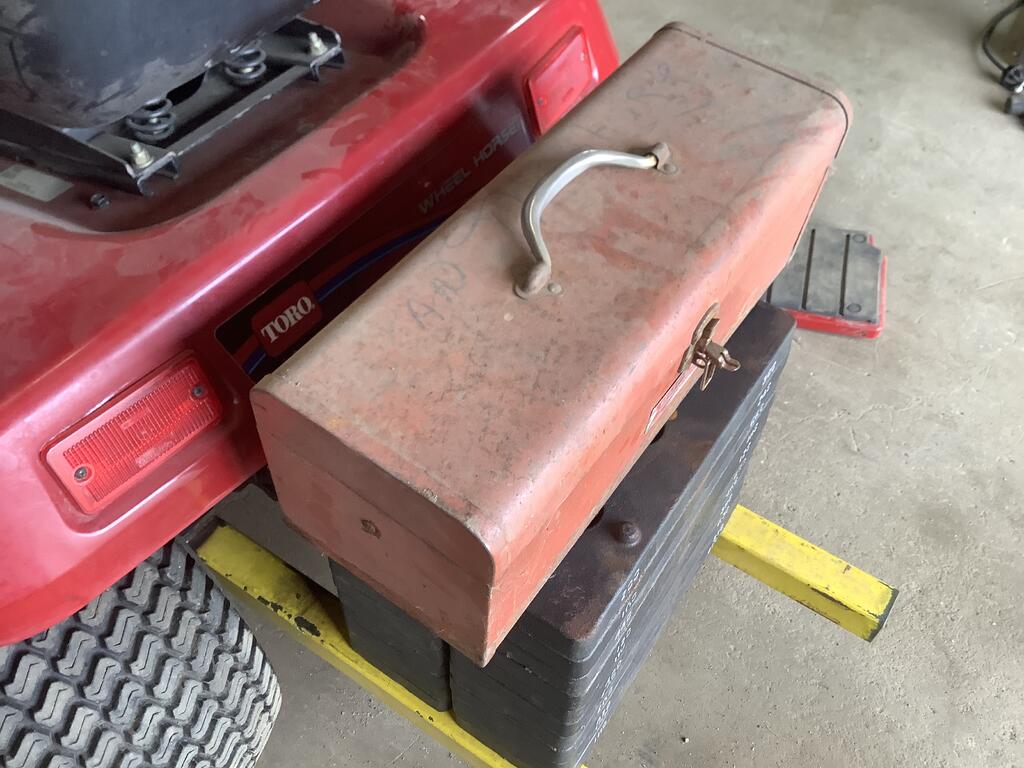

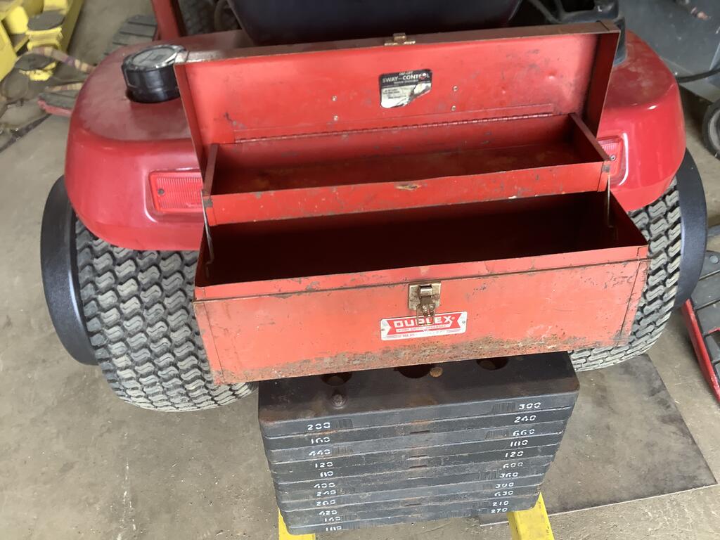

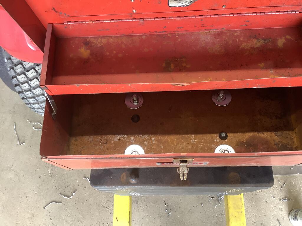

Pullstart 71,567 #209 Posted April 8, 2021 I had a pop break and called a buddy. While I was kicking the tires, I had an idea for a weight hold down. I’ll lay out the bolt pattern of the four posts onto the bottom of this box and keep some handy stuff like chain or D rings in it. 4 Share this post Link to post Share on other sites

Pullstart 71,567 #211 Posted April 8, 2021 Considering the fact that I have a tube bender, the idea crossed my mind to build a cage for this. Even the 1-1/2” or 1-1/4” tube might be enough to soften the blow. Plus, it might lend room to mount a roof 2 Share this post Link to post Share on other sites
Tractorhead 9,218 #212 Posted April 8, 2021 1 1/4“ seems stable enough to prevent a Rollover, plus you got the ability to mount a LED Lightbar on. 1 Share this post Link to post Share on other sites
Pullstart 71,567 #213 Posted April 8, 2021 The box is bolted down, it really tightened up those weights! 2 Share this post Link to post Share on other sites
Pullstart 71,567 #214 Posted April 8, 2021 19 hours ago, JoeM said: How much do those plates weigh? Look like 20 pounders? Overhung and low too. Might not need much more. I got 500 now at the rear box and 120 on the wheels. 48x16 bucket loaded with limestone gravel handles very comfortably even on the hill. Lots of traction for digging also. I like that bumper, are you going to frame it and add some expanded metal as the grill? Of Course LED lighting too! I confirmed, 20 pounders indeed. 22 of ‘em makes 440 lbs back there! Share this post Link to post Share on other sites
KrazeyOlDave 860 #215 Posted April 8, 2021 2 hours ago, pullstart said: Low profile, out of the way, plus I can still see all my gauges. If I choose to mount a light bar, it might interfere with the hood but we’ll cross that bridge when we get there. Beautiful!!! Nice work!!! 1 1 Share this post Link to post Share on other sites

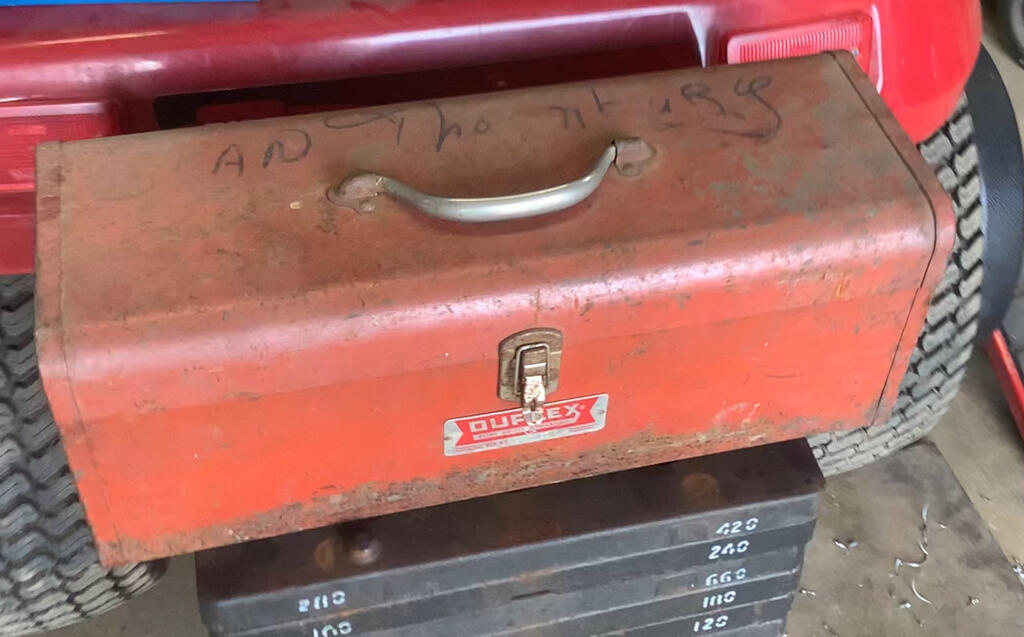

Pullstart 71,567 #216 Posted April 8, 2021 Mrs. P and I did some investigation on the toolbox. Quite unique writing font... “Stan Thornbury” it says. 3 Share this post Link to post Share on other sites
JoeM 10,318 #217 Posted April 9, 2021 4 hours ago, pullstart said: keep some handy stuff like snacks, refreshments, first aid kit I like that inverted texas longhorn tower support brace. 2 1 1 Share this post Link to post Share on other sites

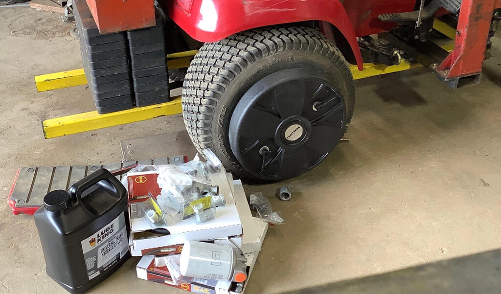

Pullstart 71,567 #219 Posted April 9, 2021 I’m off to the farm store for some hydraulic hoses, filter, etc. 2 1 Share this post Link to post Share on other sites
Pullstart 71,567 #220 Posted April 9, 2021 This will move some fluid! 2 1 Share this post Link to post Share on other sites

Tractorhead 9,218 #224 Posted April 10, 2021 1 hour ago, KrazeyOlDave said: Maybe put the bucket controls on the other side, that way you can control your drive while working the bucket. Depends on the Worker Dave, i have my Valves on right side and be fine with them. btw Kev. Put the Filter in the return line never in the high pressure line, because if you set the system under a higher pressure with a higher Load or a stall on the cylindres the whole pressure otherwise stay‘s on your filter and filtercase. While the filters housing itself is not that thick, it can maybe blast by higher loads or even on hydraulic stall. ( reach endpoints of the cylindres) That‘s the way some Hydraulic guy‘s teaches me to do. great Work you did on this Loader. 2 1 Share this post Link to post Share on other sites
