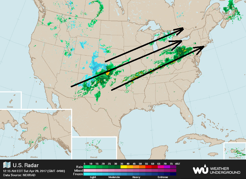

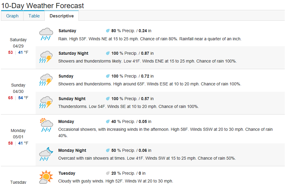

HorseFixer 2,015 #126 Posted April 29, 2017 Looks like the Weather is not going to Cooperate the next couple days most especially for running electrical wiring underground plus working on electricity, So I guess I will be back on fabrication tomorrow. We had two storms that missed us but there is one brewing out west heading straight for us! Share this post Link to post Share on other sites

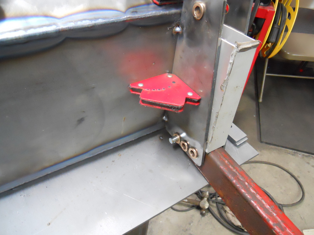

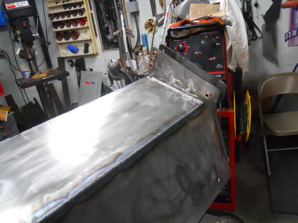

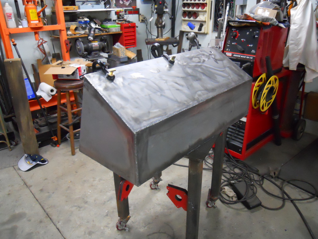

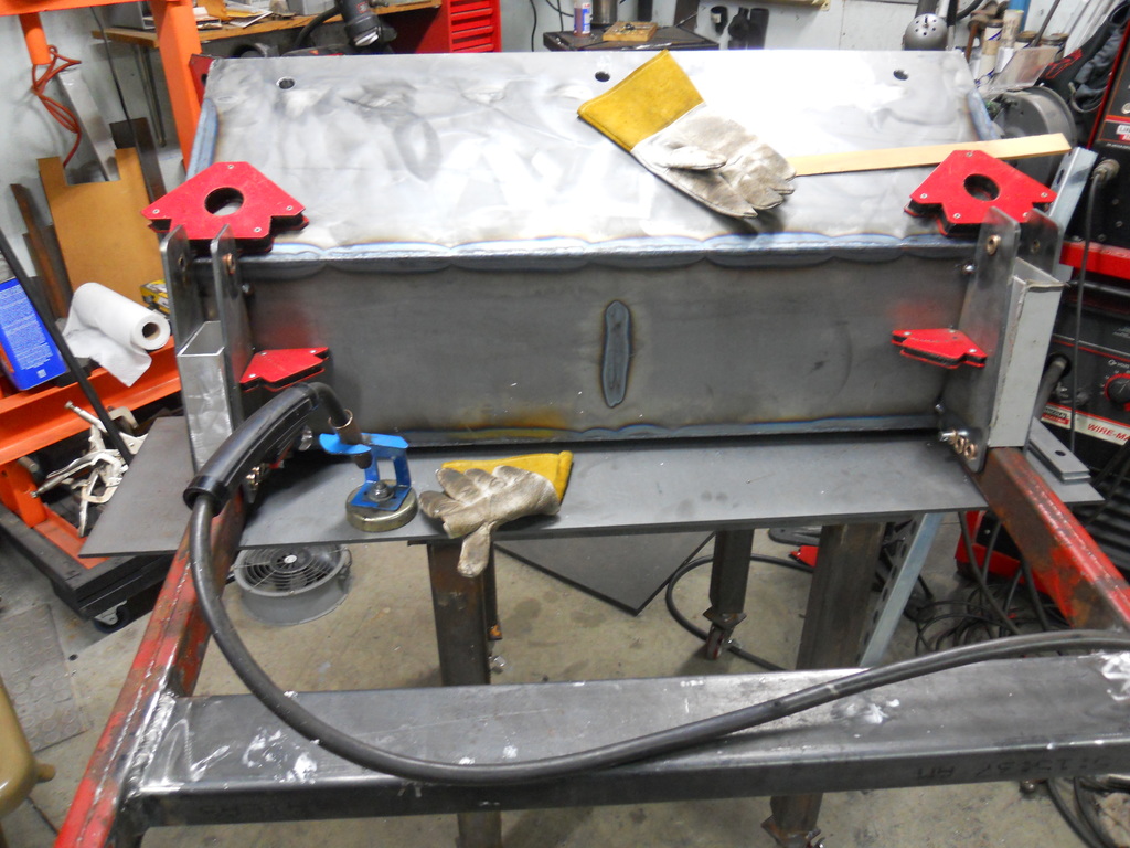

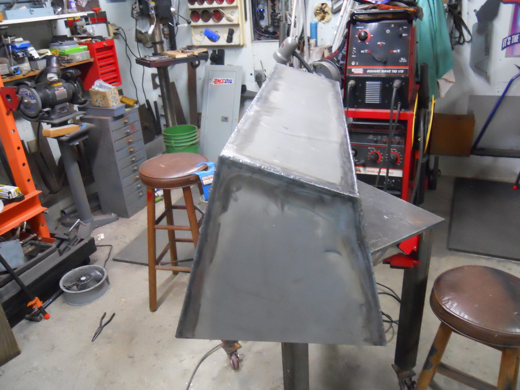

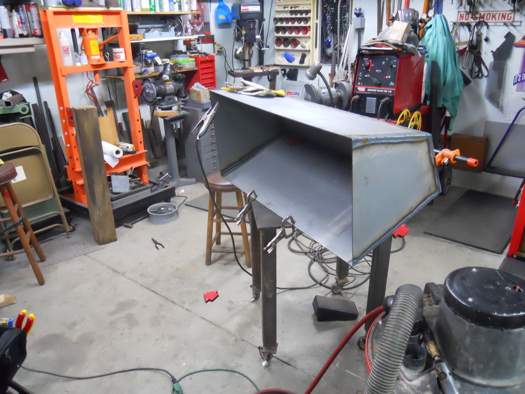

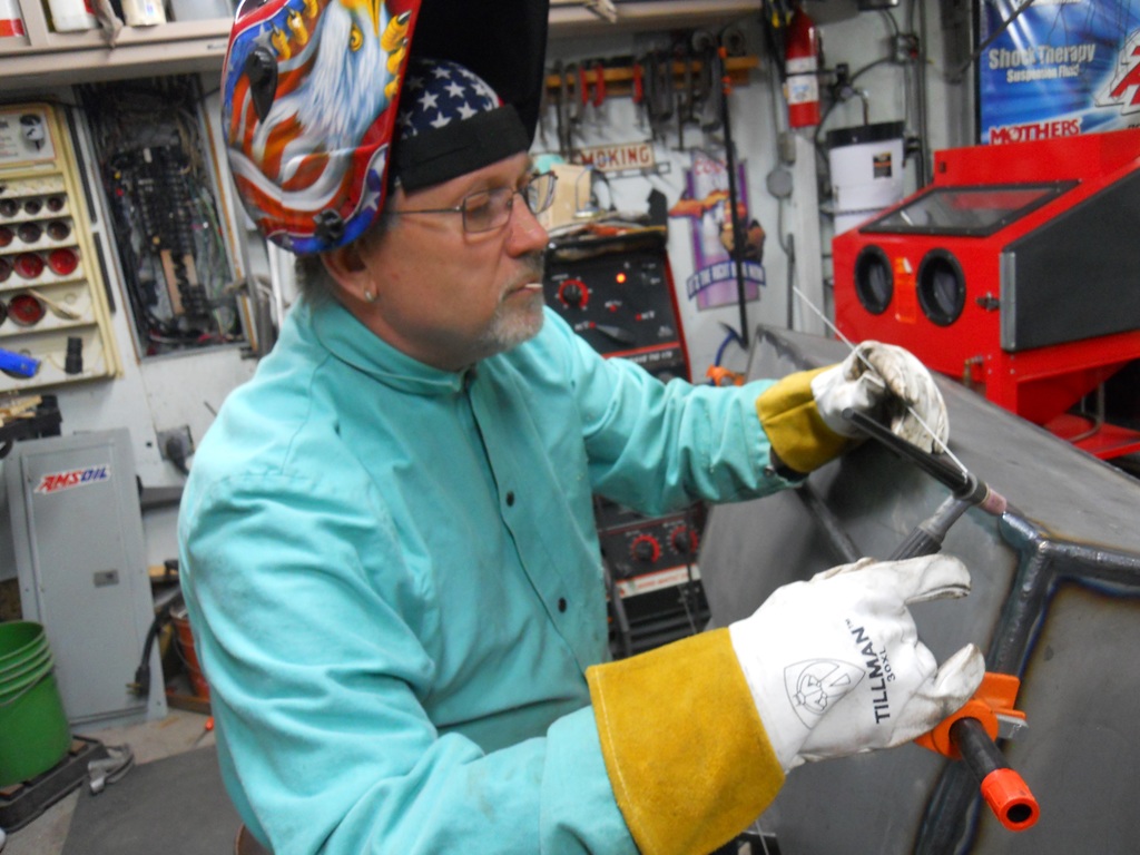

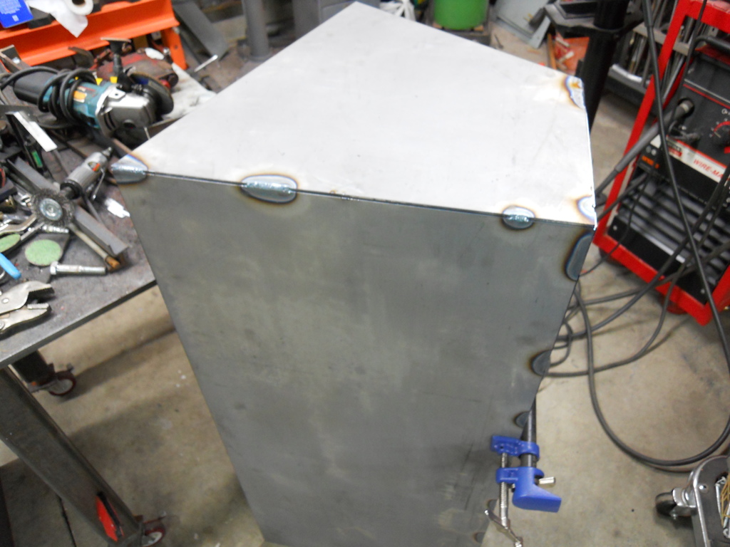

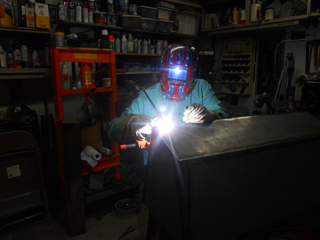

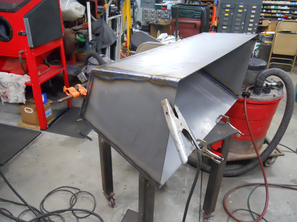

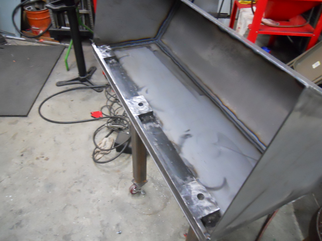

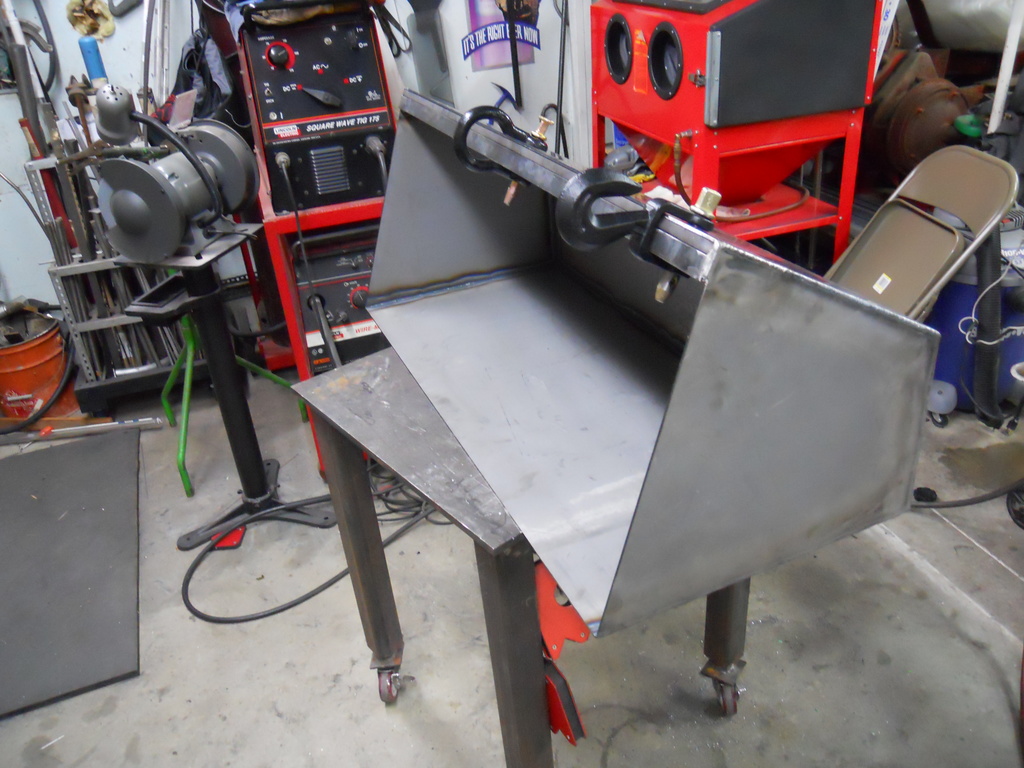

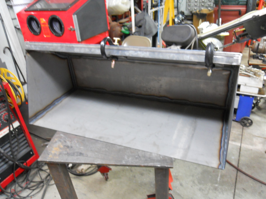

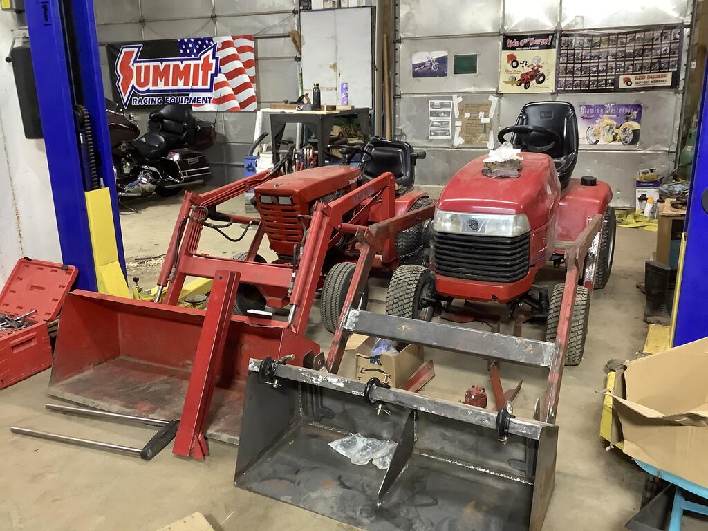

HorseFixer 2,015 #127 Posted April 29, 2017 Today worked on the Bucket and got it put together. Will add a knife blade on the bottom to save the edge and will add 1/2" Material to the Top to stiffen up the Bucket so I can put a GRAB HOOK to pick things up. I think I will take a Break for a bit and go out to Rural King and see what kind of hooks they have. I also need to install the Bucket Brackets and fit them in place. Here are some Pics. 9 2 Share this post Link to post Share on other sites
woodchuckfarmer 333 #128 Posted April 29, 2017 Looking good Duke. Wayne 1 Share this post Link to post Share on other sites
WVHillbilly520H 10,379 #129 Posted April 30, 2017 Duke, I had 3/8" grab hooks welded to my bucket before they delivered it, on eBay they go for $9/pr and on my Kioti it came with a 4" D ring welded in the center it does OK but I prefer the outward grab hooks all 3 would be better, Jeff. 4 Share this post Link to post Share on other sites

Snowmobileaddict 404 #131 Posted April 30, 2017 Duke, Its so cool to see the parts you had cut from the CAD file I provided. I hope that you are able to make good use of them. What am I saying...With that arsenal of tools in your shop (very envious!!!), you'll get it together. Looking at what you're working with, I sometimes wonder how I got my build done...A borrowed 220V MIG welder set up for flux core because I didn't want to lug the bottle back to my place from my dads shop, a grinder and a lot of careful measuring for cuts done by a third party. Those welds on your bucket look primo. I wouldn't want to put mine into service if my work looked like that! I'd be afraid I mess it up! -Andy 4 Share this post Link to post Share on other sites

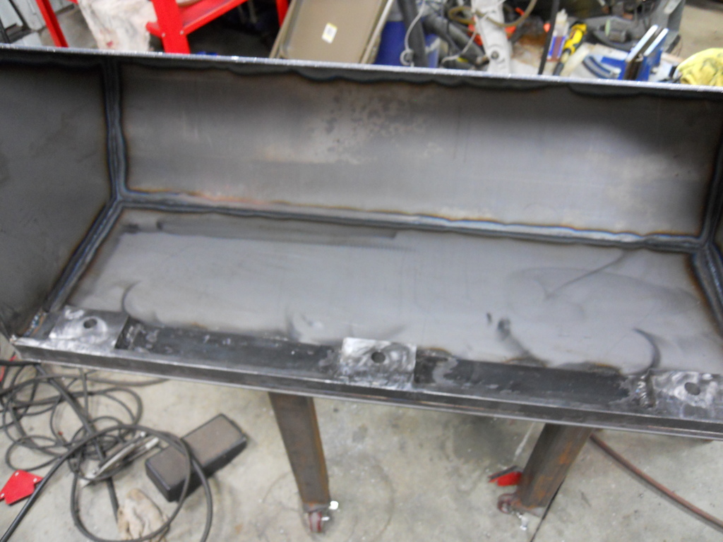

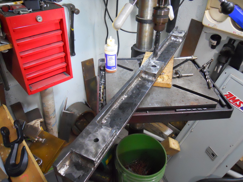

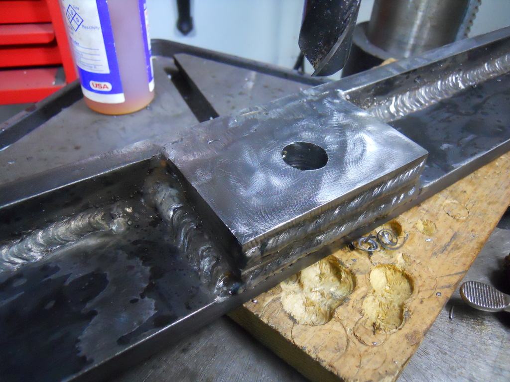

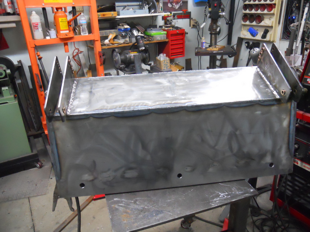

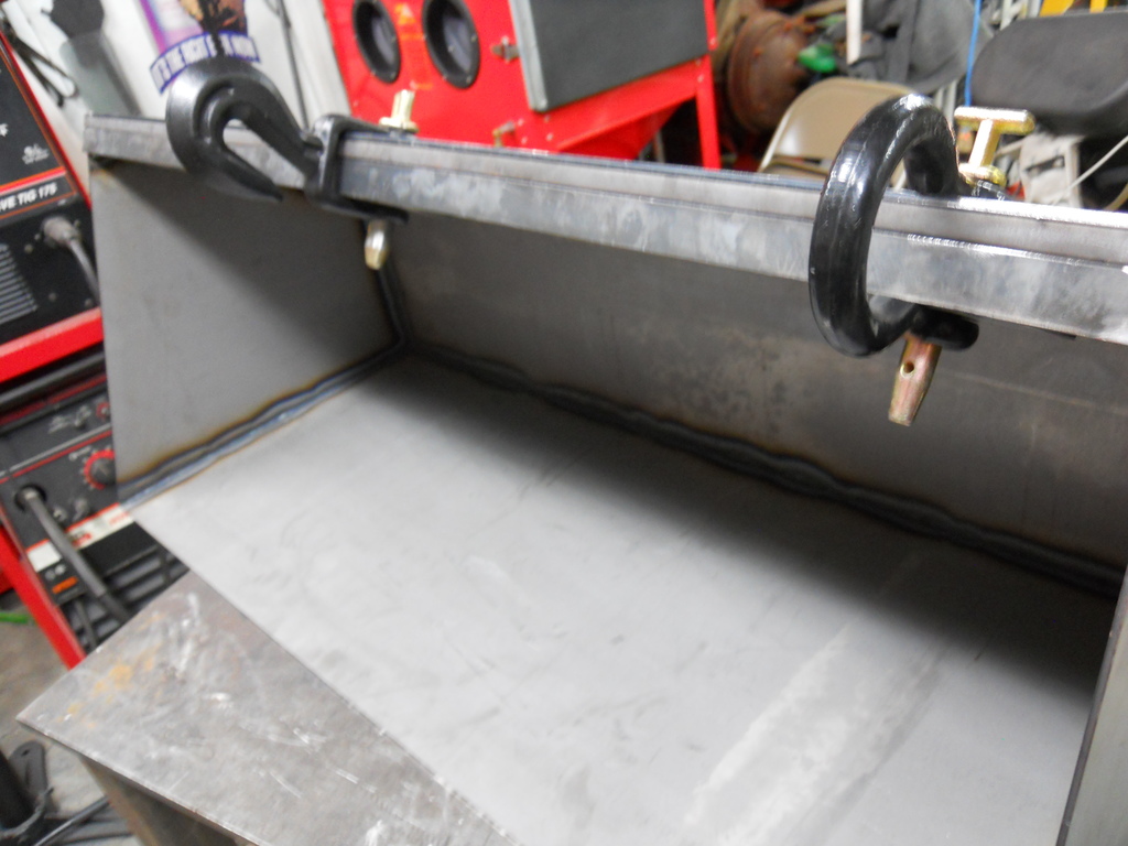

HorseFixer 2,015 #132 Posted May 1, 2017 Andy Yes I appreciate that Cad File thank you again. I thought I would work on the BIG STUFF first that being the bucket before I get into the frame and so forth. Well today I was cut short 1/2 the day because the Power went off in my City due to someone hitting a Transformer or something. Anyways a weak point on many of these buckets are the top edge is Flimsy. As we talked about putting some hooks and stuff for lifting things I Integrated that into my design I didn't want the stiffners to be on the outside so I put them to the TOP Inside. I used a 1/2 X 3 piece if flat stock with a 1/2" X 1" pice and made my own Angle Iron so to speak. I cut 2 more pads of 1/2" X 4" material X 3 and used them where the Hooks and Rings will be. I welded it all together and hit the Drill Press and drilled 3 3/4" Holes for the Clevis Pins. Now of I want the Hooks on the outside no problem. If I want Rings on the outside and a Hook in the Center No Problemo. If I want to flip the hooks over I can do that too. I might to be able to make other attachments for it later. So what do ya think will that get the Job Done? 7 Share this post Link to post Share on other sites
farmer 1,081 #133 Posted May 1, 2017 Nicely done and strong around your lifting points, by the way, is it just coincidence that all the power goes out in your city around the same time you installing solar arrays and laying cables. You may be interested in one further addition I added to my bucket that I recommend you think on, I'll include it tonight. 3 Share this post Link to post Share on other sites

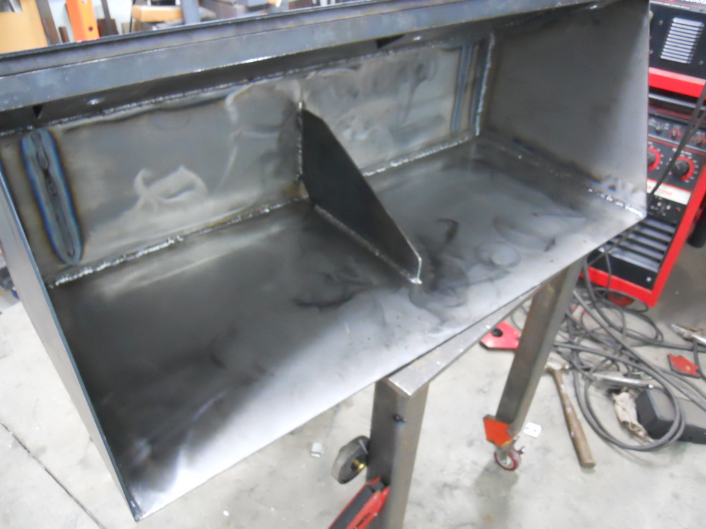

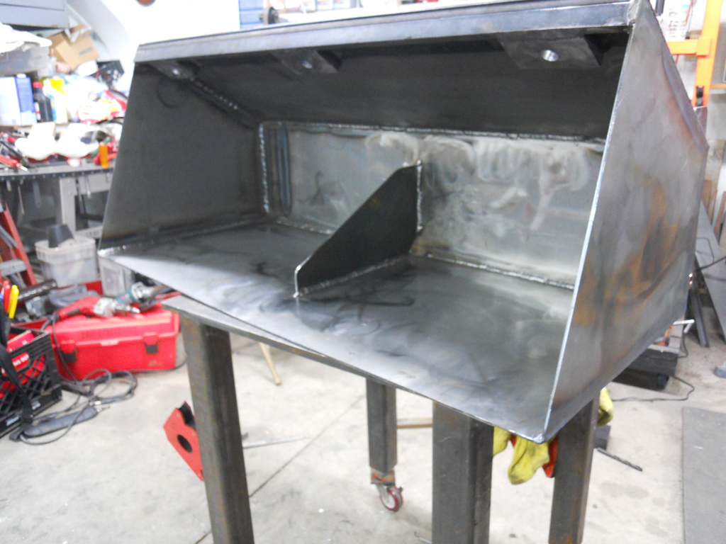

MalMac 1,337 #134 Posted May 1, 2017 Duke, are you going to put a "gusset" on the bottom of the bucket to where it joins the back wall of the bucket? The 550 had it. It will not just strengthen it but also aid in a more cleaner dump of the bucket. 1 Share this post Link to post Share on other sites
HorseFixer 2,015 #135 Posted May 1, 2017 (edited) 10 hours ago, farmer said: by the way, is it just coincidence that all the power goes out in your city around the same time you installing solar arrays and laying cables. You may be interested in one further addition I added to my bucket that I recommend you think on, I'll include it tonight. Thanks, And Brother Farmer I didn't mention this but guess I will now. When I have a Power Outage I Usually go out in the RV and start the 6500W Onan Generator and plug it in a 20 amp Outlet on the side of the house 20 ft away. And run all my critical Systems. Well guess what? Gen wont start! And by the way my enphase Solar system shuts off when Power goes off by NEC Standards so I don't fry the utility worker on the power lines. (My System doesn't have Batteries or Invert-er). So now I have a Generator to Fix!!!!!!! The kitchen hood fan quit working, And the wife says the dishwasher has a leak! WTF else can go wrong! 6 hours ago, MalMac said: Duke, are you going to put a "gusset" on the bottom of the bucket to where it joins the back wall of the bucket? The 550 had it. It will not just strengthen it but also aid in a more cleaner dump of the bucket. Tim, I had planned on installing two of them. Since my Bucket is narrower by 7 inches I prolly wouldn't even need any, but for they don't take any room so why not? Edited May 1, 2017 by HorseFixer 1 Share this post Link to post Share on other sites

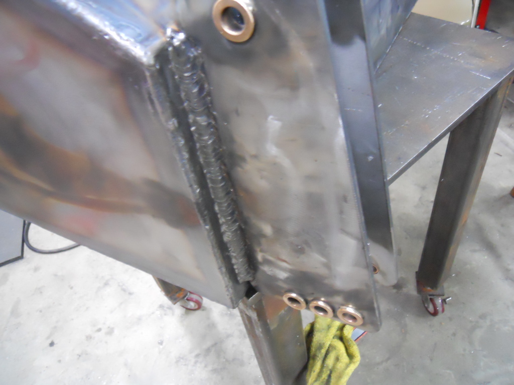

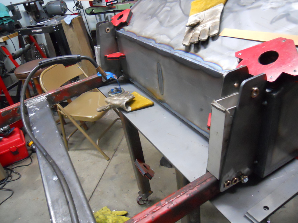

HorseFixer 2,015 #138 Posted May 3, 2017 (edited) Decided to put only (1) Gusset inside the bucket for support as two would be WAY OVERKILL. Internally welded all seams on the inside of the bucket and installed the bucket brackets. The next step will be to install gussets to the bucket brackets for support. I have a 1/2" X 4" Wide X 48" Long Knife edge for the Bucket ordered for the leading edge of the Bucket. That will be here Monday. Have plenty of brackets and parts to weld so there is no loss for work that's for sure. Edited May 3, 2017 by HorseFixer 7 1 Share this post Link to post Share on other sites

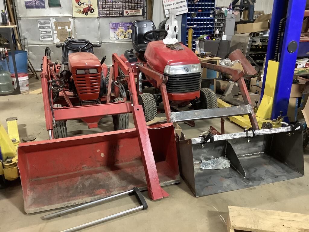

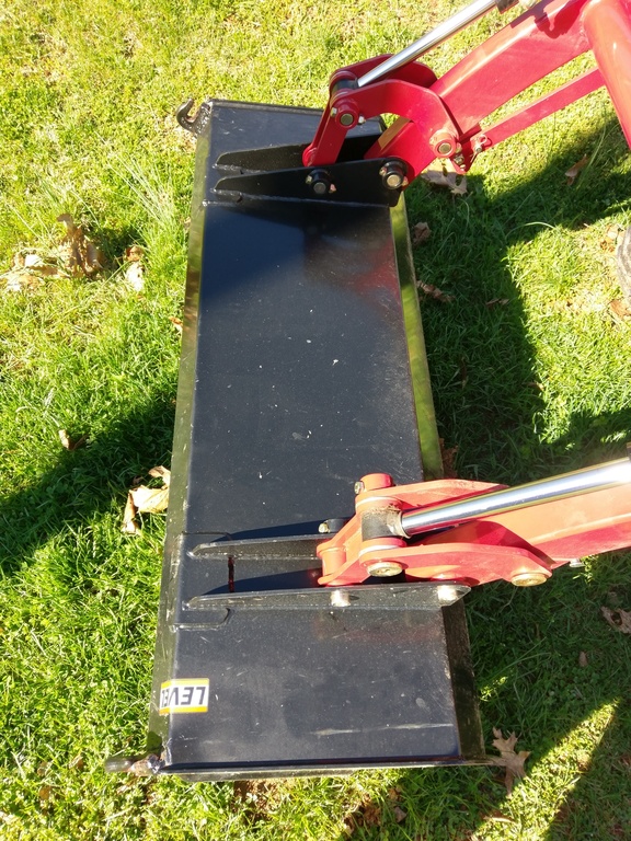

Pullstart 71,567 #149 Posted March 27, 2021 It’s been a while... Sizing things up. 2 Share this post Link to post Share on other sites
