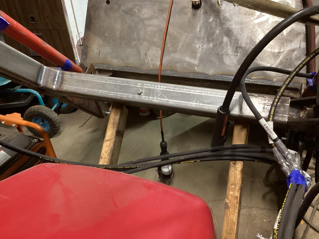

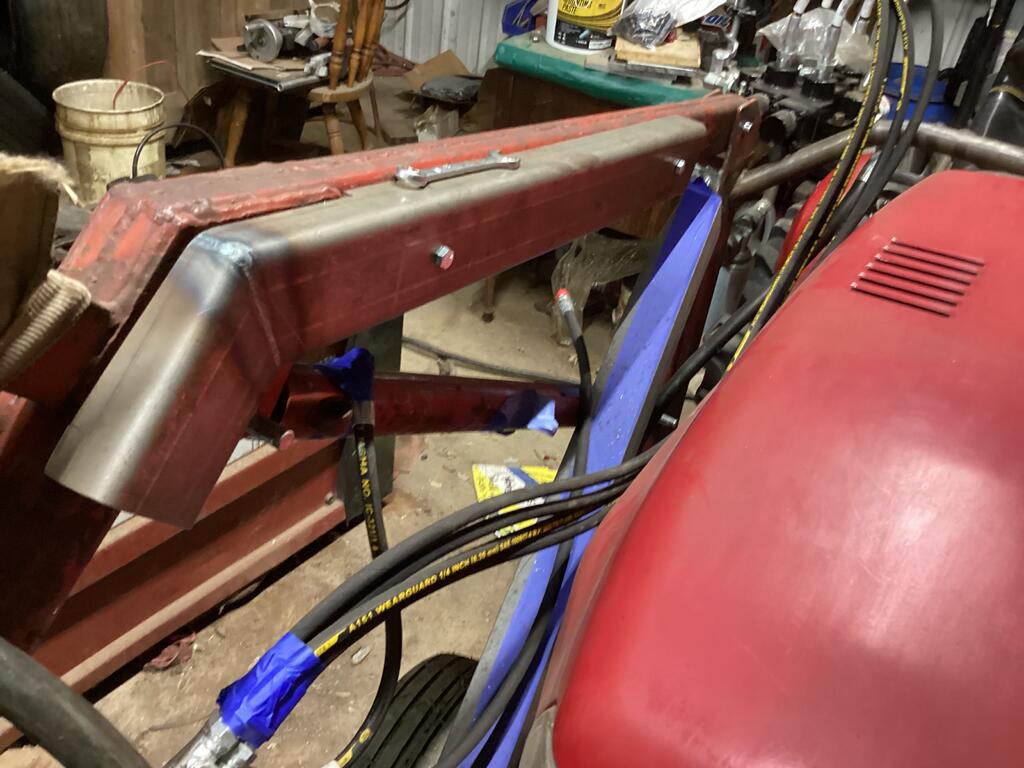

peter lena 10,127 #326 Posted October 7, 2023 @Pullstart looks good to me , the welding detail finish , is spot on , done any front wheel hub/ bearing , detailing ? glairing thing to me is the over strength of that plow frame to the original , tractor base , wheels should be re greased and shimmed for a zero side to side , shucking play , that quickly wallows out rims , and related spindles . hi temp / stress grease . maybe a magnetic heater on that pump , oil supply ? pre heated oil is nice . good work . Pete Share this post Link to post Share on other sites

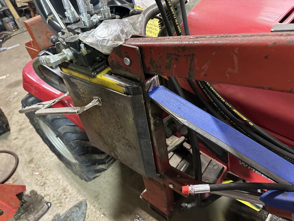

Pullstart 71,567 #327 Posted November 11, 2023 Long time again, very little progress. I welded some nuts on the loader frame to bolt the hose guards down. The center/left side guard has locators left and right, so only one bolt should be needed. 3 Share this post Link to post Share on other sites

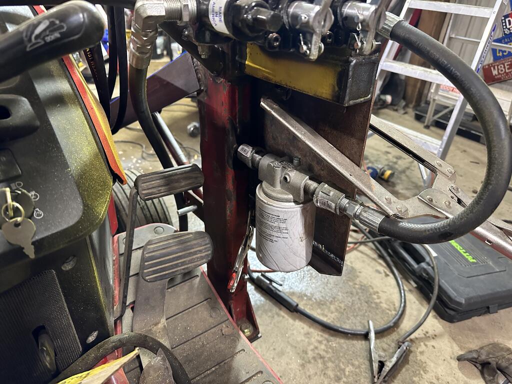

Pullstart 71,567 #328 Posted January 23, 2024 (edited) I looked at the to-do list for the FEL today and thought maybe I’d try to knock something out. This is the filter mount, turned guard. 1/4” plate, tough, heavy, simple. Overkill? Nope! Edited January 23, 2024 by Pullstart Typo 4 1 Share this post Link to post Share on other sites

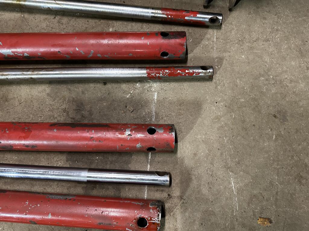

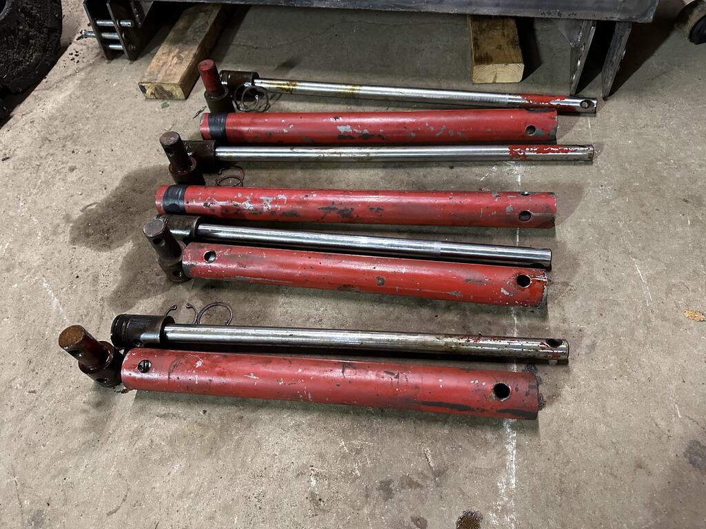

Pullstart 71,567 #334 Posted January 26, 2024 I got the cylinders torn apart last night and a body hole drilled for the fitting orientations on each long one. It might be getting fairly warm here in the next week or two. It sure would be cool to see some paint on this project for a final assembly! 1 Share this post Link to post Share on other sites
