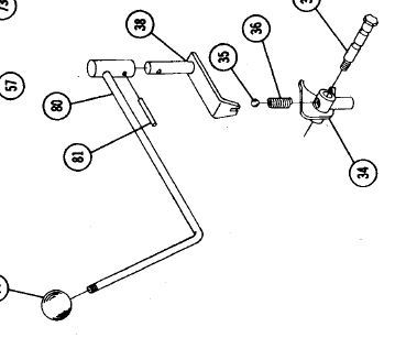

pfrederi 21,095 #2 Posted March 29, 2017 What do you mean by "Low is gone out of it". Did it used to work? Does the high low lever move all the way over to the low position? It should move almost to teh end of the slot in the cover If th handle only goes halfway you are not engages. You may have to try a couple of times to include rocking the tractor back an forth a bit to get it engaged. Do Not use a lot of force on the lever you will bend the shift fork. Share this post Link to post Share on other sites

pfrederi 21,095 #5 Posted March 29, 2017 One simple check. There is a roll pin (#81) that goes through the high/low shifter and the shaft going into the tranny make sure it hasn't seared off. That would let the handle move but not engage the fork. If that is in good shape I am afraid you are going to have to open up the tranny. Share this post Link to post Share on other sites
