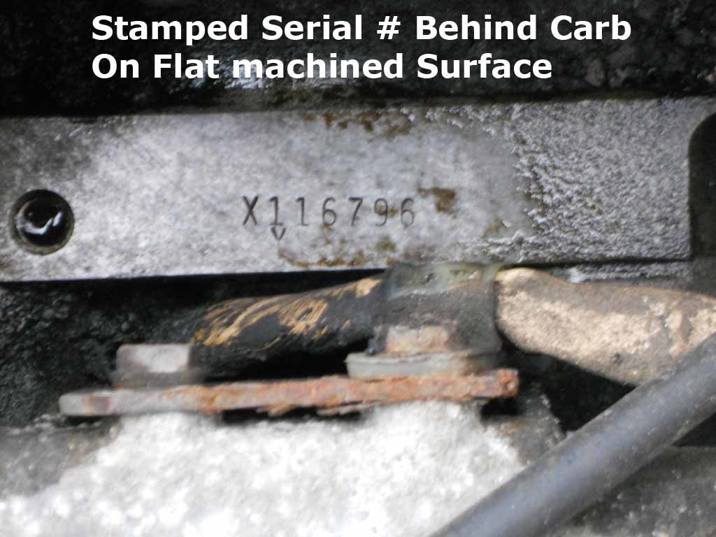

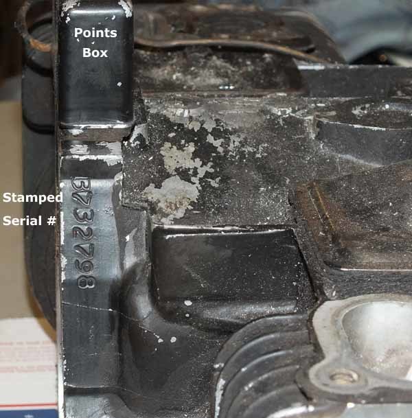

onanparts.com 185 #2 Posted March 29, 2017 20 hours ago, 96WS6TA said: Hi does anyone still sell new onan p220g cranks? Thanks What is the full Onan model and spec numbers? From the Onan ID sticker. Looks like this: P218G-I/12345C. If not legible then locate the 7 digit "Stamped" in the block serial number. Share this post Link to post Share on other sites
