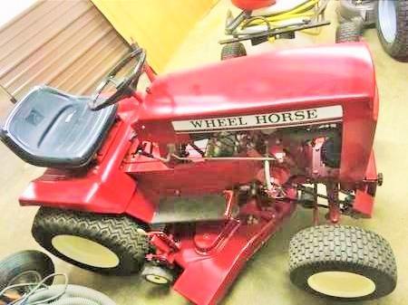

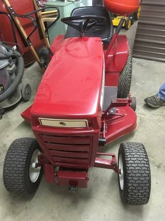

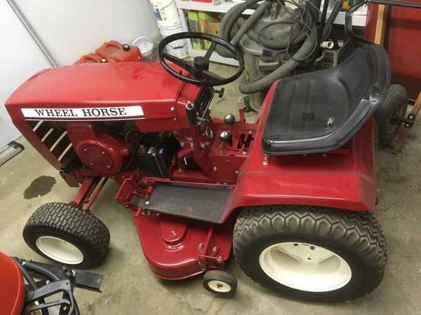

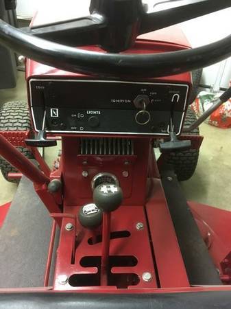

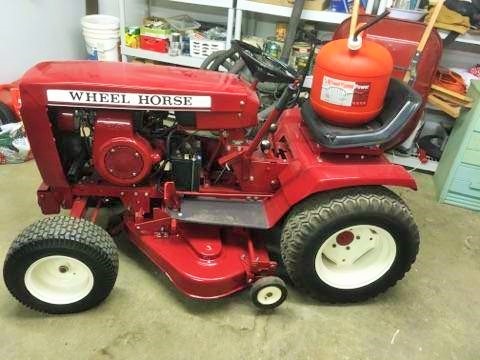

Jim Demery 405 #39 Posted August 14, 2017 On 3/28/2017 at 3:17 PM, Oldarmy said: Hello fellas new guy here and just wanted to say hello. I am old but new to old tractors and just bought this one today in NH where I live. I have been looking for something simple like this for a couple of years now. I will use this for mowing and to help me move things around my property. The older gent I got it from is a very meticulous fellow and has restored several tractors in his 70 plus years. He did this one a year or so ago and did full on rebuild of the 8hp Kohler all new internals. Went through every nut and bolt. Only thing it needs is a spindle replaced or rebuilt. He was having fits trying to take it apart to change out the bearings. Also never added decals but I may. He was going to ride this around at tractor shows but has decided to move south and is selling off a bunch of stuff. The pics don't do it justice. It's a 77 ? B80 8 speed even threw in an original Wheel Horse gas can, anyone ever seen one of these ? Any way I know jack about these and hope to pick some brains here and learn a little. Any way that's my story. Btw I paid him $950 for this he gave me receipts for close to $700 in parts and the work he has done here speaks for it self. Jim 1 Share this post Link to post Share on other sites
