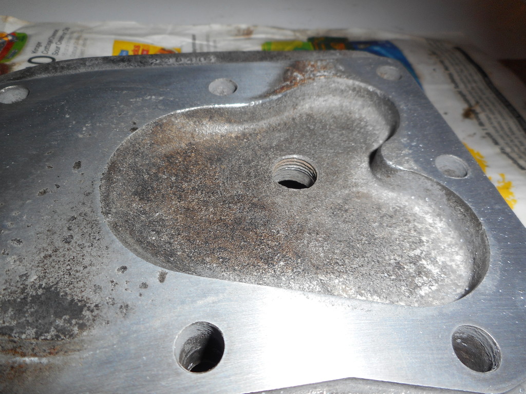

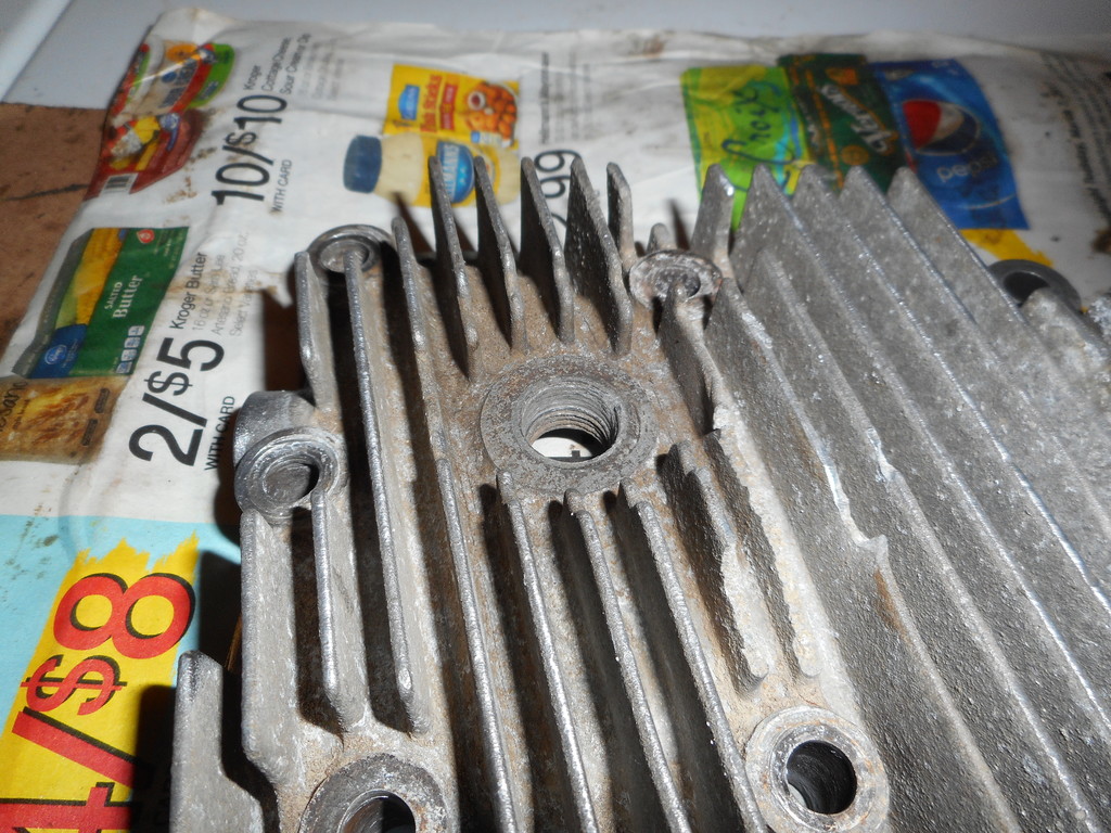

hondasl125 1 #1 Posted March 28, 2017 I have a Kohler K161, 28522E with possibly damaged thread holes in head! The spark plug doesn't screw in very well through top but bottom threads seem fine! Is there any way to repair this(threaded insert possibly) OR do I have the WRONG spark plug possibly? Manual calls for a Champion RJ8C! 1 Share this post Link to post Share on other sites
Elkskin's mower junkyard 1,117 #2 Posted March 28, 2017 3 minutes ago, hondasl125 said: I have a Kohler K161, 28522E with possibly damaged thread holes in head! The spark plug doesn't screw in very well through top but bottom threads seem fine! Is there any way to repair this(threaded insert possibly) OR do I have the WRONG spark plug possibly? Manual calls for a Champion RJ8C! looks stripped. helicoil would be best bet but if you are looking for a good used head id sell one cheap. i got a couple spares. 6 Share this post Link to post Share on other sites

953 nut 69,548 #4 Posted March 28, 2017 the J-8 is the correct plug. any good auto repair shop or machine shop can insert a Helicoil for you, call around for prices first, could vary wildly. 3 Share this post Link to post Share on other sites

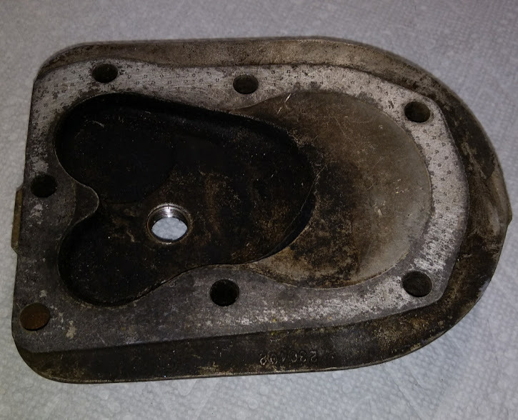

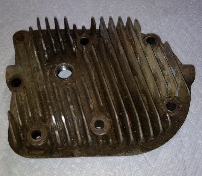

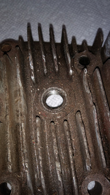

rmaynard 17,585 #14 Posted March 30, 2017 @hondasl125 I have a head from a K181 that has been repaired with a Helicoil. I sold other parts off the engine, but if you would like to try this head, I can send it to you for the cost of shipping. Needs to be cleaned, but it looks quite functional. PM me if interested. 2 Share this post Link to post Share on other sites

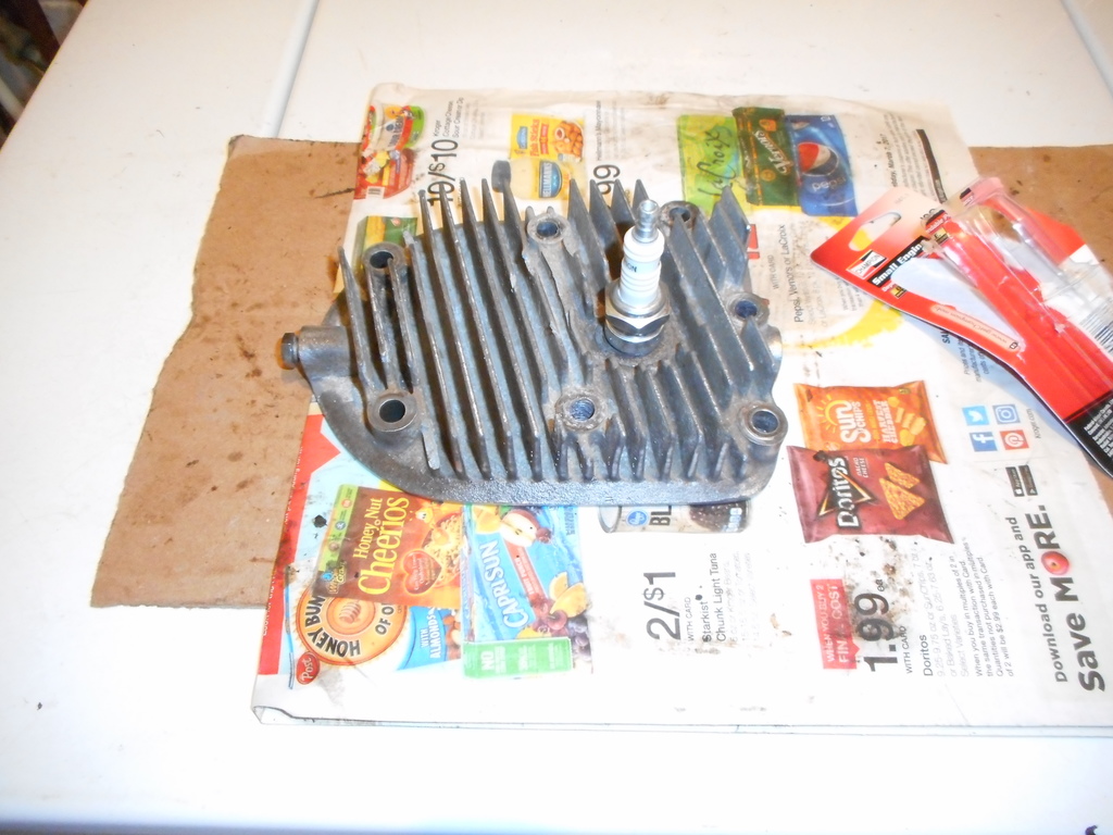

Howie 900 #17 Posted April 2, 2017 I like the type that is an insert instead of the helicoil. When installed the top rolls over and kind of crimps into place. The name escapes me right now though. Share this post Link to post Share on other sites
Sarge 3,473 #18 Posted April 2, 2017 Timesert - and they require a pretty good whack to set them properly - you have to take a lot of care on a single cylinder aluminum cylinder head due to the risk of cracking/breaking the head . http://www.timesert.com/html/sparkplug.html Sarge Share this post Link to post Share on other sites
Howie 900 #19 Posted April 3, 2017 What I have is probably the same thing, but this one is from an Australian company. Its called Fix-A-Thred Plug Saver. Alcoa Fastening Systems. I set the spark plug hole on a piece of hardwood when seating the insert. Did not want to seat it without some support. I came upon this set at a store that does buyouts and got a very good deal on it. Have not seen any more at the price I paid. Share this post Link to post Share on other sites
