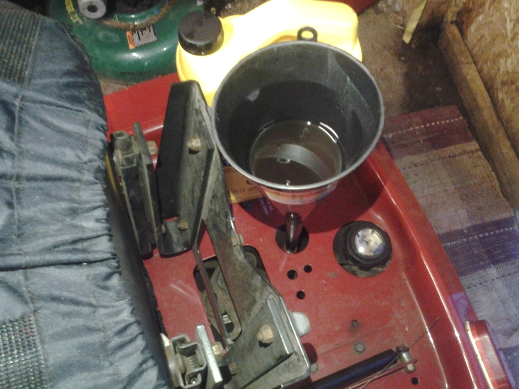

Cee245 861 #1 Posted March 27, 2017 Hi everyone, I have a question about my 97 416h model 73423 and (I think) Eaton 1100 transmission. I feel dumb about asking but here goes... I downloaded the manual (it says eaton 11 not 1100) for it and it says to use about 5 quarts of 10w30. I clicked on maintenance to get that ~5 quart capacity I'm not new to changing the trans fluid but today it's seems to be taking forever! I'm fearing I overfilled by taking the downloaded manuals advice on 5 quarts..... In the past, I always went to the dealer and bought EVERYTHING needed to complete the job. I hate to admit that I haven't done it in a couple years. This time I looked here on RS for capacity and also bought the Napa filters as they have good reviews here. Am I being impatient or what did I royally screw up? Thanks C 1 Share this post Link to post Share on other sites
pfrederi 21,095 #2 Posted March 27, 2017 The 5 qts is based on a complete draining of the system. Unlikely you will ever get in a full 5 qts. Go with the dipstick. it takes forever to fill them. You can try loosening the filter or removing a bolt from the the top of the transaxle..or just be very patient and work slowly. 4 Share this post Link to post Share on other sites
953 nut 68,773 #3 Posted March 27, 2017 (edited) The only vent path is through the oil in the filler; some folks put a piece of wire along side the funnel as it enters the trans to allow air to escape. Like Paul said, put in four quarts and run it then check the dip stick. Edited March 27, 2017 by 953 nut 3 Share this post Link to post Share on other sites
pfrederi 21,095 #4 Posted March 27, 2017 (edited) A small wire along side the funnel may help also to bleed out the air 953 beat me Edited March 27, 2017 by pfrederi 2 Share this post Link to post Share on other sites

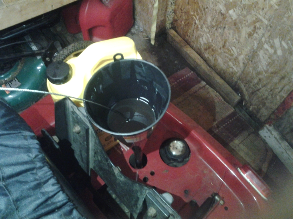

Cee245 861 #5 Posted March 28, 2017 Thanks for the quick response pfrederi, 953 nut! I drained fluid and changed filter, there is about 4.5 quarts added as of now including the oil in the funnel. Its been ~ 2hrs now and doesn't seem to move now. Will try venting using my extra snowblower chute wire now. 1 Share this post Link to post Share on other sites
Cee245 861 #6 Posted March 28, 2017 This doesn't seem to have much effect. Its gone down a very little though. but its been a half hour. I will check tomorrow and post updates. Share this post Link to post Share on other sites
leeave96 496 #7 Posted March 28, 2017 Crack open the oil filter and fill it up. 2 Share this post Link to post Share on other sites
Howie 900 #8 Posted March 28, 2017 Wire should be on the outside of the funnel where it goes in transmission. 4 Share this post Link to post Share on other sites
WHX?? 57,886 #9 Posted March 28, 2017 Good advice above...tranny needs to burp when filling... I take out a trans top bolt when doing this but I do the trans. maintenance when I have the fenders off for cleaning. Can be just as simple as a drinking straw next to the funnel. 1 Share this post Link to post Share on other sites

953 nut 68,773 #11 Posted March 28, 2017 16 hours ago, 953 nut said: wire along side the funnel along side, not inside. 1 Share this post Link to post Share on other sites
