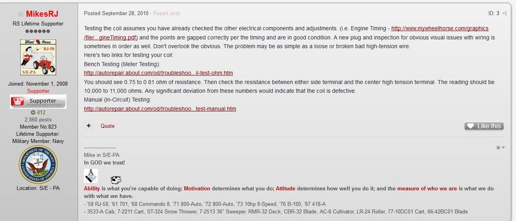

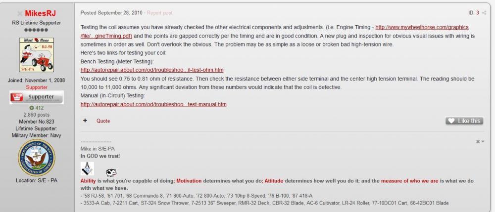

DTOM 124 #7 Posted March 27, 2017 Ohm your primary and secondary of the coil first before buying one. 2 Share this post Link to post Share on other sites

pfrederi 21,174 #9 Posted March 27, 2017 Test it cold then est it when teh unit has shut down 2 Share this post Link to post Share on other sites
