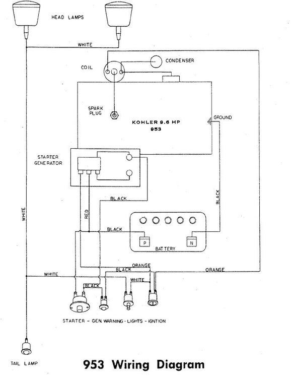

cdr_warsstar 106 #14 Posted April 21, 2017 Finally started doing some work on it. I pulled the steering shaft so I could extract the broken bolts. I got lucky and they came out easy. I'll get some new bolts tomorrow, grease it up, and put it back in. And that's probably about all I'll have time for right now. I needed to get the steering fixed so I can get it out of the driveway and work on the other mowers that I need to get fixed and sold. One question, is the electrical system a negative ground 12 volt system? I know I probably won't be able to get into trying to start it for awhile but I'd like to know for when I do. 3 Share this post Link to post Share on other sites
953 nut 64,171 #15 Posted April 21, 2017 13 minutes ago, cdr_warsstar said: is the electrical system a negative ground 12 volt system? Yes it is 12 Volt negative ground. Tractor 1963 953 OM IPL Wiring #123 (1) (1).pdf 1963 Price list.pdf Oh, by the way, I love 953s. 4 Share this post Link to post Share on other sites

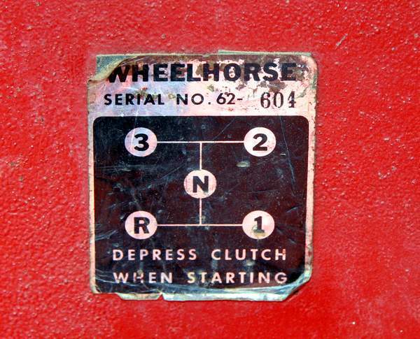

k2wilson 41 #17 Posted April 22, 2017 Just out of curiosity, what's your serial number? Here's mine.... 1 Share this post Link to post Share on other sites
cdr_warsstar 106 #18 Posted April 22, 2017 10 hours ago, k2wilson said: Just out of curiosity, what's your serial number? Here's mine.... 62-227 Share this post Link to post Share on other sites
