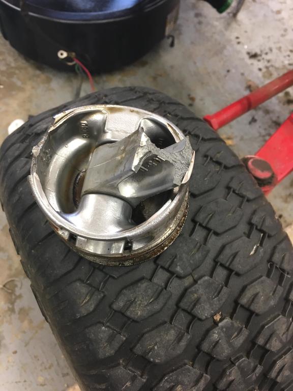

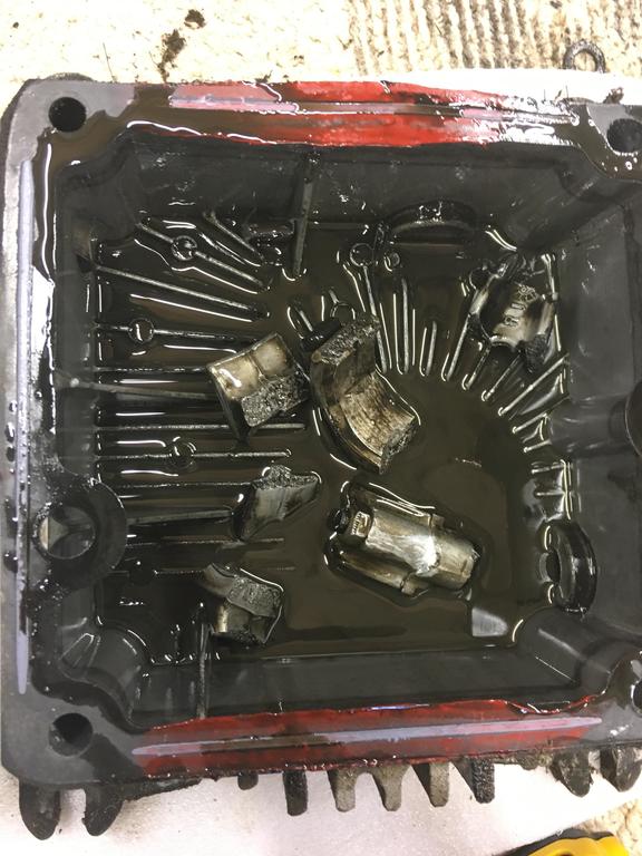

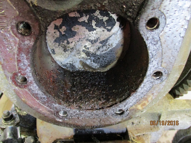

96WS6TA 37 #1 Posted March 24, 2017 Got a nice low mileage 97 520h from Craigslist. Guy said it had a lil miss. Shoot at idle a bit then throttle up and it ran fine so I bought it. Got it home and tore into it a little to adjust the valves and saw they were full of gas and junk! So figured I'll pull the motor and saw the other piston wasn't turning with the crank!!!! Well live and learn I guess 2 Share this post Link to post Share on other sites

WHX?? 55,098 #4 Posted March 24, 2017 (edited) Ouch sorry to hear this....No chance of cleaning it up & a new piston & rod?? Edited March 24, 2017 by WHX9 2 Share this post Link to post Share on other sites

96WS6TA 37 #8 Posted March 24, 2017 (edited) I have a 16 horse onan??? But It just mentally won't be the same ha 56 minutes ago, WHX9 said: Ouch sorry to hear this....No chance of cleaning it up & a new piston & rod?? The Cyclinder is pretty scored up Edited March 24, 2017 by 96WS6TA 2 Share this post Link to post Share on other sites

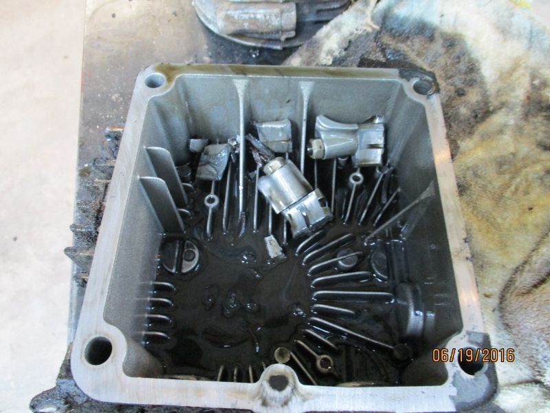

stevebo-(Moderator) 8,604 #14 Posted March 25, 2017 I had a similar situation. Bought 416 with onan not running right. Ended up parting and the guy that was buying the motor wanted to pull the head and we found there was no piston on one side. I ended up gvingi him the motor 3 Share this post Link to post Share on other sites

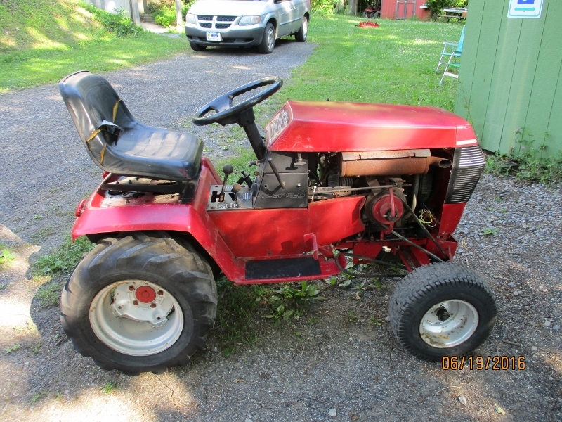

HorseFixer 2,014 #15 Posted March 25, 2017 Now wait just a cotton picken minute here! I have not seen a photo shoot of the tractor yet! Sides Front Rear all around. How much did you pay for it? How many Hours on the tractor? I wouldn't be cobbling up a perfectly good tractor with a Kohler. I love my Kohler's too don't get me wrong but why take the easy way out doesn't anyone do anything right anymore? Look inside a Kohler plastic oil pump gears stamped Aluminum Onan Cast Iron Oil Pump Steel Gears. You get what you pay for. ~Duke 5 Share this post Link to post Share on other sites

HorseFixer 2,014 #19 Posted March 25, 2017 (edited) That looks like TERMITES in the cylinder! Edited March 25, 2017 by HorseFixer 1 Share this post Link to post Share on other sites

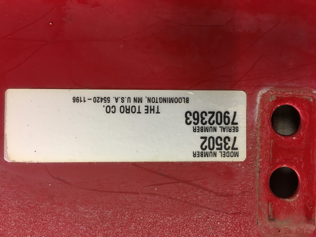

96WS6TA 37 #20 Posted March 25, 2017 I ran the numbers it a 97 4 Share this post Link to post Share on other sites

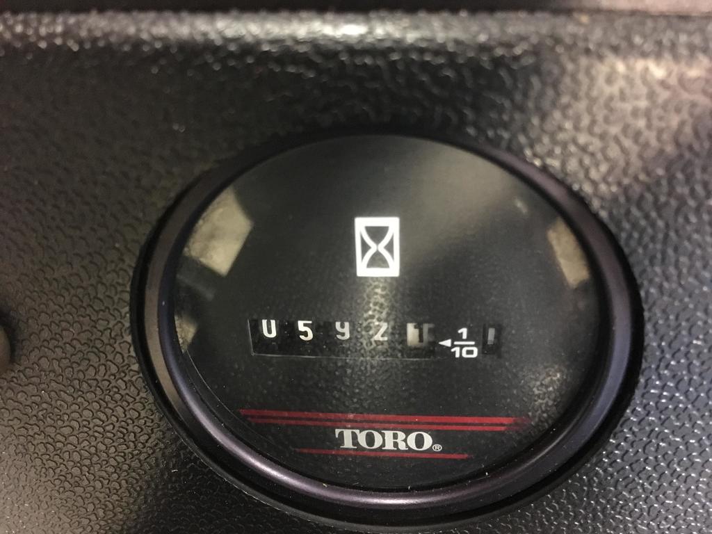

HorseFixer 2,014 #21 Posted March 25, 2017 Got any more close up pics? How may Hrs? Share this post Link to post Share on other sites

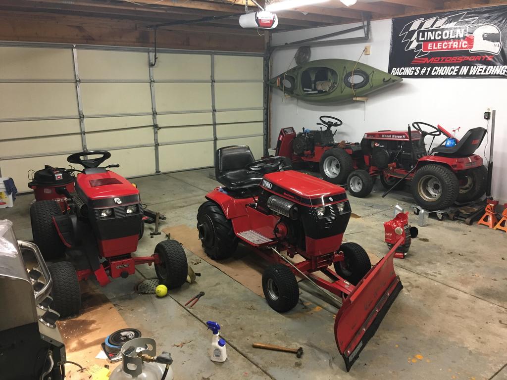

ericj 1,579 #22 Posted March 25, 2017 (edited) 14 minutes ago, 96WS6TA said: I ran the numbers it a 97 what is the tractor 2 nd from the back against the wall, now that I look at it closer I would guess a 312-A or a 314-A, thought at first it was a lawn tractor vertical shaft tractor, the console didn't look right from the angle in the photo eric j Edited March 25, 2017 by ericj 2 Share this post Link to post Share on other sites
HorseFixer 2,014 #23 Posted March 25, 2017 28 minutes ago, 96WS6TA said: I ran the numbers it a 97 Is the one with bad engine the one against the wall? 1 Share this post Link to post Share on other sites
Wishin4a416 2,473 #24 Posted March 25, 2017 (edited) My guess would be be far left. Or near left by the grille. Edited March 25, 2017 by Wishin4a416 1 Share this post Link to post Share on other sites
96WS6TA 37 #25 Posted March 25, 2017 the bad 520 is next to grill the 416 will be the donor and that's an old 312 against the wall and another 312 with the plow 1 Share this post Link to post Share on other sites
