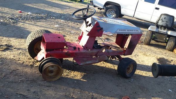

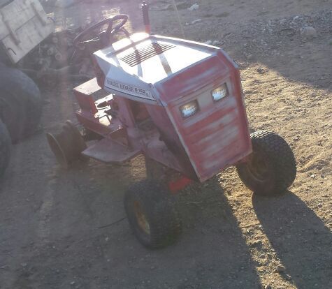

Kerry67 20 #1 Posted March 24, 2017 Finally found one in Arizona. Not quite as old as I was hoping but it should be fun......B-165, and idea of the year? Would like to put bigger rear wheels, etc.... Thoughts? Share this post Link to post Share on other sites
stevasaurus 23,884 #2 Posted March 24, 2017 I'm not trying to talk you out of that, but I hope you are getting it for not much more then free. You will be putting quite a bit of money back into it...and in the end...it is still a vertical shaft horse. It is never going to be worth or be able to do what a horizontal shaft horse will do. It also looks like it has been parted out to a point, and I don't think it is going to be easy finding parts for that style. If that horse is what you are looking for and you know what you are getting into...and accept the challenge, then you are going to save a horse. We can help as much as possible and we would surely like to see how you progress. Looks like they were made from 1980 to 1984...maybe later. They were either a 5 speed manual (Peerless) or an automatic (Eaton). They used a 16hp Briggs for power. We can nail it down if you find a model #...it would look something like 02-16BE01 or 02-16BP04. The "B" is for Briggs...the "E" or "P" is for Eaton or Peerless. I'd be more inclined to walk away if the transmission is the Eaton automatic because...it may be a long time before you find out if the auto is any good. 5 Share this post Link to post Share on other sites
BOB ELLISON 2,983 #3 Posted March 24, 2017 Built 1980-1985 came with a briggs and stratton engine. This is more of a light duty tractor because of the transmission. Peerless 801 or a Eaton 700. Not to say it didn't have the power with the 16hp briggs . I like the briggs engines. 2 Share this post Link to post Share on other sites
T-Mo-(Moderator) 5,003 #4 Posted March 24, 2017 It's a Wheel Horse, but it's strictly a lawn tractor, made basically for mowing the lawn and maybe light snow duty. As mentioned above, it looks like it's been picked apart for parts and it may be hard, especially in Arizona since you're having a hard time finding complete Wheel Horses, of finding parts. If it was me, I think I would pass and keep looking for a horizontal shaft Wheel Horse. 4 Share this post Link to post Share on other sites
Kerry67 20 #5 Posted March 24, 2017 Yeah, I decided to pass after hearing from you guys here and on another site. I will wait until I find the right one.... 11 Share this post Link to post Share on other sites

Kerry67 20 #11 Posted March 24, 2017 2 hours ago, Amcwheel85 said: there was nothing left of that machine! If I can.. what were they asking for it? $25 Share this post Link to post Share on other sites
Sparky-(Admin) 26,688 #12 Posted March 24, 2017 2 hours ago, Kerry67 said: $25 Overpriced by $24 if you ask me ! You may have to bite the bullet and pay shipping costs. Is there a Fastenall near you? A few guys here swear by their shipping for ease and low cost. Mike...... Share this post Link to post Share on other sites
