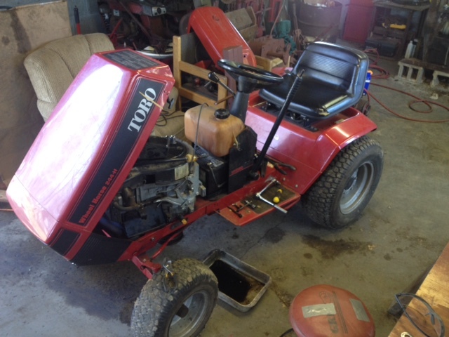

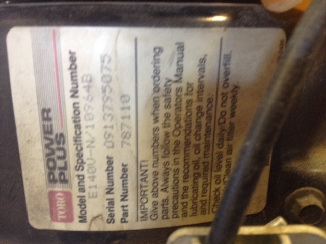

Andrew D. 23 #1 Posted March 23, 2017 Is there a good carburetor rebuild kit available for the 14 horse power Onan model E125V-N/10964B ? the tractor runs great with no problems but left sitting for more than 3 days it leaks fuel out of the carb i don't know if the needle isn't seating right or if the float bowl seal is leaking or what i'm fighting, i'm not familiar with Onans yet and am struggling to find a kit for that model engine. Thanks in advance for the help Share this post Link to post Share on other sites
gwest_ca-(File Mod) 12,281 #2 Posted March 23, 2017 14hp is the E140v like on your engine decal is it not? Noticed the E125V used the same spec number according to Toro. That is odd. The Toro carb number is NN10668 and somewhere I saw the Onan number is 0146-0526. Garry Share this post Link to post Share on other sites

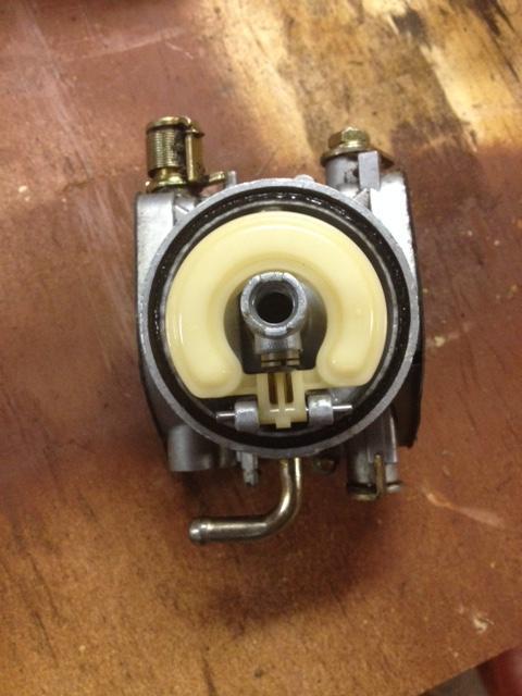

Andrew D. 23 #3 Posted March 24, 2017 thank you, i now have another problem though, when i put the bowl back on the cast aluminum around the bowl snapped, does anyone have a bowl or know where i could find one? Share this post Link to post Share on other sites
onanparts.com 185 #4 Posted March 24, 2017 1 hour ago, Andrew D. said: thank you, i now have another problem though, when i put the bowl back on the cast aluminum around the bowl snapped, does anyone have a bowl or know where i could find one? If you can't locate a good used bowl, then a used or new carb is the only option. The bowl was not offered by Onan as a separate part. We do have new 146-0526 carbs in stock. Share this post Link to post Share on other sites
