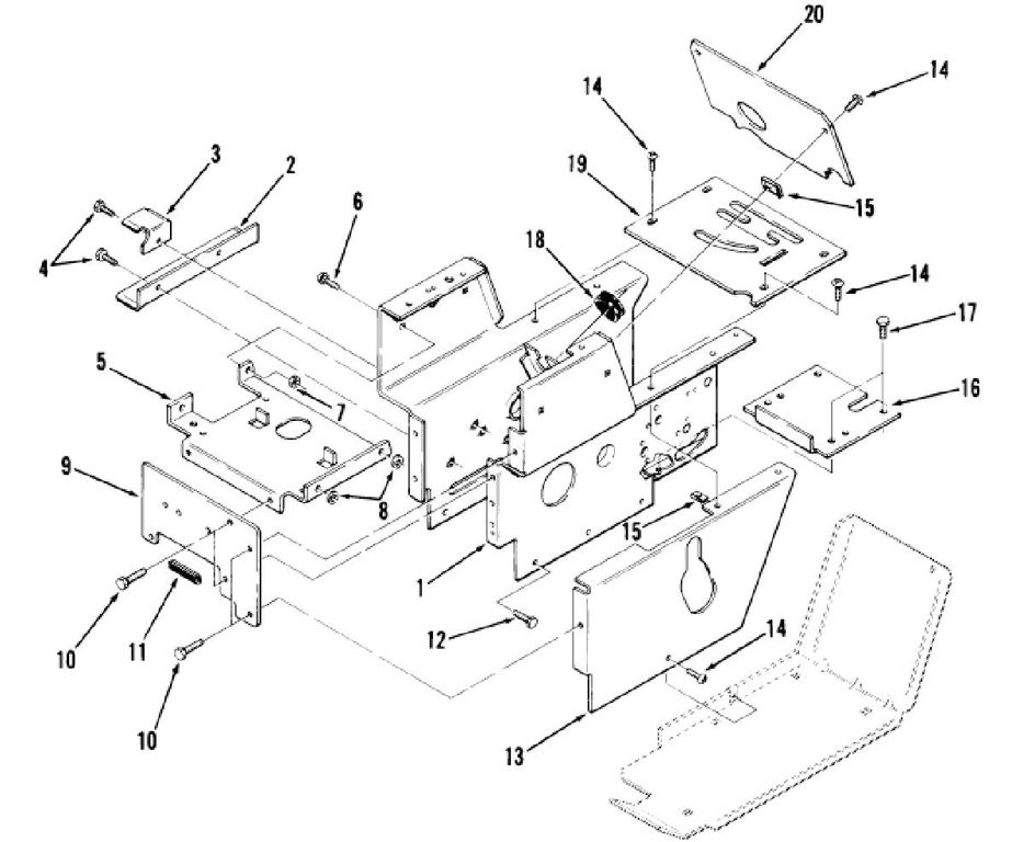

T-Mo-(Moderator) 4,928 #1 Posted March 20, 2017 The manuals mostly show the part number, but not the size of the bolts used to mount the shifter covers/plates to the tractor. I think they're 1/4 x 20, but not sure, nor am I'm sure of the lengths. Item 14 on the image. I may go by the hardware store on the way home and pick some up. Share this post Link to post Share on other sites
pfrederi 21,138 #2 Posted March 20, 2017 (edited) 1/4 20 x 1/2 inch work. i tend to use flange head versions they are less like likely to loosen up (I use 5/8" long) Edited March 20, 2017 by pfrederi 5 Share this post Link to post Share on other sites
T-Mo-(Moderator) 4,928 #3 Posted March 20, 2017 24 minutes ago, pfrederi said: 1/4 20 x 1/2 inch work. i tend to use flange head versions they are less like likely to loosen up (I use 5/8" long) Thanks, a bunch. I appreciate it. Share this post Link to post Share on other sites

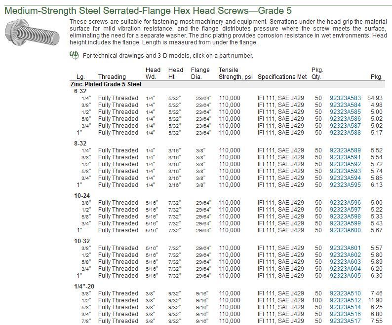

WHX?? 58,046 #4 Posted March 20, 2017 What vendor was that from Paul? Grade 5 all right look at the strength of those things! Share this post Link to post Share on other sites
pfrederi 21,138 #5 Posted March 20, 2017 3 minutes ago, WHX9 said: What vendor was that from Paul? Grade 5 all right look at the strength of those things! McMaster I use 1/4 and 5/16 serrated heads for just about all the sheetmetal connections 2 Share this post Link to post Share on other sites
953 nut 69,089 #6 Posted March 20, 2017 I purchased a box of them (3/4") on a while back, about $8 shipped. Share this post Link to post Share on other sites
WHX?? 58,046 #7 Posted March 20, 2017 (edited) Might want to get some of those #15 clip nuts right away Terry, mine have a way of rusting up. Edited March 20, 2017 by WHX9 Share this post Link to post Share on other sites
TDF5G 2,074 #8 Posted March 20, 2017 (edited) My C-121 has those screws. Phillips head. The parts manual shows 1/4-20 x 5/8 for item 14. Part no.910837. Edited March 20, 2017 by TDF5G Share this post Link to post Share on other sites
roadapples 6,987 #9 Posted March 20, 2017 The older ones have 1/4-20 with a 3/8 head instead of 7/16... 1 Share this post Link to post Share on other sites
RJ Hamner 1,029 #10 Posted March 20, 2017 3 hours ago, TDF5G said: My C-121 has those screws. Phillips head. The parts manual shows 1/4-20 x 5/8 for item 14. Part no.910837. I used SS sheet metal screws on my C-121 They really stand out among all the red 1 Share this post Link to post Share on other sites
Tankman 3,528 #11 Posted March 21, 2017 22 hours ago, RJ Hamner said: I used SS sheet metal screws on my C-121 They really stand out among all the red I too use the SS Phillips head screws; 1/4-20 x 1/2 or whatever. Always stock at Lowes. Large flat head. Not the little screw heads. Item #15 is also stock, on the shelf at Lowes. Never-Seez on the screw threads! Because both items are inexpensive, change 'em both. Share this post Link to post Share on other sites
