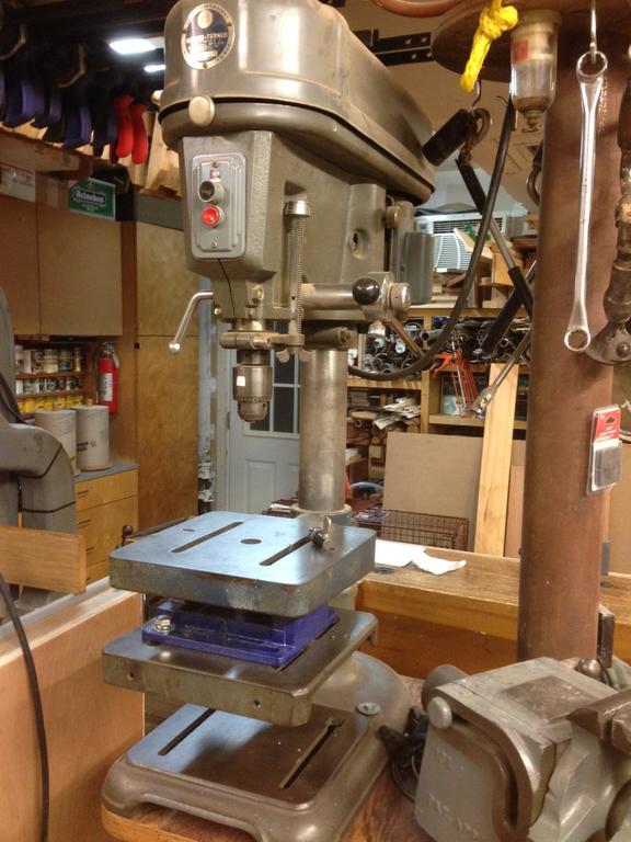

formariz 12,381 #11 Posted March 22, 2017 That is a great machine. You will not be disappointed. Here is mine the bench version from the Walker Turner era. Takes two strong men to move it. 1 Share this post Link to post Share on other sites

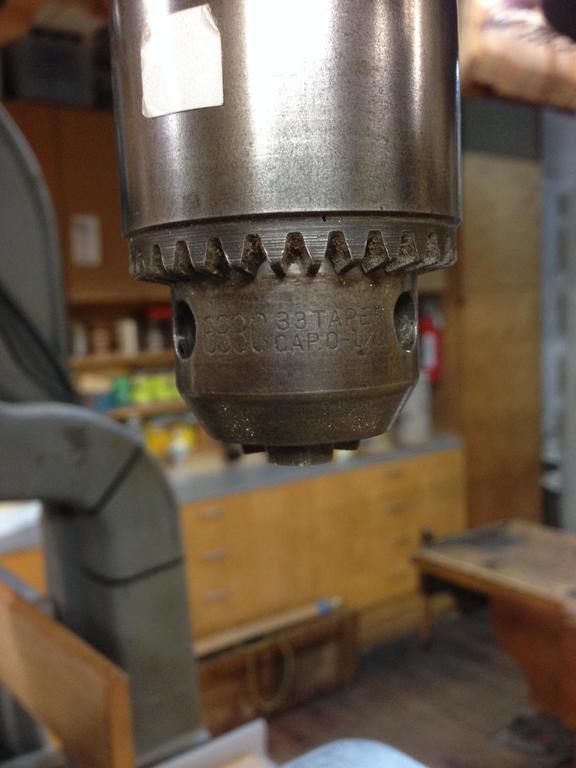

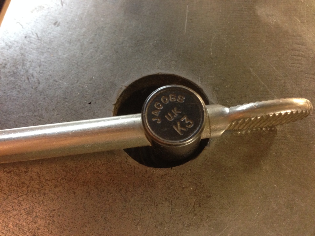

Duramax7man7 506 #12 Posted March 22, 2017 (edited) Nice! That's a per-dee one too! Anyway that your chuck key has a number on it or anything? Looking to order one this week. How would I go about doing that? Measure the diameter of the hole and then the amount of teeth on the chuck itself? By the way, last night a got to fiddling with it checking for the source of the noise and it was mainly a combination of the loose hood springs and the tension set screw wasn't tightened. So I reset the spring gap and tightened down the hood as well as set a good tension on the belt and made sure the set screw was tight and that did a lot. No more loud humming and vibrating. She's still got a little noise to her but it's way more tolerable now. Might end up replacing the bearings sooner later. They don't sound like they are grinding, badly worn or anything. Just a bit dry. Not completely though. I tried to give the pulley's a good shake with the belt off and they weren't bad at all for a 1970's machine. Edited March 22, 2017 by Mastiffman Share this post Link to post Share on other sites
formariz 12,381 #13 Posted March 22, 2017 (edited) You should have a Jacobs 1/2" chuck with a 33 taper. Should be marked. Should then be a K3 key. Noise is the reason why most of these drill presses no longer have the cover. Regardless of constant fudging with them They are always making a racket sooner or later. People just take them off and wind up loosing them. Edited March 22, 2017 by formariz Share this post Link to post Share on other sites
