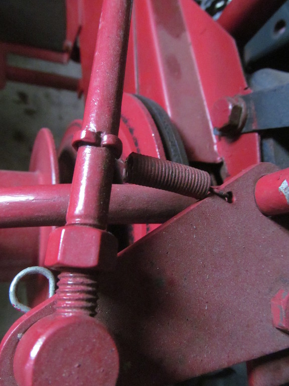

gwest_ca-(File Mod) 12,461 #4 Posted March 19, 2017 If the pto clutch engagement lever kicks off the clutch is slipping. Shorten up the link between the lever and the clutch a few turns. The lever should snap down with some authority when you apply it. If you still hear a squeal when under load it is still slipping. Give it another turn. Garry 5 Share this post Link to post Share on other sites

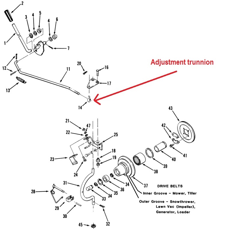

wallfish 20,511 #11 Posted March 19, 2017 Sounds like it needs adjusting. Below is the PTO assembly drawing so take a look and compare it to your tractor's parts. Make sure the spring is connected too 1 Share this post Link to post Share on other sites

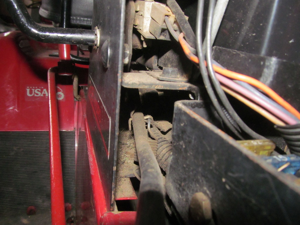

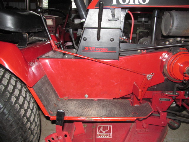

Ed Kennell 47,022 #12 Posted March 19, 2017 I just realized the PTOs on my 520 and 312 do not have a spring at the front like the C -160. The 312 and 520 have a spring at the rear near the engagement lever. C-160 spring in front near the PTO 312 and 520 spring is under the battery. Share this post Link to post Share on other sites

jcndtown 10 #17 Posted March 19, 2017 Well guys thank you once more for the advice. I went out this afternoon and tried to engage the PTO after replacing the gear box with new oil. As soon as I put the lever down it sprung back up. Per what some of you advised I adjusted the trunnion a couple of turns and now the lever is staying engaged when running. Most of the snow is now melted but I had a spot next to my garage which I had to shovel by hand and hence a mound still of about two feet with some wetness to it. I put it in low and raised and moved into it with the housing lifted to get to the top portion and it did not clog and for the most part through the snow pretty good. Dropped the housing to normal and the belt did stop once but the PTO lever did not kick back. Put in reverse to back out of the snow pile and the snow cleared without my help. So not sure if it is correctly adjusted but is certainly working in this test far better then what it had been. Will still work on lubricating the rest of the tractor but for now it looks a whole lot better! Thank you all who responded once again. Jeff 4 Share this post Link to post Share on other sites

gwest_ca-(File Mod) 12,461 #19 Posted March 20, 2017 The fact the belt did stop once indicates the pto is not adjusted tight enough if the pto pulley also stopped. When everything stops the clutch is slipping and wearing the friction surface real fast and that surface is not very thick. My guess is it will need at least 2 more turns of the trunnion. One turn to stop the slipping and a second turn to make sure it does not slip. Garry 2 Share this post Link to post Share on other sites

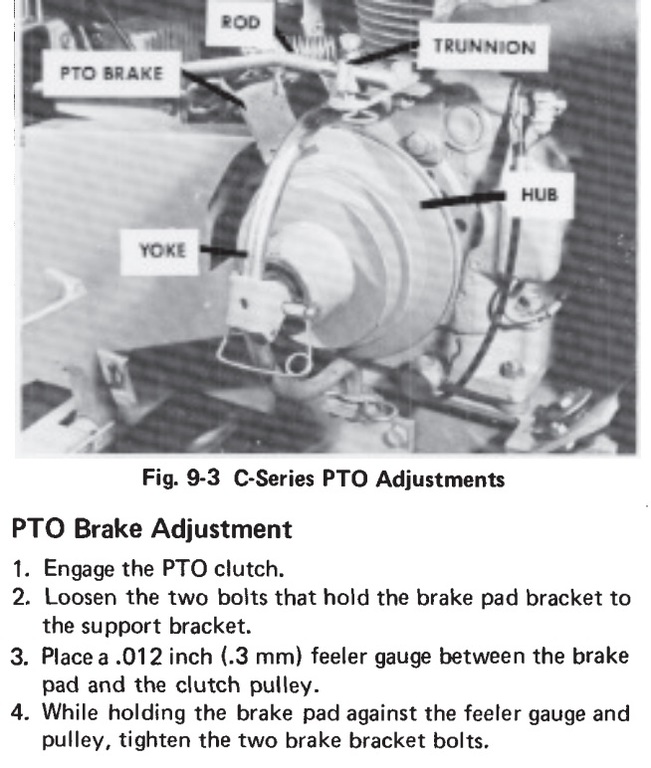

Ed Kennell 47,022 #21 Posted March 21, 2017 First you should get the pressure correct on the PTO clutch so the clutch does not slip. Then if you want the PTO to stop, you must adjust the brake. You can see it here above the PTO bell. It is a small padded brake that stops the PTO from turning when it is disengaged. 1 Share this post Link to post Share on other sites
gwest_ca-(File Mod) 12,461 #22 Posted March 22, 2017 This is done with the engine not running. A business card is a suitable gauge. Garry 2 Share this post Link to post Share on other sites
jcndtown 10 #23 Posted March 26, 2017 Thanks again for the advice and instructions. I adjusted the PTO again and found that the brake was about 1/8" away when the the lever was disengaged. Adjusted it according to the directions above and now all seems to be working a whole lot better. Confident now that I do not have to look for an alternative for snow clearing and will add accessories to the tractor as I find them. Jeff~ 2 Share this post Link to post Share on other sites
