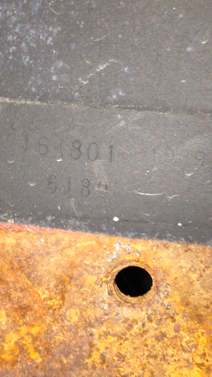

Budenmack 5 #1 Posted March 18, 2017 This is my first time posting and I was wondering if anyone can help me identify a wheel horse I just got . I put a picture of the tag below. It has 3 numbers 16k801, 1989, and 6189. Share this post Link to post Share on other sites

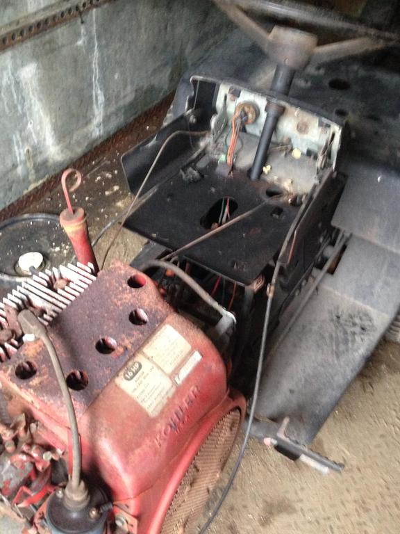

prondzy 3,889 #2 Posted March 18, 2017 Post a pic of the whole tractor it will make things easier Share this post Link to post Share on other sites
Ed Kennell 45,729 #3 Posted March 18, 2017 Pictures would help. Could be a 1989 400 series with a 16HP M16S Kohler and 8 speed gear drive transmission. Model # 416-8 to the Share this post Link to post Share on other sites
BOB ELLISON 2,983 #4 Posted March 18, 2017 Could be a 1980 c165-8 but as other have stated need pictures. Share this post Link to post Share on other sites
Racinbob 12,896 #5 Posted March 18, 2017 16k801 was used on 16hp 8 speeds in 76-80 and a couple after that. We definitely need pictures to narrow it down. Share this post Link to post Share on other sites
Budenmack 5 #6 Posted March 18, 2017 Thanks when I get home in a couple of hours get some pictures Share this post Link to post Share on other sites
gwest_ca-(File Mod) 12,146 #7 Posted March 18, 2017 The 1977 model production started very early in 1976. Just a best guess. Garry 1 Share this post Link to post Share on other sites

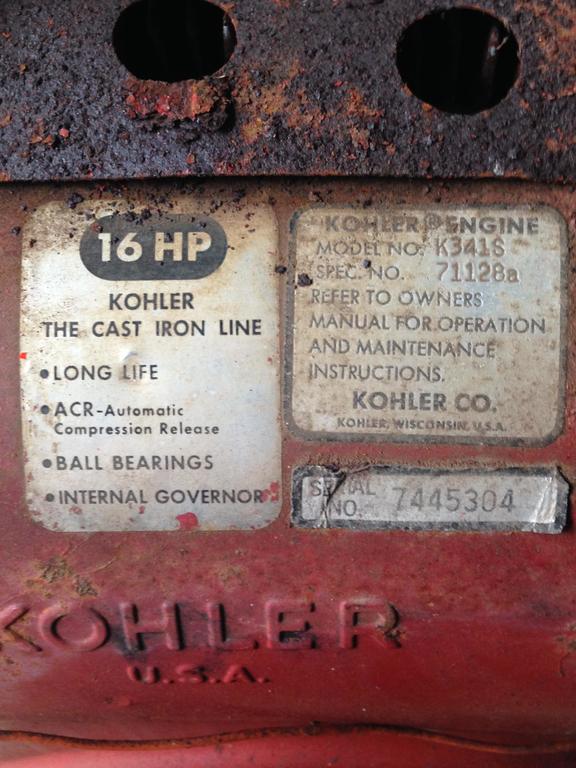

Ed Kennell 45,729 #11 Posted March 18, 2017 (edited) 7445304 is a 1976 Kohler engine serial number.. Garry nailed it, Edited March 18, 2017 by Ed Kennell 2 Share this post Link to post Share on other sites
Budenmack 5 #12 Posted March 18, 2017 Thanks for all the help! 1 Share this post Link to post Share on other sites
gwest_ca-(File Mod) 12,146 #13 Posted March 18, 2017 More Just noticed the difference between the 71-16K801 and 71-16K802 is the Kohler engine spec. number used so this parts list could be used with caution. Garry 2 Share this post Link to post Share on other sites
